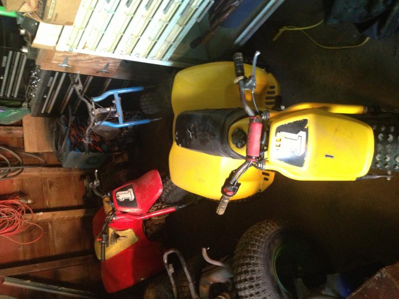

I've got two LT 80's and both OEM cylinders need bored. Not really doing much with them right now. More than likely will build 1 out of the two machines. Nephews are too young for them now. Just keep an eye out for a good deal on stuff for the future. Just picked up zinger 3 for the youngest last Sunday. Younger 2 are still to young for those. Found a used front fender for the blue one. They're getting fresh paint now. Just made a big order of parts for those. All I need to find is 6 new or nice used tires(having trouble). Rest is in the mail. Decal kits, seat covers, oem grips for the yellow one, air filters, 1 used airbox, and 2 of the milossi "big bore" lol! topend kits(they're supposed to be Italian made and the same price as the partsdiscounter ones. Supposed to have 3 smaller exhaust ports instead of the single one which I think is a better design(should allow for more flow).
What would I need to look out for with a Chinese knock off kit? Maybe I should order one to see what's to it. That's dirt cheap.
Ps: Here's the zingers
Will post pic when they're all finished.

Love the zingers!! Melossi is good quality stuff, I've ran their cylinders before on the drr quads. My concerns with Lt China stuff would he quality of piston. Not only for longevity but you also could drop a chunk of it into the bottom end and cause more problems than the money you have saved. Also is the cylinder sized for the piston they send you? I'm betting not, and u may need to hone to fit anyhow. I've had awesome luck with pro x pistons for the Lt so I'd buy a piston have ur stock bored and you know you'll be OK... If your cylinder was junk I could see maybe trying one out, but if it just needs bored I'd buy a piston and be done with it. While you have it apart get a banshee petcock ($15) and remove the vacume one that's on it....they do.nothing but cause problems, leak and fill bottom end full of gas. :)
