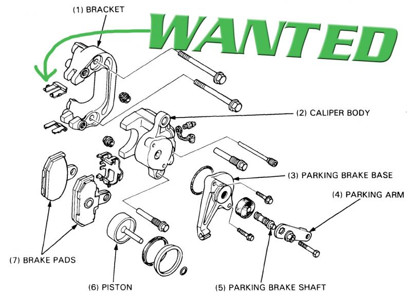

I want to buy one of the stainless steel pieces that the rear brake pad slides against. Anybody got rear brake parts for a FL350 they want to sell?

I wonder if Speedchaser can help with that viewtopic.php?t=4011
PostPosted: Sat Dec 21, 2013 3:28 am
if speed could make some, I'd buy 10.,have a couple calipers in need of them. hell I'd buy pilot ones as well to help the cause.

Scrubbing the internet now for honda 45112-VM0-006

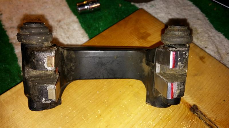

Going to try this one I made one out of a tuna can lid, an exacto knife, and my vise. It's not perfect... I will put more pictures in my Ugly FL350 build thread.

I wonder if Speedchaser can help with that viewtopic.php?t=4011" ."..
I didnt see the link before. I would definitely buy a custom one from speedchaser if there are any left.

They are easy peasy to make.
I made mine from stainless steel sheet,some scrap I had from an ol rangehood flue cover.
Thickness was comparable.Use SS for the obvious non-rust property and good wear.
The tin can won't last long,but good to practice on...reject like John West! :-)
Just take the measurements,GOOD pair of pointy snips-WISS eg,something to bend em over on. :shock:
The first one I made was good...but the 2nd was way gooder.
I also use an ol I beam cut off for my anvil.
The tabs are easy to adjust for grip.
Hardest thing is to make sure all your bends are done in the right sequence.
All my Odys are way gone,otherwise woulda take a pic for ya.Good luck...you CAN do it!!! :-)
