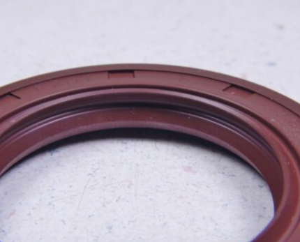

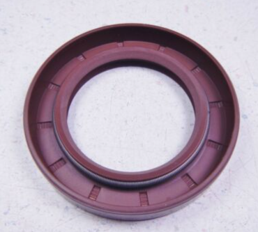

PostPosted: Thu Jun 11, 2020 10:10 am
Are you sure the junkboy seal is double spring? I only see one spring and a wiper - which is often confused as a seal. $50.00 for that seal seems like a ripoff to me. Buyer beware!

PostPosted: Thu Jun 11, 2020 7:33 pm
Posts: 1070
Yea it’s not a double spring seal. Bummer. However, it is still a very high quality seal. The inner lip is thicker, the spring is bigger and stronger, and the wiper is also thicker than an SKF single. Measuring new vs new, SKF seals measure about 0.5mm wider that this Viton seal; so it is going to run tighter. Viton also should last longer and has higher heat rating than the SKF.
At this point I have no other choice. I must go with this Viton seal as it’s my only best option.

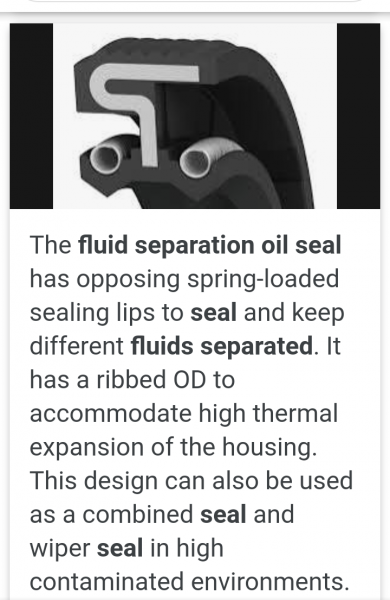

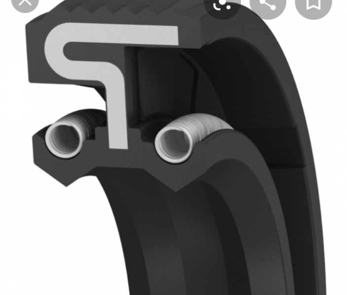

Here is what we need it's a cut away showing the two springs.

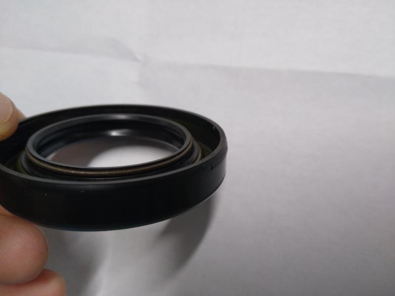

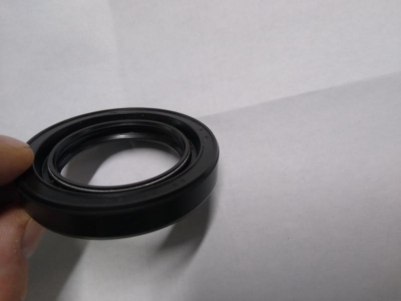

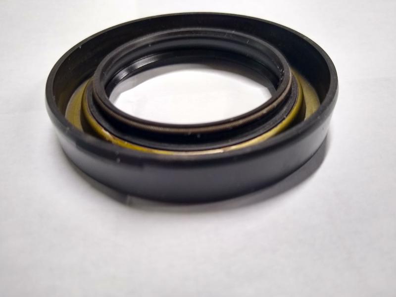

PostPosted: Fri Aug 28, 2020 6:36 pm

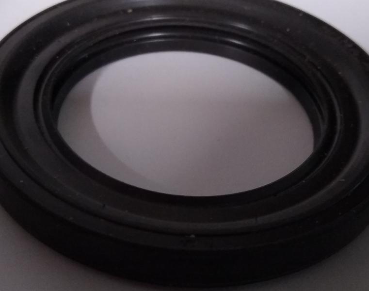

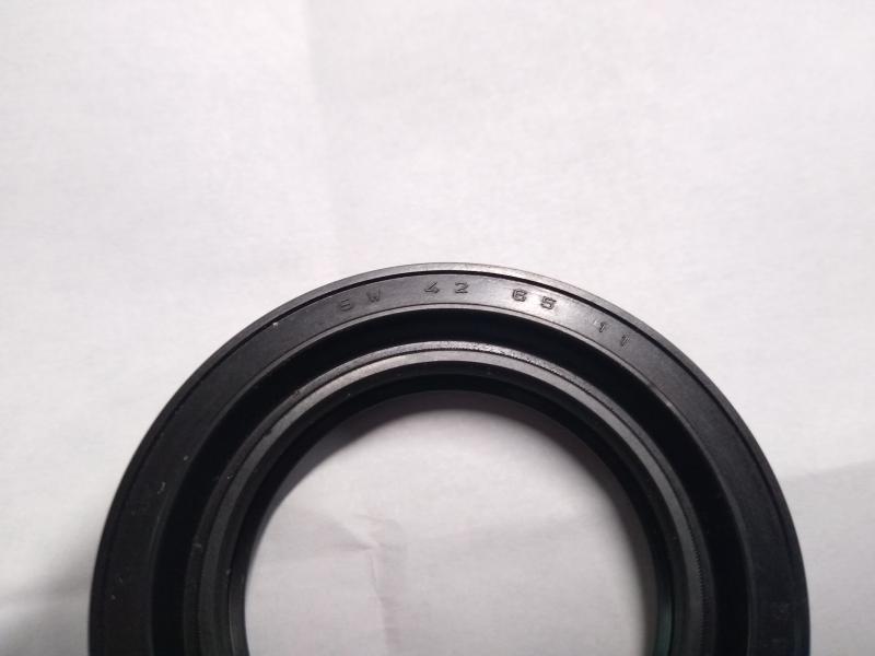

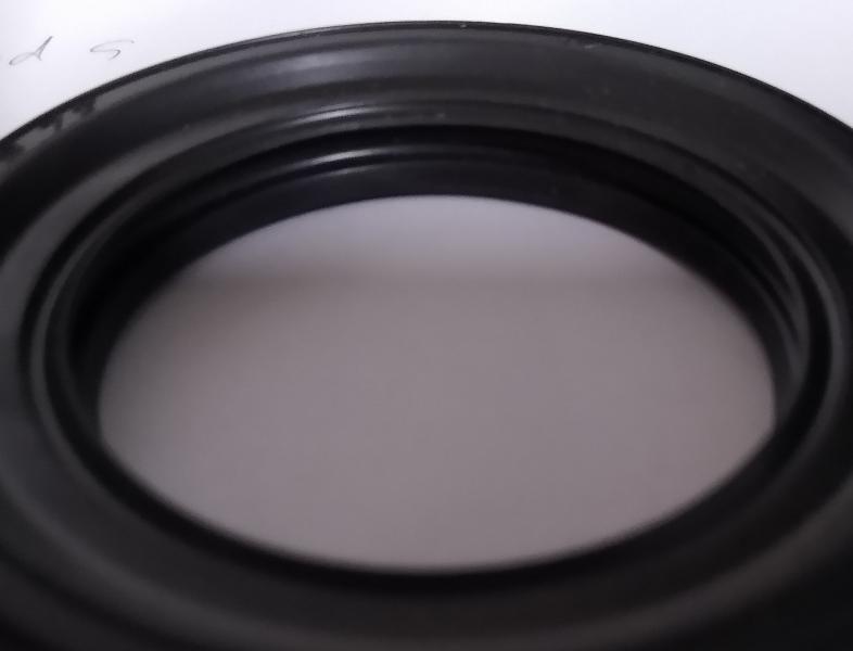

Pics of stock seal
PostPosted: Fri Aug 28, 2020 6:48 pm
If you look at the pic of would would be the new seal. It has a ribbed sealing on the OD. The stock is smooth.
Any options on this?
I told the MFG to use a shift speed of 8500, Engine oil on one side and an air fuel mix on the other. It will be used as a two stroke Engine main seal.
PostPosted: Fri Aug 28, 2020 7:55 pm
that looks thick enough that you could possible use 2 single lip seals back to back.

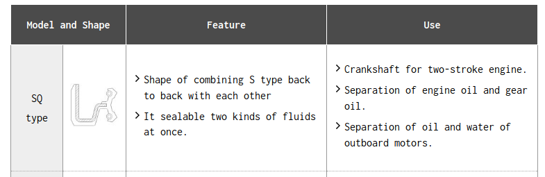

Hint? Special Shape Oil Seals http://www.arai-net.com/english/products/oil-seal.html

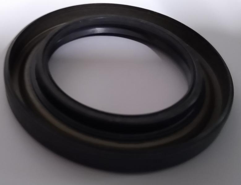

PostPosted: Thu Sep 03, 2020 12:47 pm

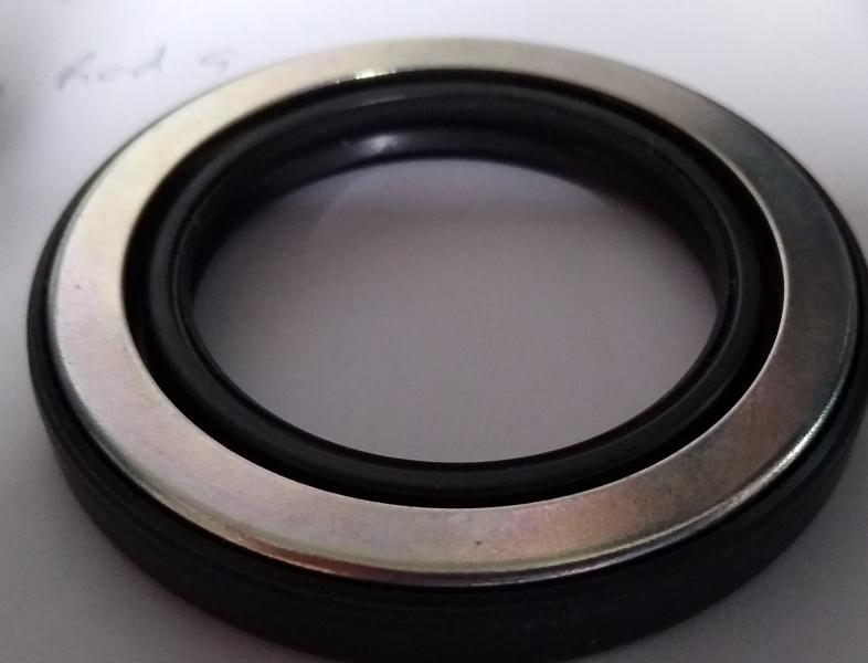

"H" I have two suzuki fork seals that are the right size. There are you describe. I use them or did for back up seals.
The metal ring can be removed.
