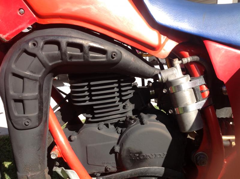

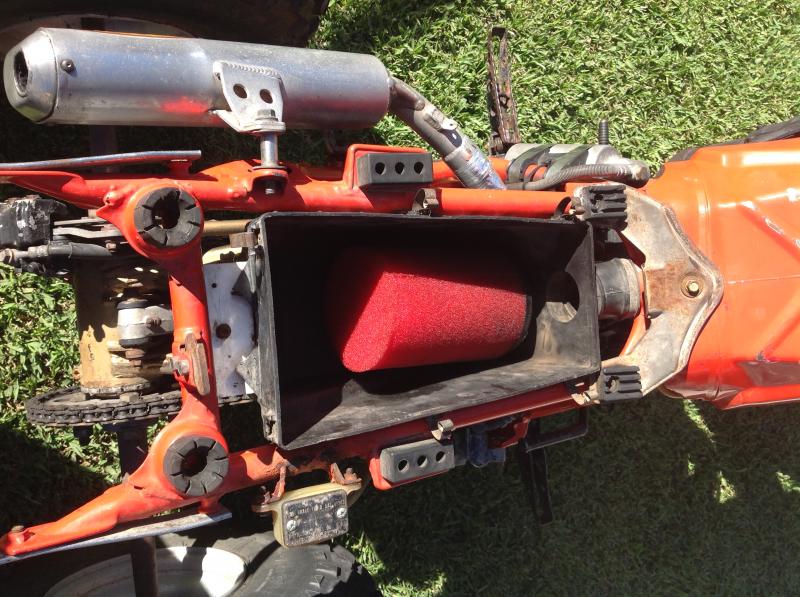

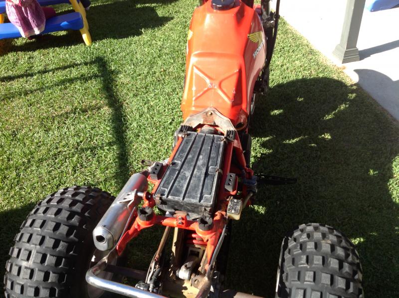

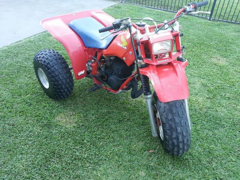

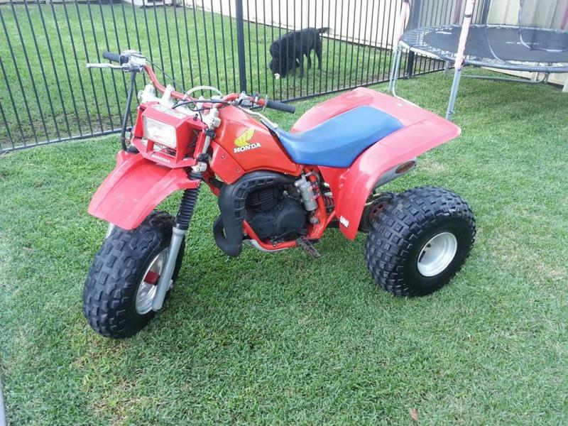

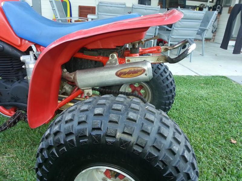

Hey guys, I found this trike for sale at what I believe is a good price, but, I need some tips from owners of these on what to watch out for.

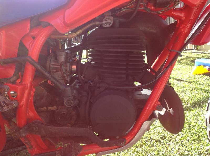

its either a 83 or 84 and it looks like a krylon rebuild to me.
it has a 86 headlight and front fender.
mostly stock besides the FMF silencer.
OEM plastic adds lots of value to an ATC, aftermarket subrtacts lots of value

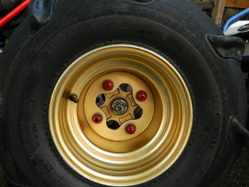

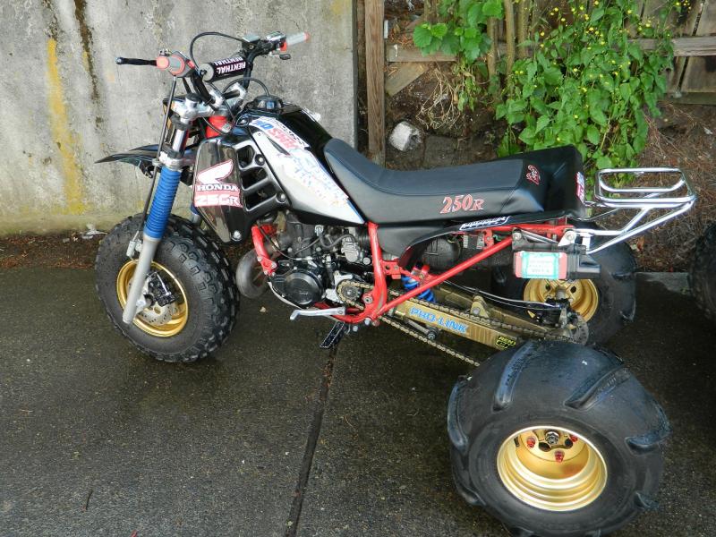

Are the wheels stock?
I thought they were supposed to be gold?
Are the front light and fender still available as NOS or even good 2nd hand?
PostPosted: Mon Jun 09, 2014 9:07 am
Rims are suppose to be gold, rear grab bar looks like its mangled up.

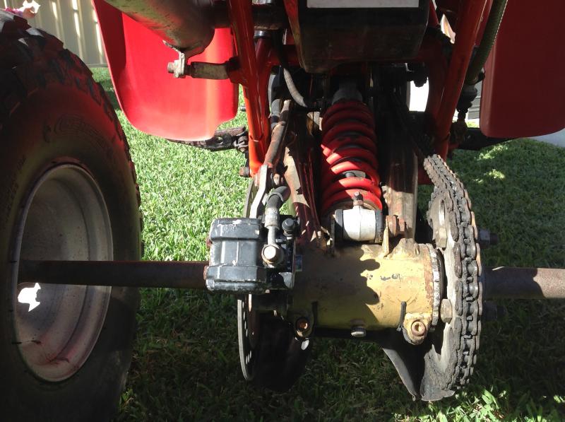

Check to see how worn out the kick starter is where it folds up when its folded out where you can kick it to start it will be beyond square with the machine and make it hard to start.
Stand behind the rear axle put one hand on each rear tire try rolling one tire forward one back keep swapping the rotation your checking for bad wheel bearings and worn axle splines look close what might look like bad axle bearings might actually be clearance between the inner bearing race and the axle itself, also watch the swing-arm pivot bolt for movement.
Lock up the front brake try to roll the trike forward and back check for bad bearings in the steering stem.
Look hard at the forks from the side view see if they look bent.
Start the Engine and put your hand over the exhaust pipe listen for piston slap or knocking in the Engine.
Check the tank for rust and stale gas.
Check compression.
Look in oil fill hole see if you can see the condition of the clutch plates and the wear on the clutch basket I forget if you can see it.

The guy seemed fairly honest and has advised that he's changed gearbox oil twice just to keep it clean and that it was clean when he first drained it. Unlike my FL350 that was silver and since changing it twice, it has remained clean and clear, but, I will be rebuilding the tranny soon.
He painted the Engine for the sale as he thought it looked ratty.

Can anyone tell me the difference between 84 and 85 stock rims?

PostPosted: Wed Jun 11, 2014 9:37 am
I think the 85's were 9" the older was 8" ?

PostPosted: Wed Jun 11, 2014 2:14 pm
Posts: 511
Location: Milwaukie, Oregon
Yes the 85's have 9" rims on the rear.
I see it is missing the parking brake cable and the parts that go on the caliper.

It required a full set of plastics as none were correct, Parking brake as was mentioned, original wheels, kill switch module and a full wiring loom to ensure it would work. rear part of the exhaust, grab bar, front sprocket/chain cover.
