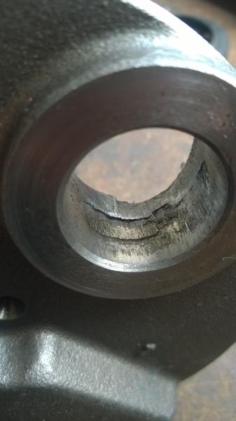

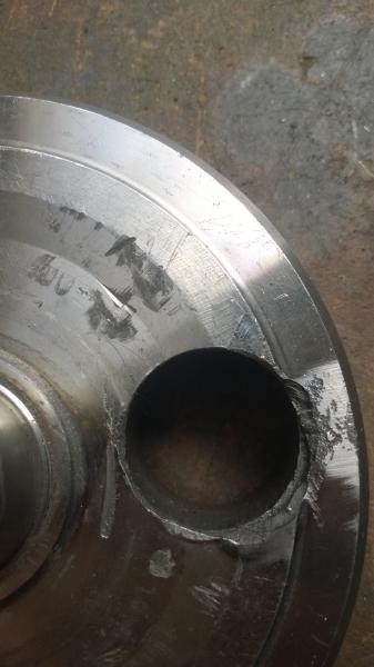

Here are some pictures. The inside (where the big-end fits in) of the both lobes is damaged. So the big-end does not fit in properly anymore, its to lose.

Looks like its been rebuilt before and it was welded and someone tried to take it apart without grinding the welds down first or they tried to press the pin all the way through the holes ?
So I wonder if a machine shop can locate where the center of the hole was then bore that hole out bigger and press in a insert to rebuild the hole, once its pressed in then weld the insert in the crank lobe on both sides, then machine it all back down as if it was stock to accept a new pin?
Like installing a sleeve in a cylinder...

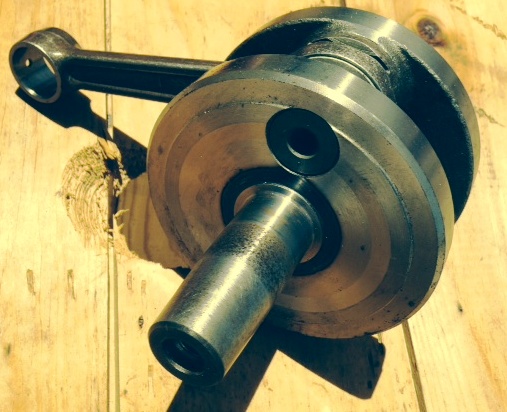

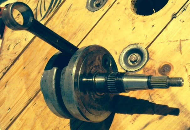

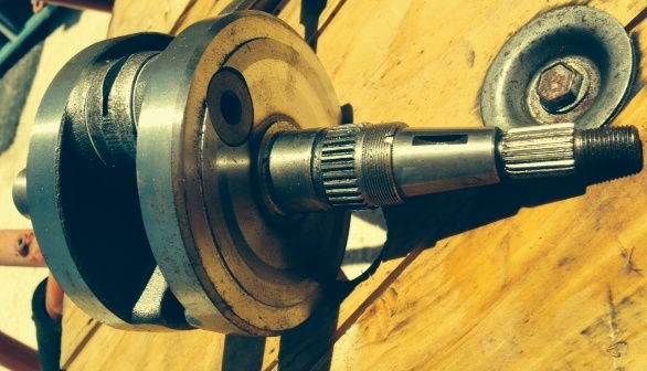

Here's pics of 2 used cranks. The guys here will point out problems .I'll have Cruz from the board look at these next week to check or flaws-he lives near me. I offer money back if not happy, but the shipping would be prohibitive if you found a problem.
