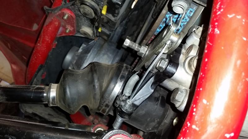

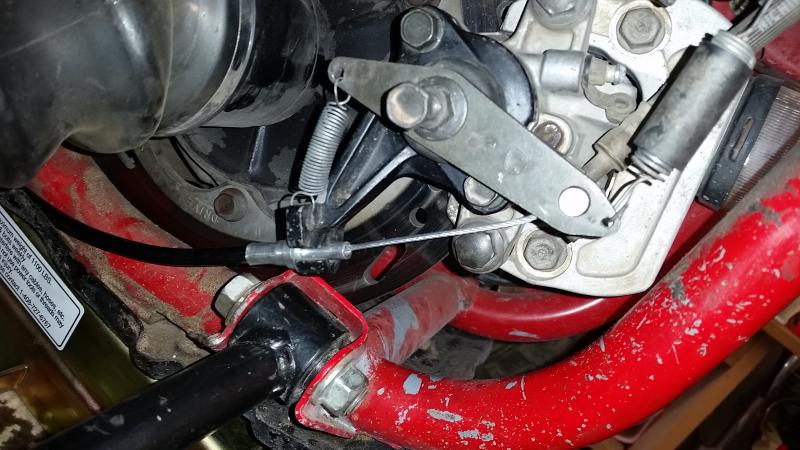

Posts: 177
ok. sorry i took forever. i got my sample parking brake cable installed. it works great. i need to talk to the company about the rubber protector to help keep the sand out as it was missing those on the ends, but other than that. it was a perfect fit.

Good to know there is an option out there. Honda made such good parts. Look at the details. The groove to hold the boot in place, the cable was centered on the eyelet on the handle end, the bushing on the pivot end that goes in the arm of the brake cylinder. Man Mr. Honda really watched the details.

i asked them about the rubber boots & below is what they told me. ill run the one i installed on my long travel pilot & ill order in a couple so i have some in stock ready to go. it looks like they will be without the rubber boots. mr. honda did things right for sure. ive always been a fan!
"Good Morning,
I just asked the cable tech about the rubber boots. He says we do not provide the boot and he suggests not using them because they actually collect the sand and dirt with moisture and can corrode the wire faster. All of our cables have a Teflon lining to prevent from debris from entering the wire."
