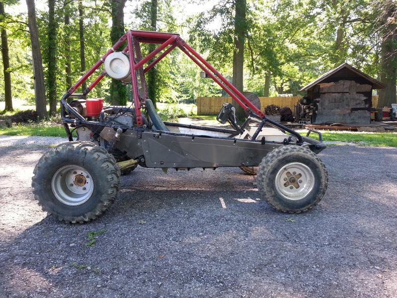

I have had some interest in the aluminum side panels I am using on my FL350 build.
viewtopic.php?f=5&t=17009&start=50
I have contacted the gentleman that I purchased them from and he said that I could share his contact info. Anyone interested can contact him at this email address:
info@CustomWaterTrailers.com
He sometimes take a little bit to respond, but he does. Everything is made to order and the side panels sell for about $130-$150. He also can make nerf bars for $195. If there is enough interest, he may give a better price for a group buy.
I have requested a aluminum hood for the FL350 but haven't received a price yet. I will update when I do.
There are obviously cheaper options for side panels but I really like the look and durability of these.

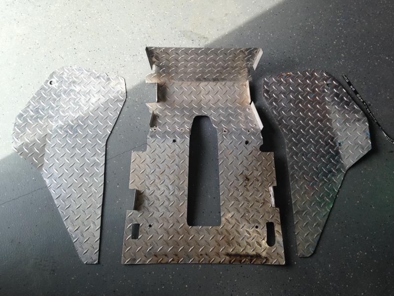

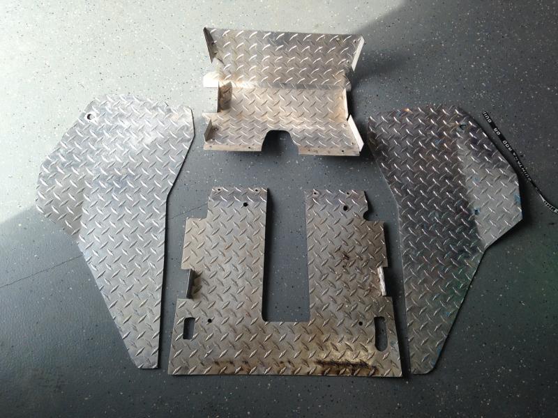

I have one that I haven't put in the oddy yet, but figured I would make another from the one I purchased. But I have his side panels already on both oddy's and would love to see what his foot tubs look like and would be willing to pay up if if easy to install and remove.
This is the one I already have, not sure if it's one of his.

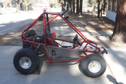

I love these panels. Fitment was great, panels seem to fit well against the frame. Built very well, deburred and edges chamfered. I asked if he could extend the panels to the front shock for a little extra. Took about 2 weeks from payment to delivery but well worth it.

Looks good. I did not read through the thread/know that much about your machine.
Is it water cooled? I don't see the scoops behind the seat or room for air flow now that the panels have been installed, this might not end well if your machine is air cooled

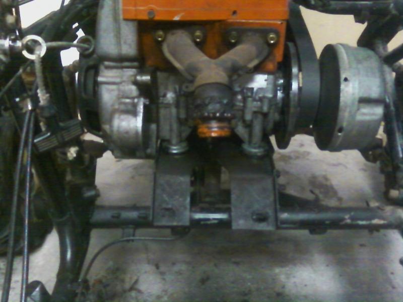

I have a 1979 Polaris Apollo 340 snowmobile Engine. It is fan cooled just behind the passenger wheel. The panel should hopefully prevent mud from slinging into the fan and get blown out the top past the heads. Its a noisey machine but runs strong for something with points and condensors (I just replaced...lol) wish It had CDI (Capacitor Discharge Ignition), or a starter, or just STOCK. I havn't had problems with it getting to hot but I don't think the panels will hurt. Here is an old pic.

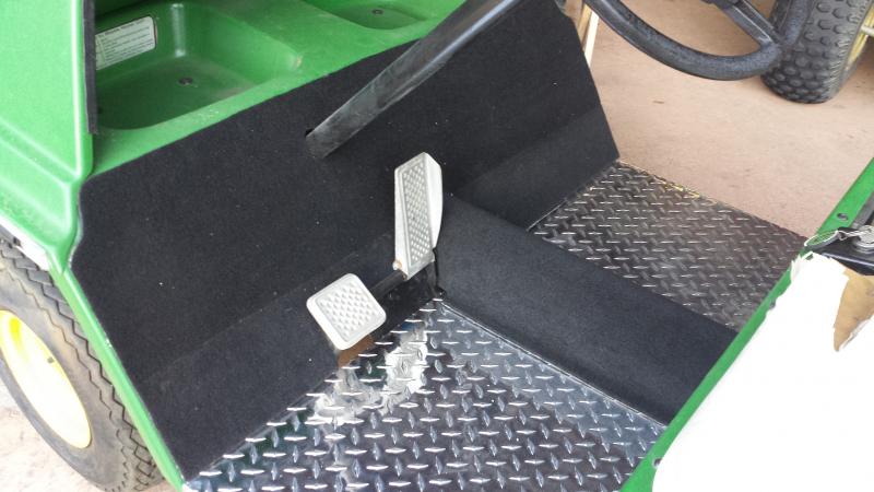

True but I've made a floor pan for an old Harley Davidson Golf Cart using an Angle grinder for the cuts. I notched the bend and used 2 pieces of 2 by 4's clamped to bend the edges straight. Cleanup was using my wheel grinder for edge fixing and polishing.
I'm just saying by looking at the finished pieces, it looks very doable.

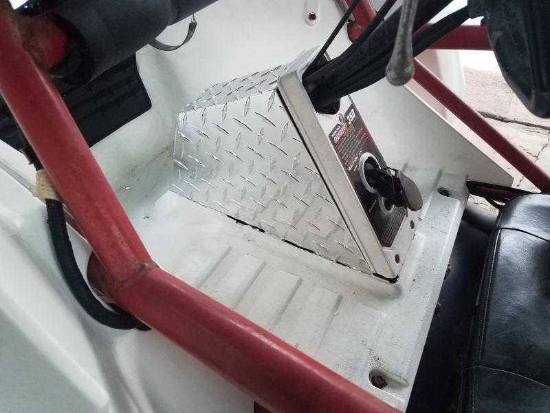

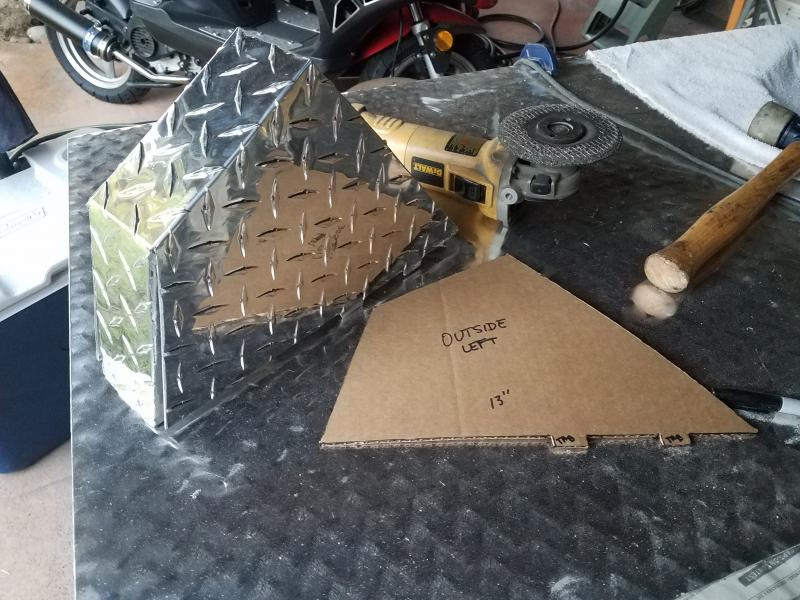

Made this missing piece out of a sheet of Diamond Plating. Just need to rivet the sides. Then make some floor plates and possibly a hood if I have more material. All done with just some cardboard templates and an Angle Cutter. Probably going to paint the pieces Gloss White to match the rest of the plastics.

Looks good, nice work!
I will be getting a aluminum sheet this weekend and will be attempting to make my own foot tub as well. I am going to try to make mine like the one MGurgone40 posted a picture of above but make it 3 pieces. 1 full floor that comes up and over the front and then 2 side pieces.

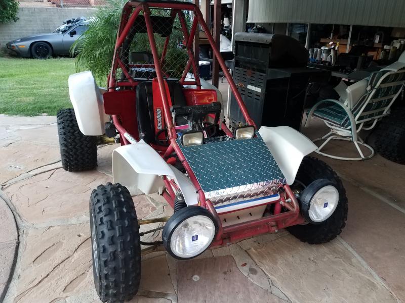

Made my tub pieces and hood yesterday.
