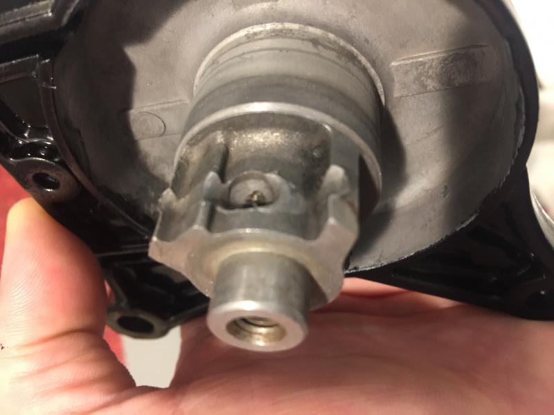

The shifter itself could be worn. As you can see in this picture the shifter grears/stops are worn.

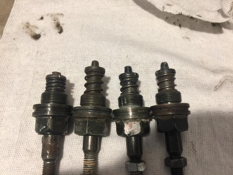

And in this picture the pull shift mechanism failed on the left 2 pieces. One the nipple is sheared right off and the other the spring stop has let go and no longer working.

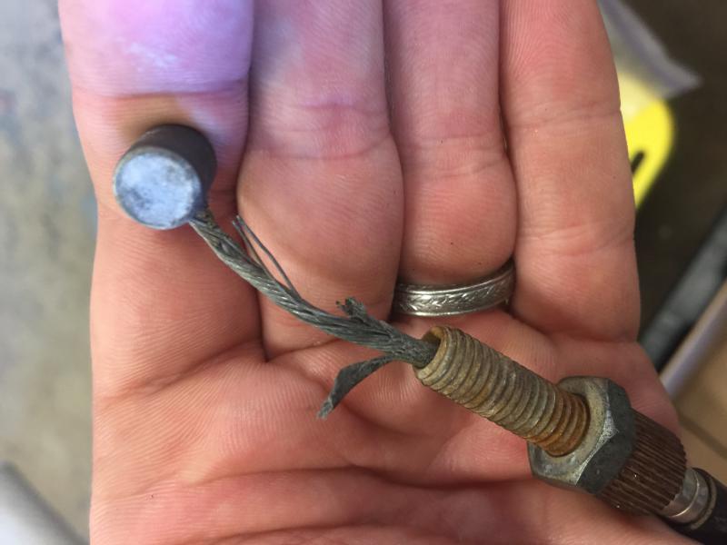

Unfortunately the frayed cable was the one that you needed, sorry bud.
