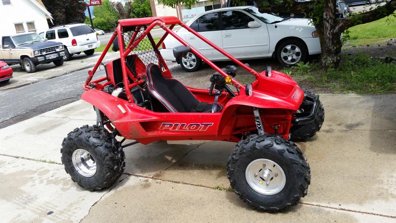

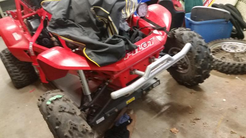

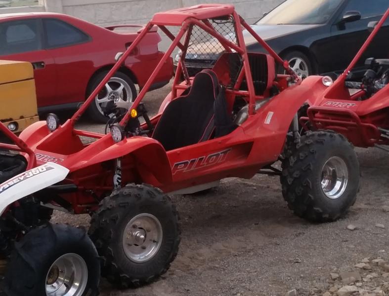

the yoda long travel machine was for sale on here before. i bought it from a member. its got a 1990 frame but its tagged by honda as a 1989 frame. everything has been taken apart & rebuilt by a pilot oddysey member. i bought it & had it shipped out to me. the motor (( Internal Combustion Engine ? )) had low compression so i had it rebuilt. i took it out driving at the dunes & it was really hard to drive and it felt like the rear end skidded around more than it turned. it has 05 trx450es front disk brakes/hubs. the main issue is that when you push down the front, i cannot get the toe set. when you push down the tires squat and turn out a bit one does it a little & the other wheel does it a lot. where its all been apart & gone through, i was going to pull it down for parts, but it has a nice set up that i think if you put the oem drum brakes back on it would fix the problem.
i have enough good machines that i don't want to try & figure this one out. ive gotten burned out on it. ill find some pix of that one. in the pictures it has a spare tank, but that was taken off and is on my machine now.

the first picture is how i got it. its pretty close to that still, but i have worked on it.

File comment: This picture is the day i got it in from the shipper & took it out for a drive.
File comment: tank is not included

The alignment issue you are having is likely bump steer. The YODA kit has quite a bit... This is the reason long travel Pilots have a "bump steer kit" 2 tie rods and 4 joints each side, setup correctly this can eliminate the toe in and out as the a arms cycle.

Just to clarify, without the bump steer kit the toe will change dramatically as the arms cycle. The pushing can likely be fixed via a arm adjustment at the frame, shock setup, rear end tracking etc. My Pilot corners as if it's on rails with the YODA kit, it's just going staright at speed and hitting a bump/dip/terrain change that can cause the bug to dart left or right. Anywho.... :-) best of luck with the sale. Also riding up here in MA my YODA A arms have taken some major hits (rocks the size of bowling balls ) they have dented and bent but straightened out without issue had held until the next massive impact.

I may be able.to.help you with your delma. You will need to make a caster change and tow change. Sounds to me you have to much caster in it and the wrong toe setting. It turns on rails due to two much caster. You should be able to move caster forward on degree at a time and maintain a toe in on bump or lessen it at least. As you do this you may need to a touch of camber to compasate for the change in caster and toe in. I bet you close or have toe out. With too much caster. As you make changes log them to go back to happy setting. With your ride height and fix shocks as you set your toe to stock it not enough. So as hits s bump you find your self memicking a turn as the tires go toe out.. to confirm this take it at ride height remove shock and cycle the suspension into bump. If you notice toe out on that tire them that is an issue resolved with more toe in. This also be lessened if you take caster out changing the amount of camber due to the caster. So start with one degree of caster removed st a time not to exceed zero. You will feel the difference in the turning once you hit optimal. Than change you camber back to where it was before caster change. Then set to factory toe in and test. Then if it turn ok go back set at ride height remove shock and check the toe change. You do not want to much toe out during bump. A little ok other than that add toe in not to exceed 3/4. Post result for others
