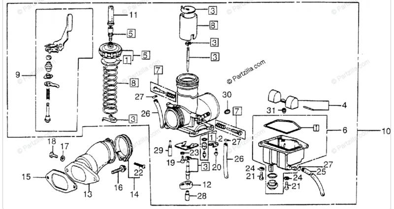

This should work.
https://www.ebay.com/itm/352984582026?h ... R4qJ5djFYg
You’re wanting part #3, right? This kit should have it.

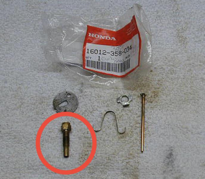

Yes #3 is the one, unfortunately none of the carb rebuild kits contain it. Thank you very much for replying though. I attached a couple photos of #3, hopefully they upload.

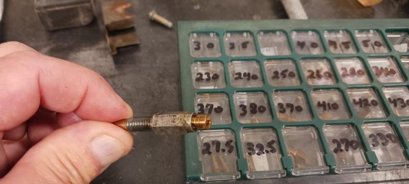

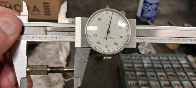

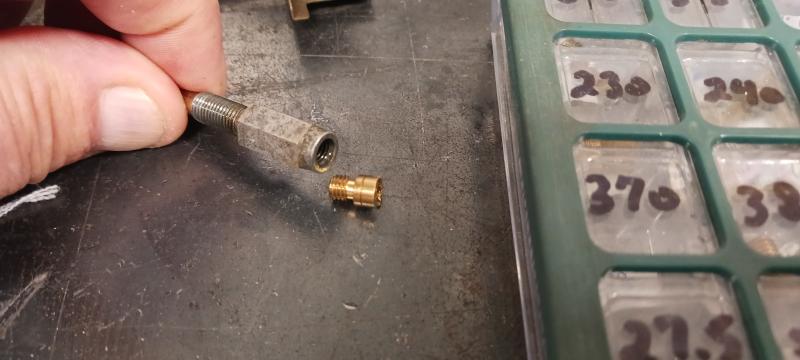

 Post subject: Re: FL250 Jet Needle
PostPosted: Fri Aug 25, 2023 4:48 pm
Here ya go: https://www.youtube.com/watch?v=RBHXcx3_qnM
The measurement I was talking about in the vid is 1.288" -- NOT -- 1.388" as I stated in the video. That's 33mm.
CO
PostPosted: Fri Aug 25, 2023 5:02 pm
Looking closer at the picture you posted I believe you might want the piece you see me unscrew from the bottom of the carb.
Let me know which one you are after.
CO

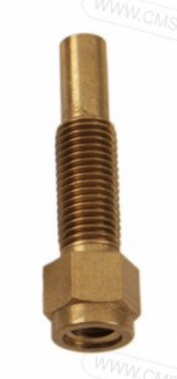

PostPosted: Fri Aug 25, 2023 5:18 pm
Joined: Thu Aug 24, 2023 11:43 pm
Posts: 5
Yes it is the piece that you unscrewed from the carb. Does it have threads on the bottom where the main jet screws in? How much would you like for it?
PostPosted: Fri Aug 25, 2023 5:37 pm
It's free.
You MUST pay the shipping though. Don't know what it is but it's such a small piece the post office won't charge much.
Yes it has threads as that is where the main jet screws into.
So just to verify we are talking the same language, the piece you want is the one you saw me unscrew in the video correct ?
On the main page of this site you can see my name as well as everyone else's that has posted recently.
Just click on my name and there will be a tab that says "PM".
That means private message.
You can send me your name and mailing address there or you can just post it here in this thread if you are ok with that.
CO
PostPosted: Fri Aug 25, 2023 5:54 pm
Also of note is that this piece only excepts the round style jets NOT the hex jets.
Round is Keihin and hex are Mukuni.
CO
