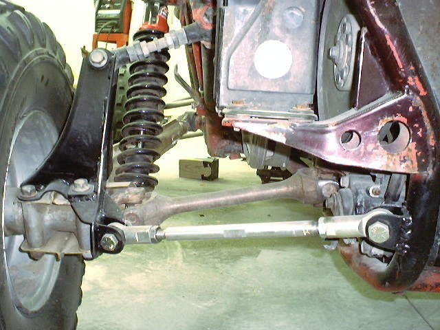

well i seen this pic and I'm thinking on doing this to my two fl350's
need shock to check for bind
thanks SpeedChaser

I am no expert but I think you need the pivot points of the link lined up with the center line of each U joint, LEE could probably help here.
SO looking at the pic you need to lengthen the mount on the frame and shorten the center link so the same length of the center section of the axle.
Yep that sound about right
thanks
speed :-) :-)
