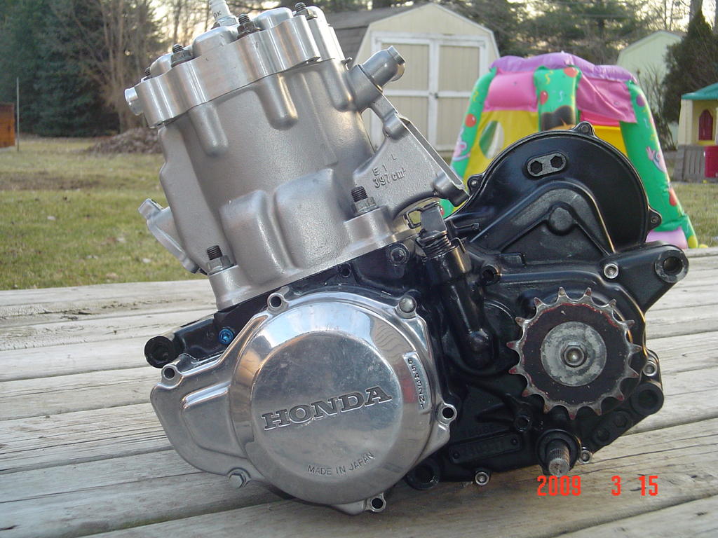

Awesome man. I was debating on goin up to 89mm bore but I wld have to change my whole setup and havent found a piston that will work w/ same pin height and pin diam w/o changing all off my port timings.
I am currently running a fl400 cylinder on my trx250r bottom end w/ a 7mm stroker crank a yz490 rod and a puma piston 85mm from calvin at cpi. What puts me at 448cc :)

Heres a couple of pics in case anyone is interested.

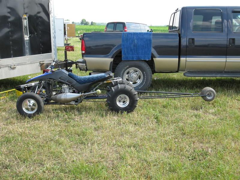

Calvin makes the piston im currently using up to 85mm $150 a pop. I have been debating punching it out and goin w/ a 500 piston just havent had the time to research which 500 piston will work w/ my rod and still have the same pin height and diameter.
The saber is nice but heck by goin this route I have less than $1100 in whole motor (( Internal Combustion Engine ? )) and im just shy of 100hp. As far as clutch side bearings goin bad I have never had any problems but then again im running this in my 250r. Strictly 300ft drags.
As far as pipe and ignition, Im running a shearer pipe w/ a cr ignition advanced all the way.
Here is a pic
