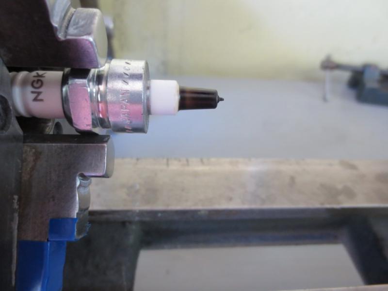

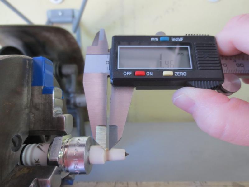

We finally are updating this. We broke in the Engine and are now working on jetting it. We are at 4500 elevation and with the 47cc coolhead dome we have a compression of 161 psi. We have the stock needle setting and stock pilot jet in the stock carb with a 135 main jet as suggested by the book for the altitude and temp of our area. We used the 90 settings because we have the 90 silencer on this pilot. The only other mods to this pilot is a 3" tube out of the airbox with an airaid prefilter and a uni in the airbox and a CR250r 4 petal read cage & stuffer with the boysen 2 stage reeds. We also had the stock 7 heat range plug in it for our first plug chop.

From the pics it looks like the plug is too hot and it is running a little lean. I want to move to an 8 heat range plug. I would like your thoughts on if I should change the main jet now before another plug chop or if I should just leave it and check it with the colder plug first.

Why do you want to change the heat range, what heat range are you running what have you been running in the past?
If your going to cut the plug apart to read it I would suggest you buy some of the less expensive standard plugs and save the fine wire plug for after the jetting :shock: Make sure your not getting fake plugs viewtopic.php?f=1&t=118
Not much color on the plug how is the Engine running if its not screaming and showing any signs of being too lean I would run it longer then read the plug and check for the heat range.

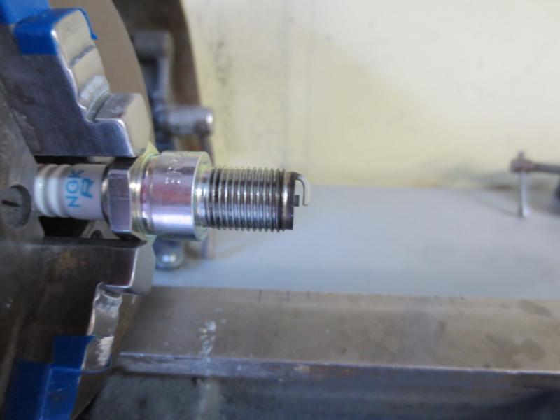

Do you have a side view pic of the ground electrode all I see is the back side .
I would have started with a 142 main jet and middle groove for the clip.

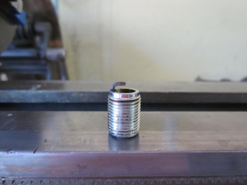

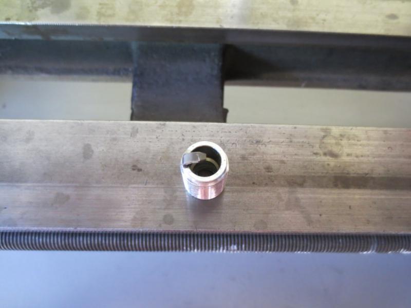

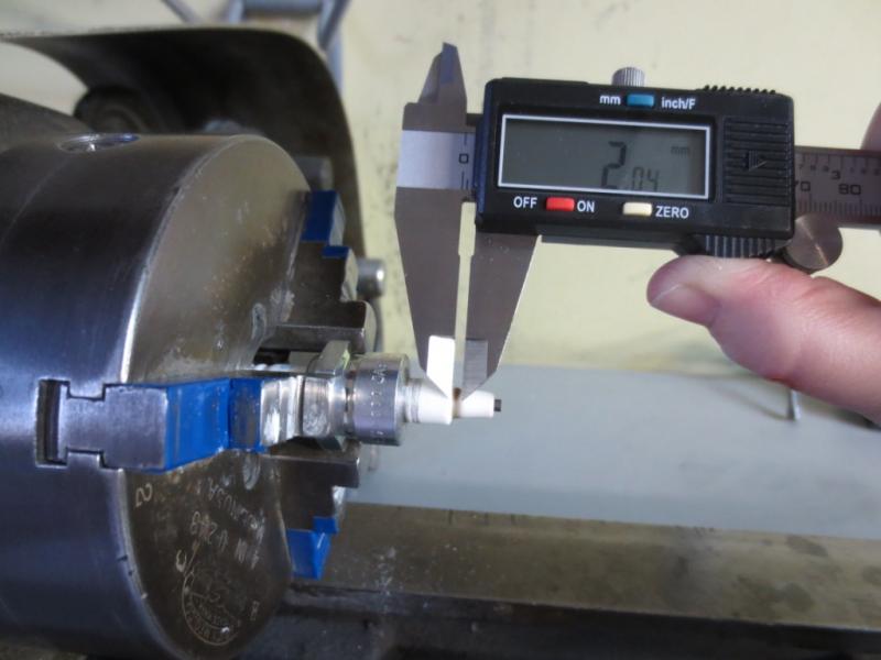

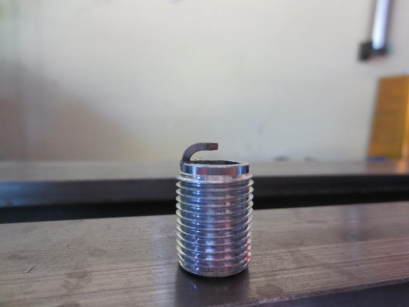

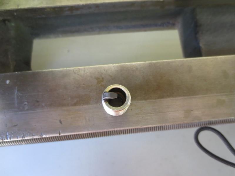

These are the pictures that you asked for.
PostPosted: Mon Sep 01, 2014 6:31 pm
Posts: 531
Location: Carson City, NV
We started with a 7 heat range plug with a 138 jet and it seemed too rich. See pics.
PostPosted: Mon Sep 01, 2014 7:36 pm
Posts: 22616
The 7 heat range plug with a 138 jet looks fat in the pics but how does it compare in run time to the second plug that is almost white, was their a bunch of idle and low speed time on the dark plug that the light plug did not see?
Their is a blond area on this plug so you can see the smoke ring width.
The taper reach on the plug makes it hard to read in pictures you can really see how far back the heat was.

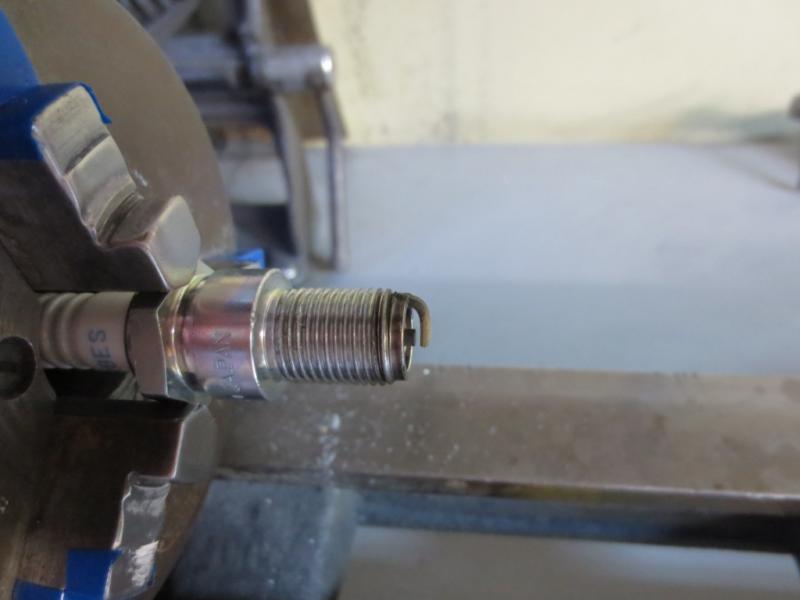

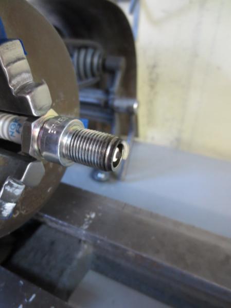

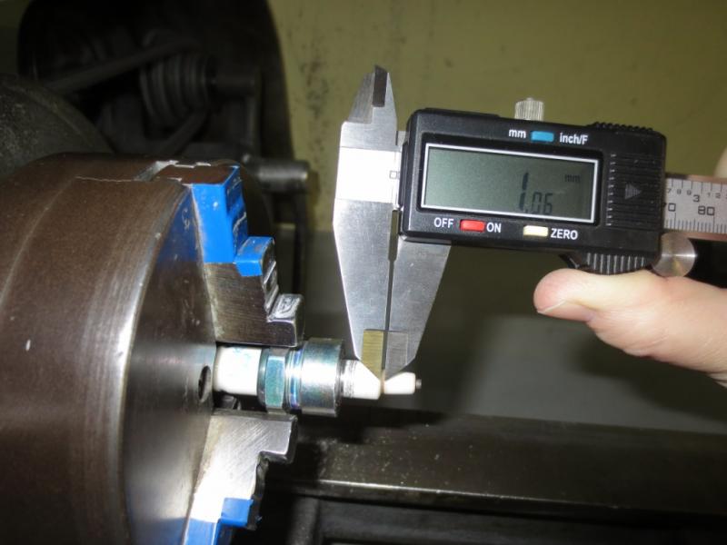

These are the plug chops with a BR7ES and a 138 main jet. 160 psi cold compression 4500 ft elevation. Temp 88f
PostPosted: Sat Sep 06, 2014 11:19 pm
Posts: 531

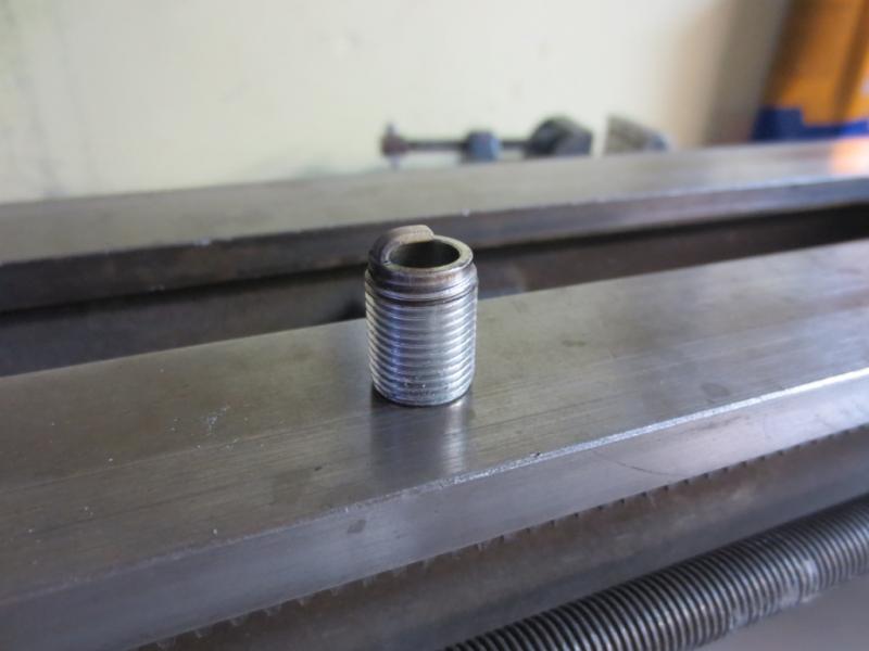

These are the pictures of the BR8ES and a 138 main jet at the same temp and elevation. I have never seen a plug chop uneven like this. Do you think it was a bad plug and that we should do it over? Later that night when it was cooled down completely it still had a compression of 160 psi.
