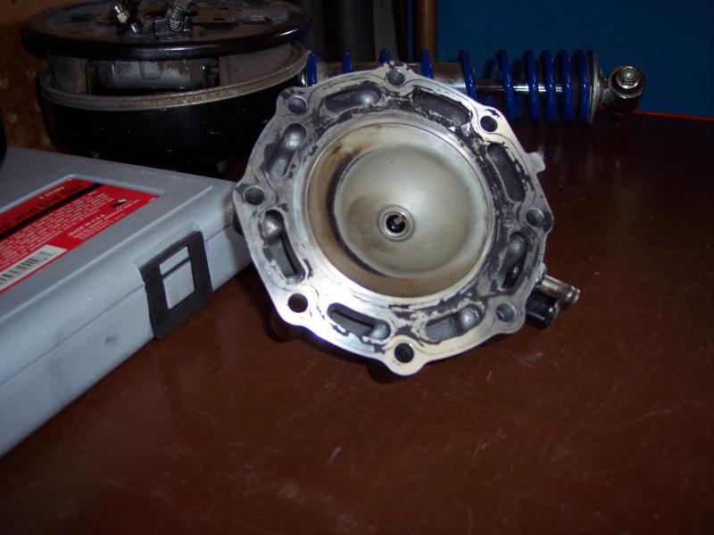

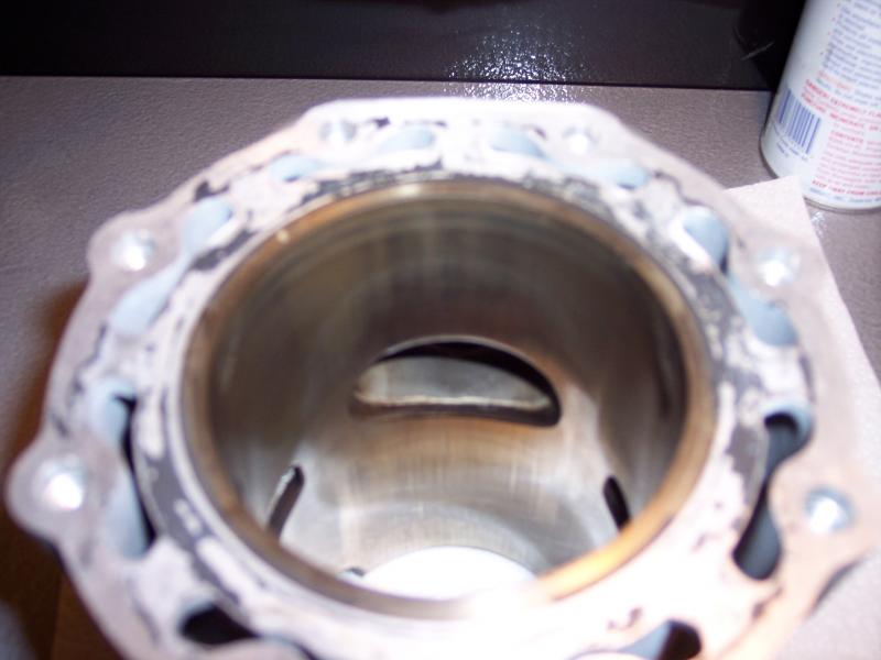

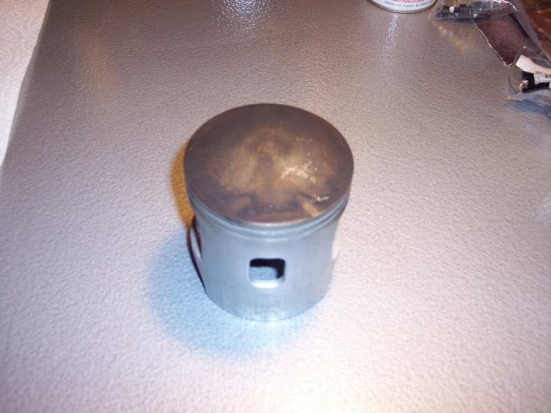

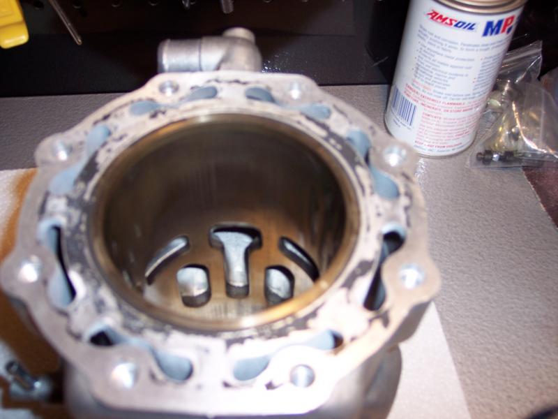

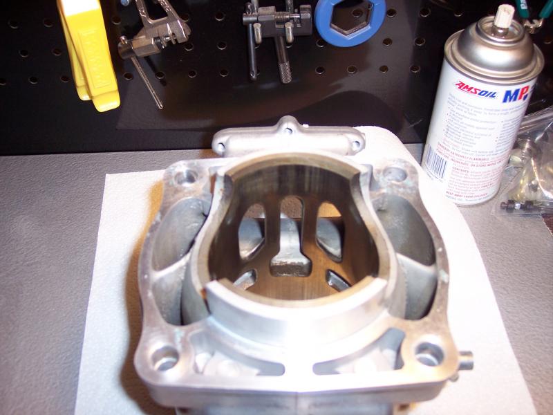

In Feb 2011 I purchased this very clean Pilot. The origional owner said it was on the origional bore (but I am sure we have all been told that before). It only had 110 psi warm compression at 4500 elevation. We only took it out for 4 weekend trips last summer because I was worried about it but it ran great. This weekend we took off the top end to do an inspection. And holey sh** it is on the origional bore. The ring end gaps were past tolerence at .030. The service limit says .028 in the book. The cylinder looked great but I do feel midway down the sleeve a mico ripple but it is not enough to change the ring gap at any point. The crank looked great no visible rust or discoloration from heat and the rod felt tight in the up and down or twist movements. The crank bearings feel good at the cluch as well with no movment up and down or side to side and it spins well but I did not remove the clutch seal to check it out because they are not avalable and everything else looks so good. I am only going to do the top end at this time. I wish all of the used vehicles that I have boght in my life were in this good of condition. Pics below.
File comment: The other side of the head gasket.

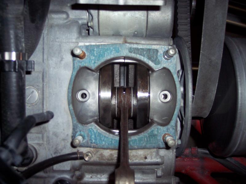

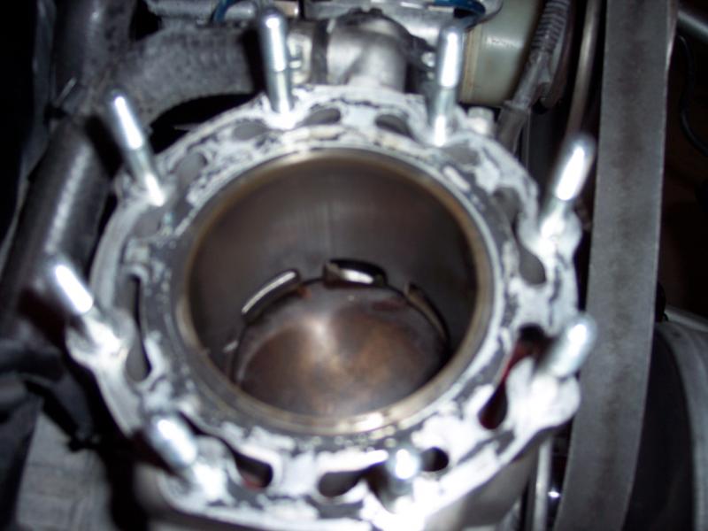

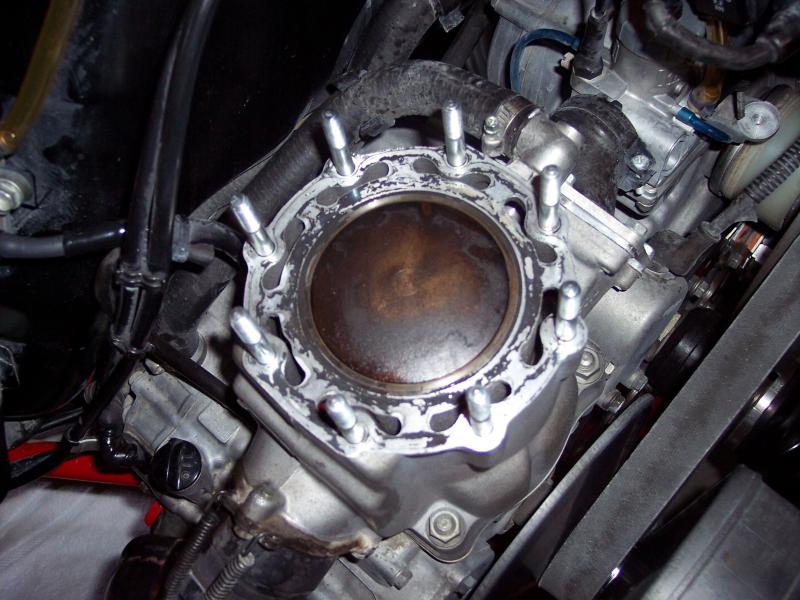

More pics.

This cylinder was marked B on the side of the reed cage area. I can still get the A Piston from Honda which is a little bit bigger and hone the cylinder to fit the bigger piston. Do you think this is a bad idea? Should I just bore it? One more question is the Honda .25 over piston bigger or smaller than the wiseco 80.5 piston?

That color cylinder gasket is usually a indication of factory gasket gaskets sold to dealers were green not blue.
I am in Florida for about another week or I would say send it to me I will hone measure the cylinder then we could see if you can use the stock bore again.
A ridged hones needs used to hone that cylinder any type of flex hone will hide any unusual wear patterns. Wear patterns examples can be found in these threads, not sure if you seen any examples in the past so here are a few
viewtopic.php?f=24&t=5479
viewtopic.php?f=30&t=2404
viewtopic.php?f=1&t=2366

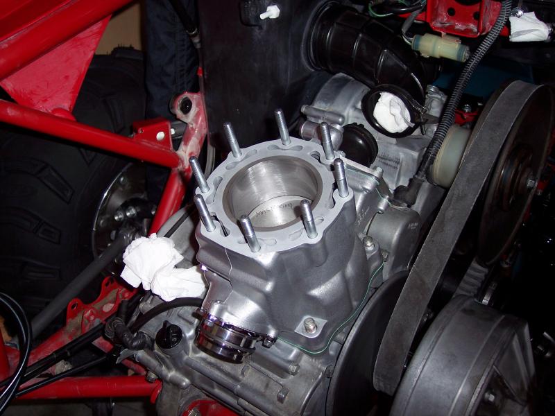

Got the cylinder back from Hoser. Very nice job. We were able to put it together today.
Last year Sommer learned how to build a 4-stroke Engine. This year she is helping with this 2-stroke top end rebuild. She was interested in learning and doing everything except the pre-lubing with the 2-stroke oil(yuck). Can you say girly-girl? And did you see how she dressed for the job?
File comment: We are teaching Sommer crisscross patterns when she torques an Engine
