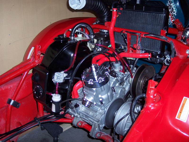

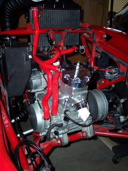

Put the cylinder and speed head on the other day. Did the leakdown test today. No leaks. :-) Then we started putting the Pilot back together. We installed the Afastcar hoses (don't they look nice). Then we got the gas tank in. We had emptied and cleaned it during the time the cylinder was with Hoser. It had no rust and just a little gunk in the bottom that we had to clean out. We also had thoroughly cleaned out the radiator and did a leak test of the cooling system today. No leaks. :-) Pics below.

Are those nuts on the cylinder studs? If they are I would remove them and reinstall the Honda nuts, hard telling how the extra mass of the tall nuts is going to react when they meet the harmonics of the running Engine, you don't need them vibrating loose or tight while out riding.

I lost the nuts that went to the cylinder so I ended up using these. I understand what you are saying about the vibration but i should not have a problem as I used high temp medium strength three bond threadlocker. I apreciate the concern though.
PostPosted: Tue May 08, 2012 1:14 am
Very nice looking machine MAS Racing. Great work. Now you need to get it dirty ::-:
