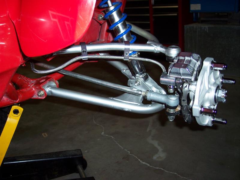

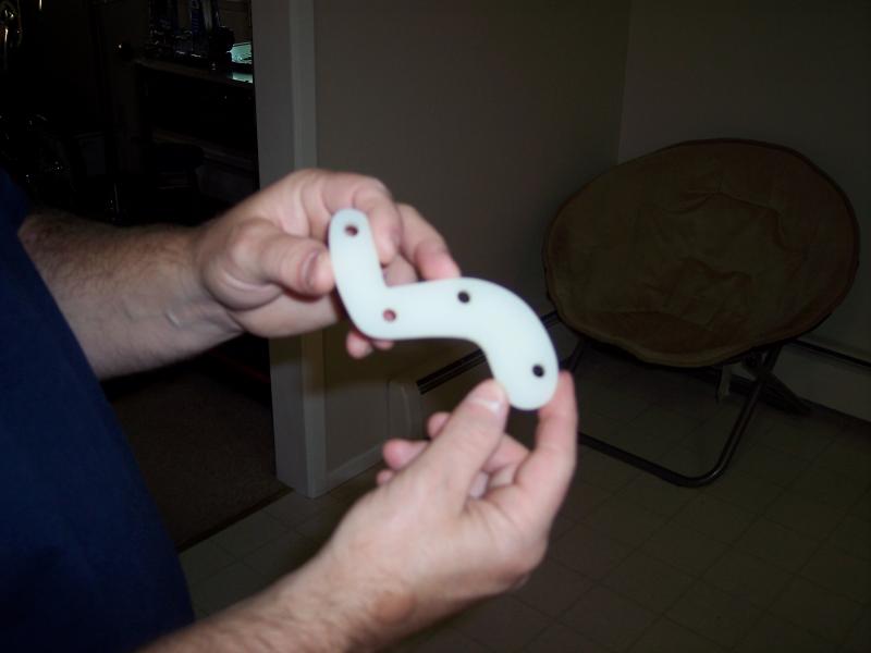

In 1998 I made a disc brake conversion for my old Pilot. I had a 97 Yamaha Banshee and I ended up using an extra set of calipers from that to do this conversion. A friend of mine had some extra hubs off of a 86 TRX 250R. I made a templet for a bracket out of 1/4" nylon to fit the caliper to the stock Pilot knuckle and machined the hub to fit the stock Pilot bearings. Unfortunatly with loosing my sight I was worried about trying to start from scratch to fab a bracket this time. Luckily my father found the origional templet in the garage junk drawer and surprised me with it when we came down to SO CAL to visit. Thank god he never throws anything out. So my wife and I went to work. I have access to a waterjet and the cut the brackets to match my templet out of 1/4" 304 stainless. It was a little bit overkill. This made it hard to drill and tap the holes but cant complain because it was free. Pics below.
File comment: The templet

File comment: Installed

Used 86-87 TRX 250 R hubs we found on ebay. Found calipers off 01-04 Yamaha Raptor 660 that were the same as Banshee on ebay as well. Fully rebuilt the calipers with all new pistons, seals etc. The rotors are tusk slotted rotor for a raptor 660 and they fit the hubs perfect. The pads are streamline HH pads for a 01-04 Raptor 660.

Like Hoser says you have to watch the rim offset. We found Ultimate Yellow Dot 10x5 4/144 4+1 offset rims form DWT.

Yes I had them machined on the inner side. The outer is the same. This was the first problem we incountered for this conversion. The person who did the machining was a little off and went in too deep. It was not that big a deal because he was only .008" off and we were able to fix it by using some metric shims inside the dust seal. You don't see them at all.

The next problem that I had was the center hub spacer was too small ID for the pilot spindle. I was able to fix this myself also. I just drilled it out a little on my lathe. I have a small jewlers lathe that I still use even blind for some aplications. I am so familiar with it that I don't need to see what I am doing I just count my steps and check sizing often.

Problem # 3. Just annoying really. With this set up you have to unbolt a sliderpin on the caliper and tilt it up to get to one of the bolts that hold the caliper on so that you can unbolt/bolt the caliper off/on. You can change the pads though without unbolting the calipers. They can be slid in form the side. So really you only need to unbolt the caliper if you want to remove the hub for any reason. It is still annoying to me though it might not bother some.

Problem #4. We were going to use the discs that came on the hubs that we won on ebay because they were almost brand new. But the bracket that was made was crated for the banshee disc origionally and it did not line up with the TRX 250 R disc that came with the hubs. They are about 1/8" larger so they rubbed on the inside of the caliper. This was not too much of a problem though because they do make discs for the banshee/raptor that fit the bolt pattern for the 86-87 hubs. The newer Honda use the three bolt pattern not the four bolt pattern that Yamaha uses.
