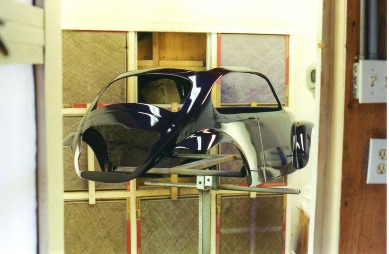

File comment: Painted it a base of black with candy purple on top.

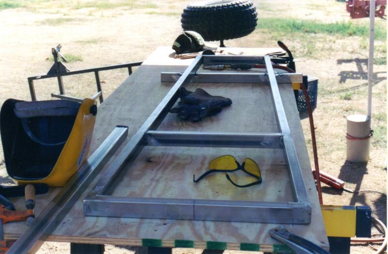

I built a frame for it out of 4130 cromolly.
File comment: Welded the basic shape of the frame.

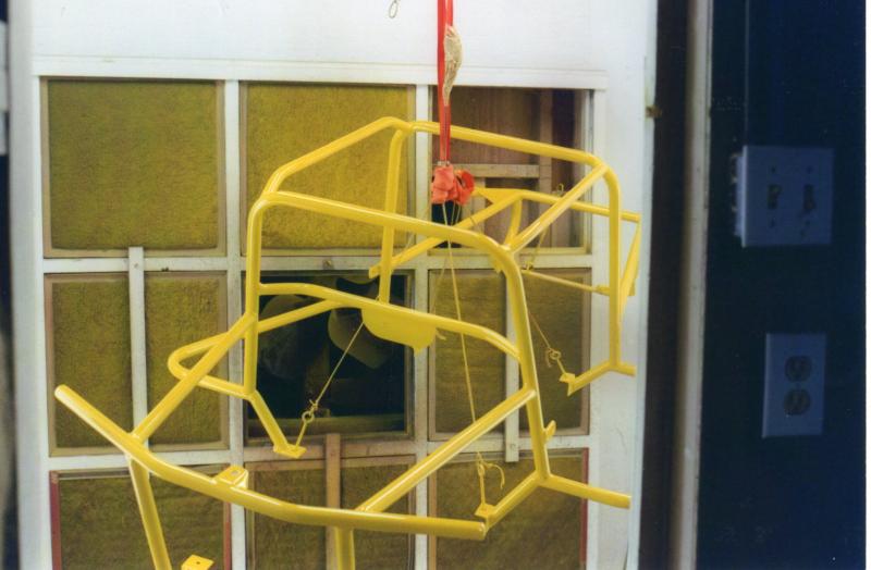

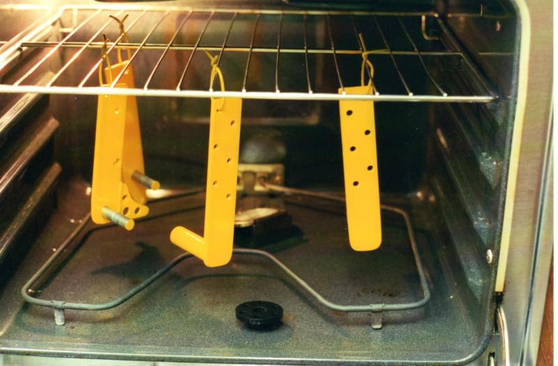

Built and painted the rollcage and some parts for accent using light cromium yellow.
File comment: Can you say tight fit.
File comment: Ticked my wife off curing some parts in her oven.

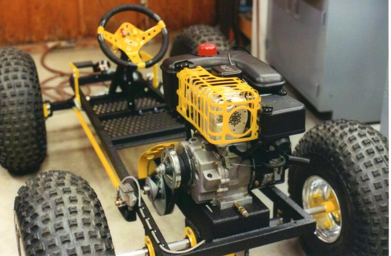

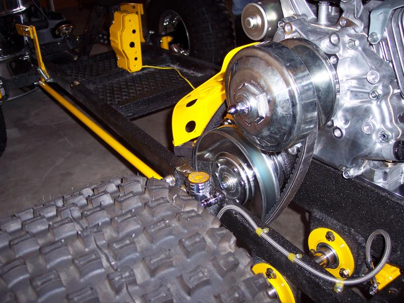

Started putting all the parts on the rolling chassis.
File comment: Yellow accents look great with Line-X.

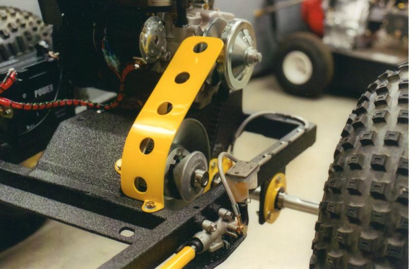

File comment: Made a belt guard for safety.

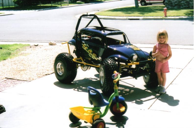

Finished with and without the body. Built a hoop bar in case it ever rolled.
File comment: Custom vinal stickers to make it go faster. He He
File comment: Sometimes we take it out riding without the body so we don't have to worry about it.

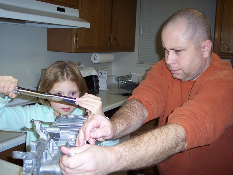

Last year before we got our Pilot my daughter wanted more power. The Engine that we had in it origionally was a stock 9hp Tecumseh (which is no longer in business). Because of the space with the body we did not have much more room to work with so we decided to go with a Honda GX 9hp Engine with lots of mods done to it. It should have about 15hp now. This was my daughters first 4 stroke Engine build.
File comment: Torqueing the head bolts.

File comment: Mounted new Engine on the frame.
File comment: New comet 40 series clutch.

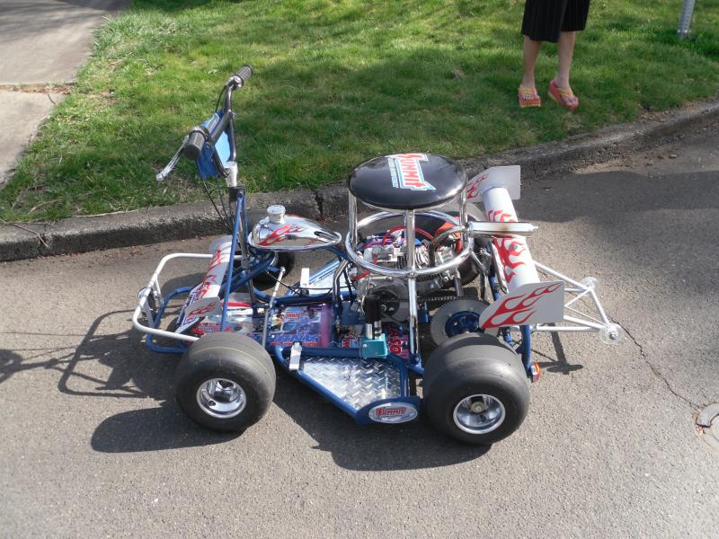

I also build karts. Here is a BSR I built.

I love that you used a Summit Racing barstool. I live 40 minutes away from the one in sparks NV and I shop there all the time.

Posts: 714
Yah it was a theme I have not seen used yet. And Summit has lots of nick nack Summit parts I could use. I lived in Sparks for a few months years ago.
You got some nice parts on your kart. I like the diff.
You should join over at DIYgokarts. They would love to see your build.

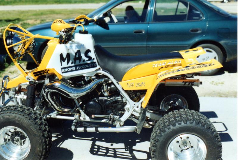

This is somthing else that I made that I used to sell. They were in lots of colors but this was my prototype using my signature color light chromium yellow. I actually sold one to a woman that was hot pink to match the rest of her custom painted quad. They were made out of 4130 chromoly and had 3 135w Piaa lights and fit all years Yamaha Banshee's. When you purched it you would send me your good core stator and I would get the stator rewound for the output needed. We used to do a lot of riding in Baja and it was almost like riding in daylight at night.
