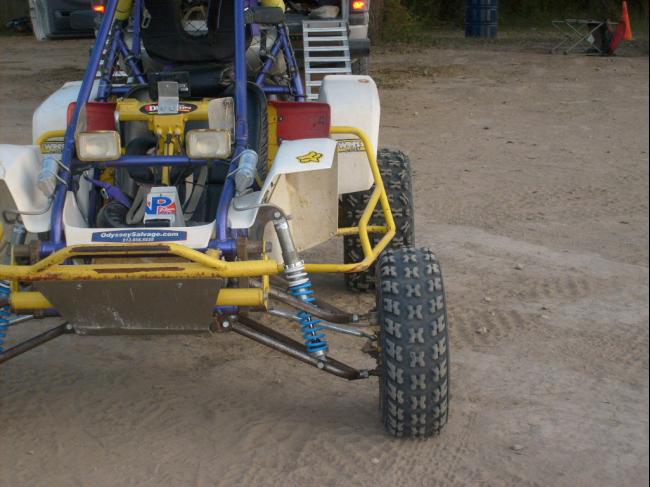

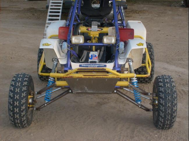

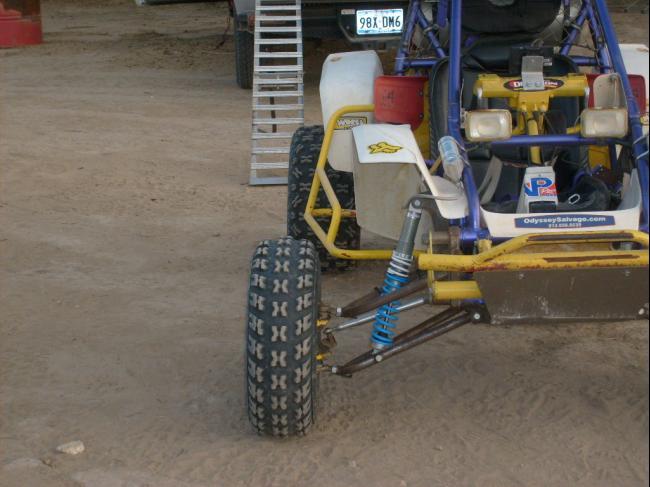

Well I drove this a little bit at the track today and it felt to twitchy... at speeds of 40 50 I could feel the wheel get "stiff" when I would hit a small burm. I still have the toe out problem but it is not as severe. I left it as hoodlum told me??? I had it up on the racks and had the toe set to 0 like liewire instructions/hoodlum stated to set them at droop. Liewire never instructed me on how to do this so I am only hoping that's right... If the ody has me in it, you can see the toe out from the cab. but if I unload the suspension the toe is straight. I guess I'll have to settle for close enough, and hope for the best. I am sure someday I will figure out what I did wrong...
PostPosted: Fri Nov 16, 2007 11:08 pm
some pics...
pic 1 and 2 is right after I get out of car...
the toe is out now... but if I lift and release as I did in 3&4 pics the toe is set right???

I thought he advertised this thing as 0 bump steer?
Where are the install instructions again, if you can see toe change by getting in and out then something is very wrong.
