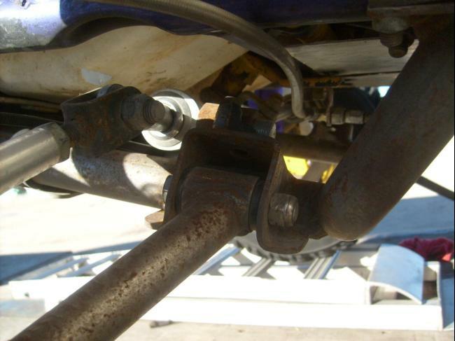

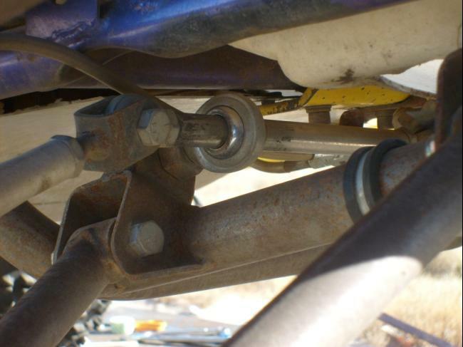

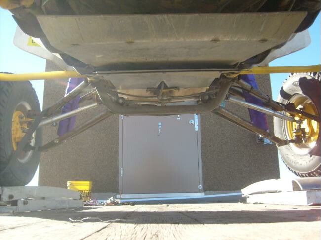

Some new pic's taken today as I was playing in AZ. I noticed something that wasn't matched up and am wondering if this is by design, or might be the cause of my problems???
File comment: I placed a zip tie to compare the gap with

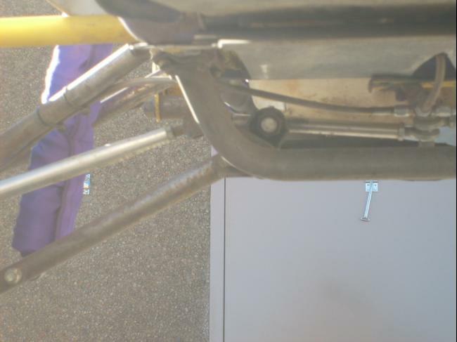

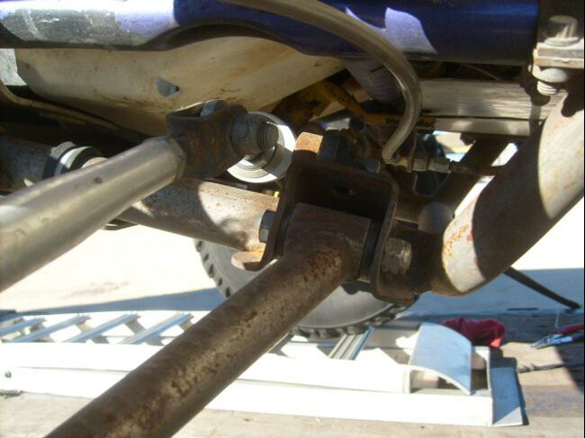

PostPosted: Tue Dec 25, 2007 8:43 pm
Some more pic's from a different view...
I didn't have a good blade on my cutoff tool so I will have to attempt Lee's solution later this week...
PostPosted: Tue Dec 25, 2007 8:48 pm
Merry Christmas you lucky dog getting to ride TODAY!!!
Where exactly where you riding?
I have no idea what your trying to point out here...

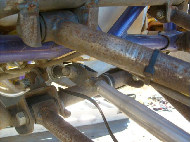

PostPosted: Tue Dec 25, 2007 8:51 pm
the rest of the pic's
File comment: This is what got me started on looking at thing over real good... I noticed that the yellow lines were no where near where the actual pieces are laid in place...
