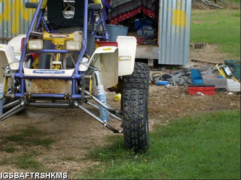

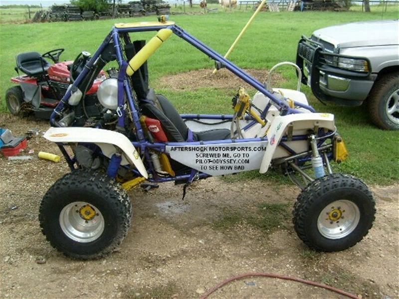

For now.....here's some pictures of the Engine install and new rear suspension.

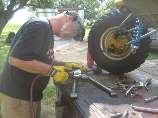

PostPosted: Sun Jul 15, 2007 10:57 pm

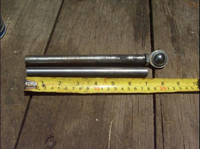

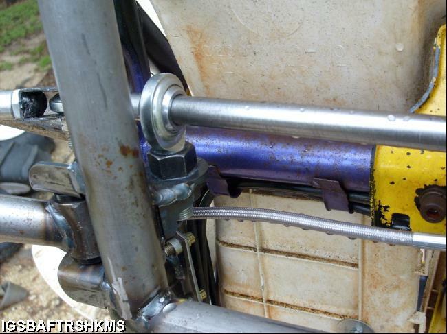

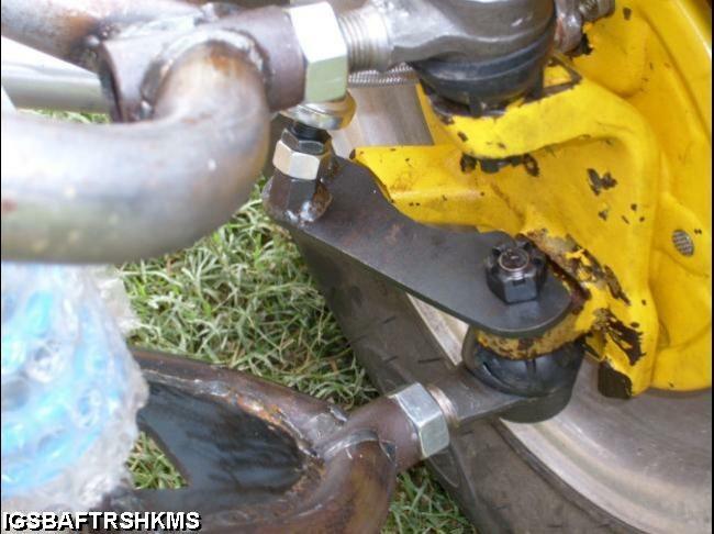

Well I was surprised to receive some "replacement" parts from notsogreatcustomerservice.com aka aftersh ock et al. These are real stainless steel drag links he said on the other site that were sent with original shipment... These are documented in other photos as being 8 inches long, magnetic, with slight rust pitting before being mounted . Of course I was surprised to receive these, as I was expecting to have to have these made. I already had to modify the original steel links I had received, and installed. I already knew I was receiving the new clevis pieces I was also shorted on original shipment. and these had weld splatter I had to clean up. They were made from a thicker metal than the ones I made up at the last minute to get the Odyssey running for my trip to the Oregon Dunes.
After I replaced these I noticed that I had a good dent in one of my new a-arms. Seems I hit a rock and bent this near the bottom shock mounting location. This was the last place I expected to see a kink as it was so close to the flat plate installed in the arch of the a-arm to support the shock. I Stated my concerns earlier about the shock mounting area and how the a-arm itself was only contacting the steel bushing inside of the rubber bushings. the "dust covers" as they were referred to would not be affected. I discovered that the tube that the long bolt goes thru to secure the bottom of the works shocks was the exact diameter as the inside diameter of the dust covers. (see pictures) Once the a-arm hit a rock and then became distorted the dust covers and even the rubber bushing were distorted beyond my acceptable limits. ($700.00 shocks). I found some washers that fit onto the 7/16 bolt supplied by after sho ck and then I cut the mounting gap about 3/16th wider to allow for these common washers. I will try to find someone to weld something a little nicer to keep the dust covers from being destroyed. I was told by many that this would not be a problem. It's apparent they don't ride in the rough terrain I do as I have witnessed the video's of there nicely groomed tracks. I had planned on having some simple aluminum skid plates made for the a-arms, but I had to spend to much valuable time chasing down other problems not laid out in a clear set of instructions... This is the third time I have messed with installing this front end kit... I hope I only have one more to do... to remove and have powder coated!!!
I am in search of a fabricator that can duplicate these a-arms for me as I am un trusting about the original manufacturers honesty towards his materials, and need to be able to replace the original a-arms. I have already seen how I am told something is "Stainless Steel" and then find on my doorstep several weeks later some real stainless steel drag links. As far as the performance of this kit, I can not truthfully ascertain that as I have been reluctant to really push it. It will take a lot of seat time before I truly trust this product. After the lack of product support and POOR customer service I received from the Manufacture I am hard pressed to pass judgement on the reliability of this product. I will probably never know how well this is supposed to work because I will always wonder if I even have this installed properly... I believe after sh ock has left the door wide open for liability claims on any subsequent accidents, as I have been informed by other enthusiast.

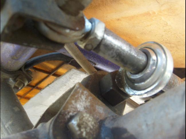

I hope these are clear...
These are of the pieces I was either missing on original shipment, or were to long and and mild steel, instead of stainless...
File comment: pieces I am replacing
File comment: clevis I made. and drag link as found after ride in Barstow...

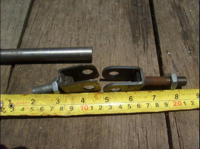

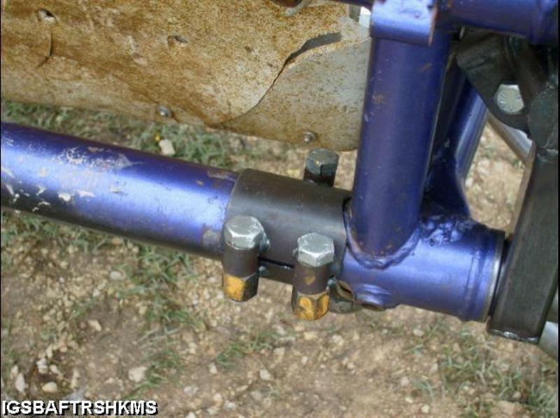

Here are the pieces side by side....
File comment: I was leary about cutting my original 8 inch pieces to short... 7 inches should work...(I HOPE)
File comment: you can see how the manufactures clevis is sturdier than mine
File comment: hopefully you can see the splatter I had to clean off...
yea I know I am a picky SOB...
I am picky about how I spend my money... wouldn't buy a spark plug from aftersh ock motorsports

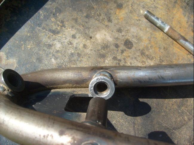

PostPosted: Sun Jul 15, 2007 11:48 pm

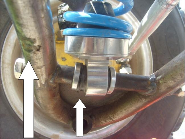

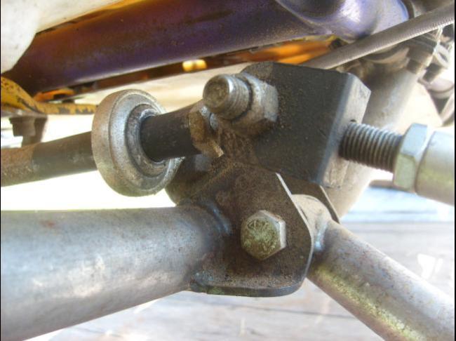

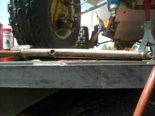

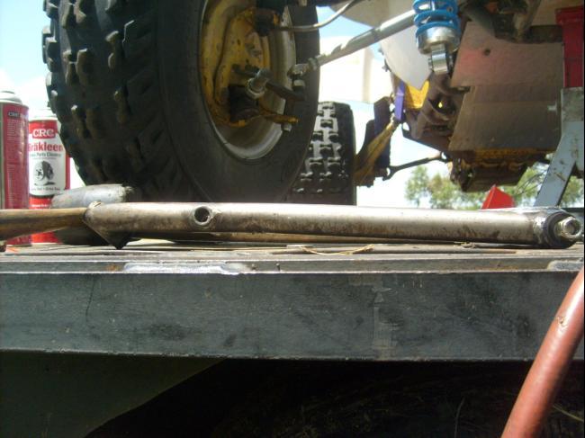

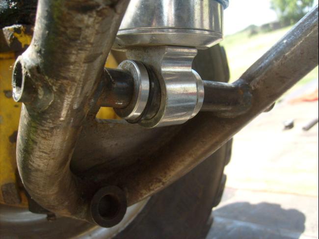

OK here is the bent a-arm I need help duplicating... I think the pictures will show how this is tweaked and what it did to the dust covers...
File comment: arrow shows where hit...
File comment: This one is better, look at the rubber bushing coming out of the shock eye...
File comment: bolt removed, and I had to remove the whole A-arm from the frame to get the shock out of this jam...
File comment: I had to use the vise grips to push the dustcovers off the a-arms...

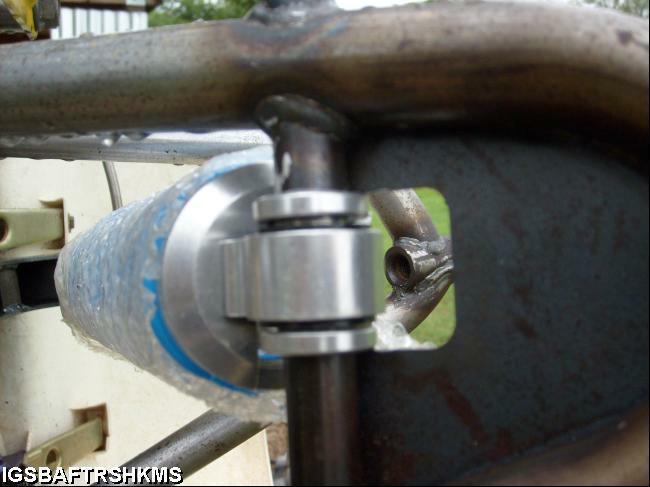

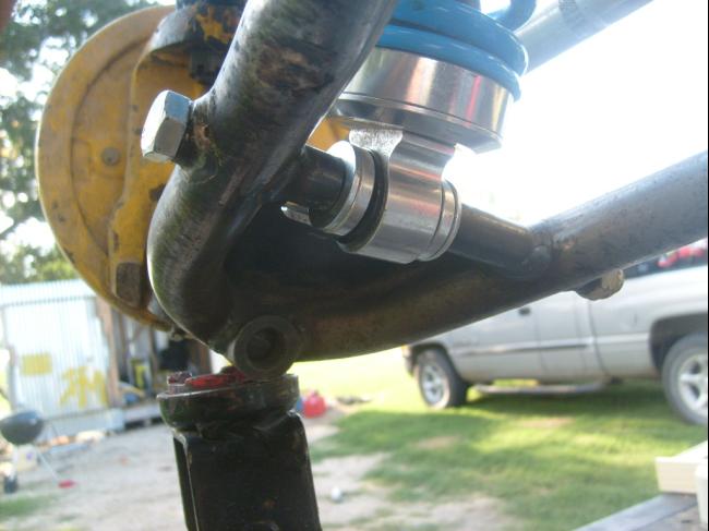

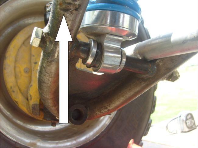

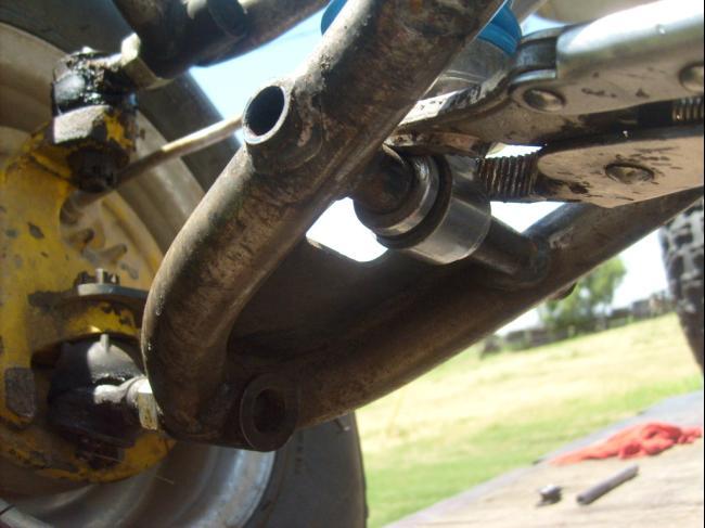

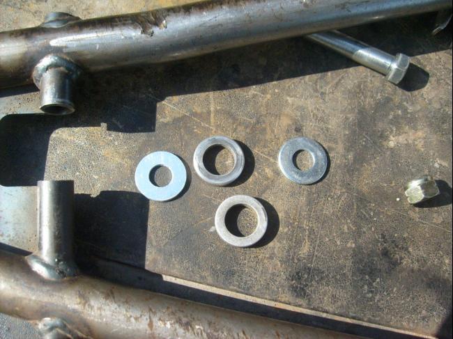

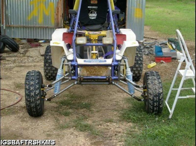

PostPosted: Mon Jul 16, 2007 12:06 am
Here is the a-arm removed and on a flat spot... tweaked...
File comment: see clearance???
File comment: I placed a line from two points with my cheap photo editer... it is straight... now can you see the tweakiness???
File comment: here you can see how the dust cover is larger than the tubing that the bolt rides thru...
File comment: again...
File comment: My temp solution.... 3/8" washers... you can see at top of pic the dent...
File comment: me cutting the slot open...
File comment: You know for $2700.00 dollars I should not have had to do so much work....
File comment: You know when All this is done, and I send a service invoice for the labor and materials I had to invest into this kit I might have enough money to buy a bunch of new tools!!! I am questimating about 50 hours of labor over and above the 18 I was told up f

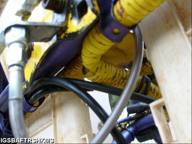

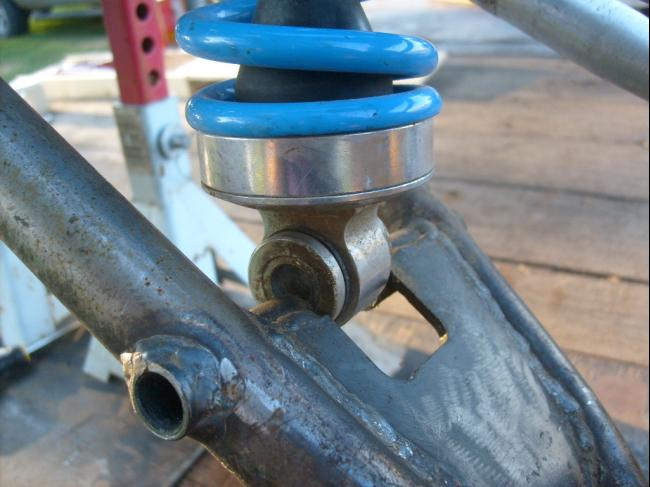

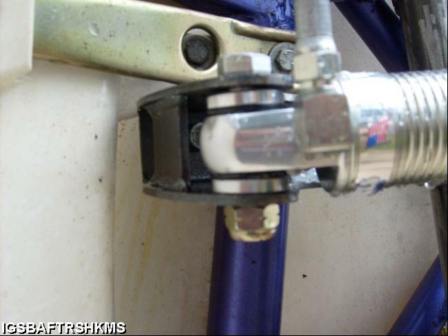

PostPosted: Mon Jul 16, 2007 12:38 am
OK I got it all back together... I had heck getting all the holes lined up on the damaged side... Glad my son was there to help... the other side wasn't hard at all to put back together!!!
File comment: I had my mechanic press the arm back almost to original... we couldn't get this in his press exactly as needed... but its close???
File comment: can you still see the dent???
File comment: yea I need some skid plates... you can see the nick in the base of the shocks...
File comment: this is what I had to work with on the un damaged side... still a tight fit on the dustcovers...
File comment: you can see the works steel bushing with in the dustcover...
File comment: Again...

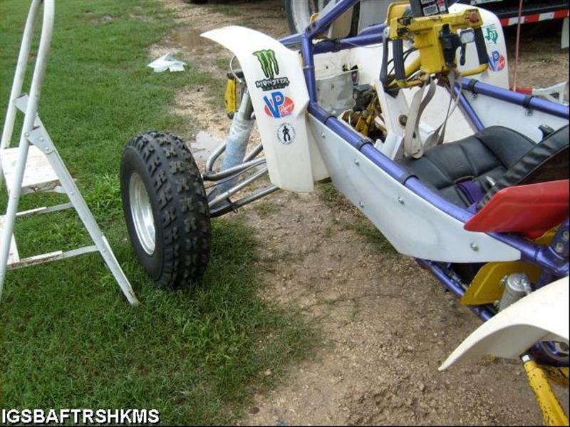

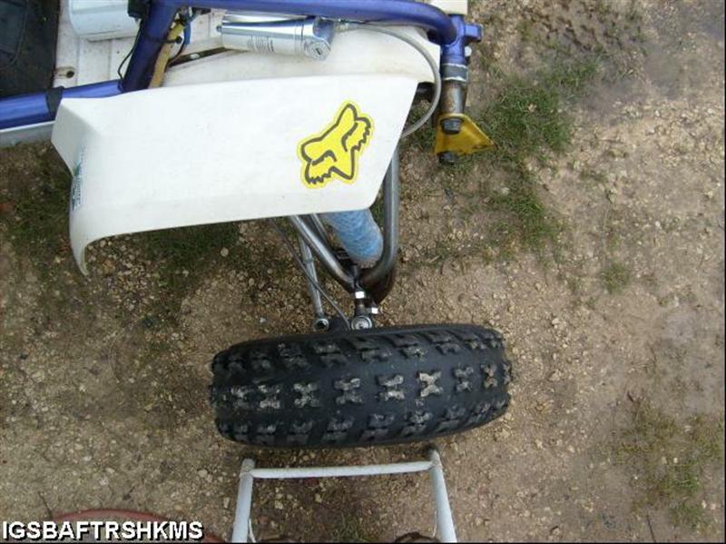

More pictures from original/first time to install...

Turbotexas wrote:
TxBandit wrote:
Turbo, Let me practice making a pair of front a-arms for my conversion. I'll post pictures of the results and then you can decide if you'd like me to make an attempt at duplicating the damaged on that you have. I should have mine done in a couple of weeks. I need to get material, parts and figure out exactly what I'm going to do. They will be different than yours, but only because I'm picky!!
Hoser, I registered on the photo album page. Troy
Tx Bandit!!! I will come see you next time I am back in Texas... I left the ody at home this trip as all my issues weren't resolved... I didn't feel like dragging a trailer queen all over the higheways and byways this time out... I have some ideas to improve these I want to run by you... there is no reason (besides poor design) for the rear shock mounts to be boogered up yet... I have looked at alot of quads and aftermarket a-arm kits for these and none have the piss poor mounting setup... I am sending pictures to Works Shocks for their advise on how to remedy this problem, along with a request for new bushings...
Sorry for the late response, I've been swamped at the office.
Give me a shout next time you're in the area. You can come by and take a look at some of the other stuff that I've built and make your own decision based on what you see.
I'll PM my number to you.
Troy

I was going through thechassisshop.com manual and came across this special hiem joint to support the steering shaft.
http://www.chassisshop.com
PostPosted: Sun Aug 05, 2007 10:41 am
Full page
You can download the catalog off their web site I have a hard copy.
