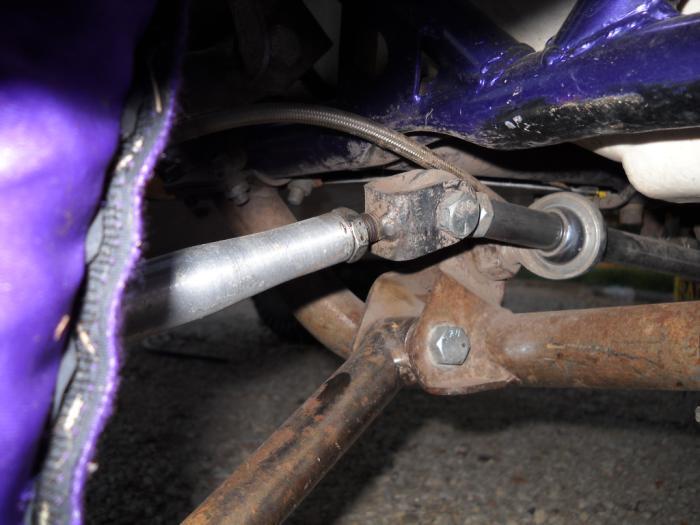

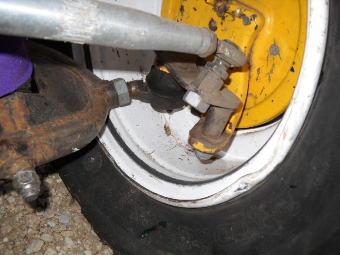

Here are some pic's of something I discovered... This is why my wheel locks up on me...
File comment: the plate the big hiem goes thru...
File comment: you can see at the top how it folds back...
File comment: you can see here how out of squarer it really is... This is why I get so much wheel travel before lockup...

That steering setup is a joke we been laughing at it since day one, well we laughed until it locked up on you and that other guy causing him to crash and wreck his 350 pretty badly now its a serious issue as we suspected from day one its a dangerous dumb setup, scrap it ( I know easy for me to say) beg andoh to help you build something like he has on his Pilot,,, pull your rig in his front yard blocking all entrances and exits until your steering is FIXED and SAFE!
Well maybe that is going to the extreme but I bet if you asked him real nice lol :-)
Time to get a camera too :shock: those pics are very poor.
I resized your pics to 800x600 hope you don't mind...

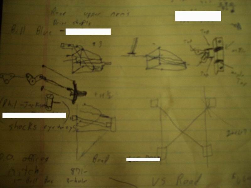

Heres a pic of how it started in OKC. That will teach her to go shoping. I whited out the phone numbers of work related personal. This was a page of my office work book I travle with. The work involed to make right is lenghtly and notes must be taken. You do not just bolt up and go. That is what the professional sell and back. Many hours of testing go into such items and You, I and others pay for that testing when purching parts. The ATVR lt kit is a fine example of this. Not trying to talk you out of anything I just want you now what it's going to take to fix. Your on the right path by logging every issue the the effect, keep doing this it's all revelant. Hopfully what you have can be salvaged and other can benifet from it. You now a simple spring change in the rear can effect the way it handle thu the cornor.

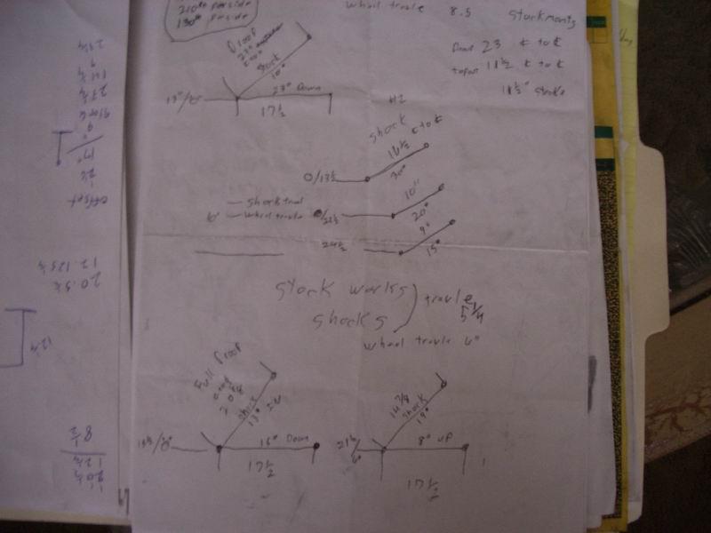

I will post up some notes from my folder on front end so you can see what I mean. This folder contains around sixty pages of notes and discussion and the lap top has hundereds of pics and a excell work book with lots of data. Which remindes me I should back up on updates on external drive.
As far as hacking tools go 110 vlot welder, fire extenshier,hacksaw or band saw, grinder,small drill press, drill bits, metal, air compressor, datco (small air grinder), misc sanding pads and meal file. I call this a hacking bench. It all sets on a roll away table with the exception being the air compressior, it set in cornor with hose real. I do most of mine right on drive henc Back yard hacker.

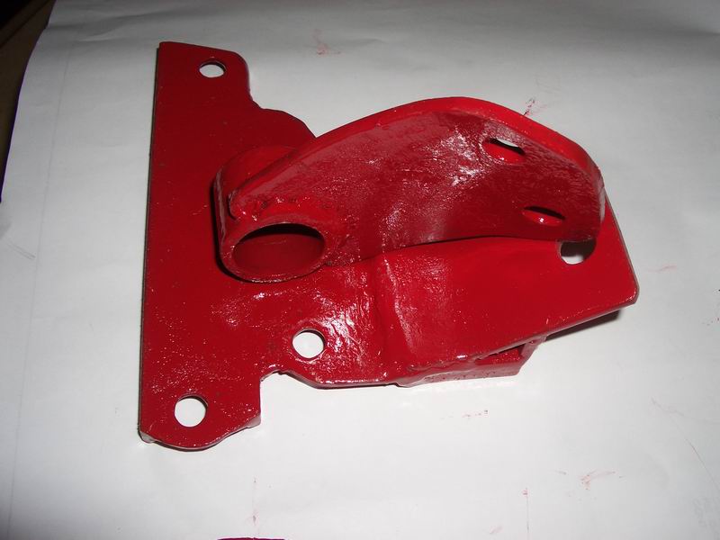

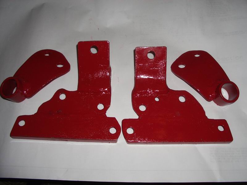

Here is some discussion note from folder,wookbook and pic of updated bump.
File comment: Reworked flex plate adding bump stop plate and new idler bracket.
Reworked kit, bump stop bracket added and new LR curved bracket.jpg [ 76.45 KiB | Viewed 5701 times ]
File comment: New idler bracket. curved down for shear load inpact and line up on bump stop. This takes the shear force from idler to frame and away from steering wheel and inner ball joints.
New LR curved bracket lined up with bump stop hole on bracket.jpg [ 76.34 KiB | Viewed 5701 times ]
PostPosted: Sat May 02, 2009 2:28 pm
I had to add a bump stop backer plate to the frame. This bracket had to be welded into place. Two reasons.first this still allowed me to bolt up plate and alow the shear force to be transmitted from bracked as it flexed to the frame.
What I did on adjustment was set bump stop bolt to bottom (on new idler with new ratio) just prior to steering stop. This way I use all of the steering wheel where previous I only used 80 % steering wheel to 100% of wheel movment lock to lock. This also allowed it to flex under load using bump stop before hitting the steering stop on colum and keep from transfering feed back to wheel. I do some issue with deflection in material used in bump stop kit. So far I feel it not to be an issue I have found a denser material to use however there may be a trade off from deflection force and move it ot the bump stop and frame mount and brakcket flex.
File comment: Frame plates welded to frame. bump stop bracket flexes to frame plate.
You cant get it to a 100% ratio and just use the factory stops? Even at 80% can you adjust the factory stops (weld something on them) and use it?
The best place to have a stop would be installed at the wheel so any impact force would not have to be transferred through the tie rods to the factory stop it would do the banging out at the wheel?

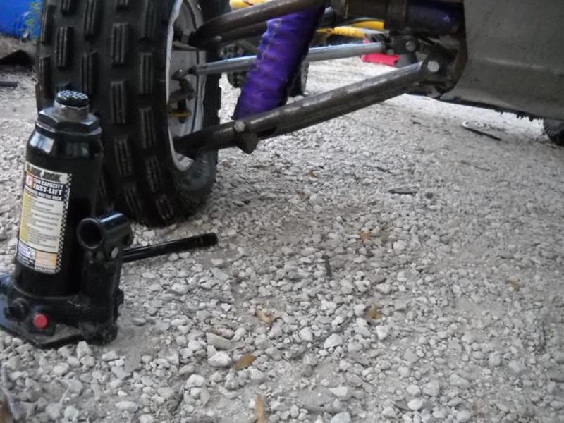

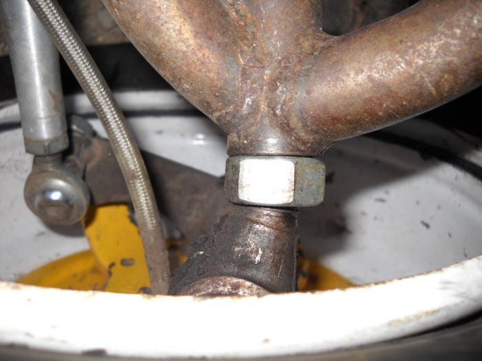

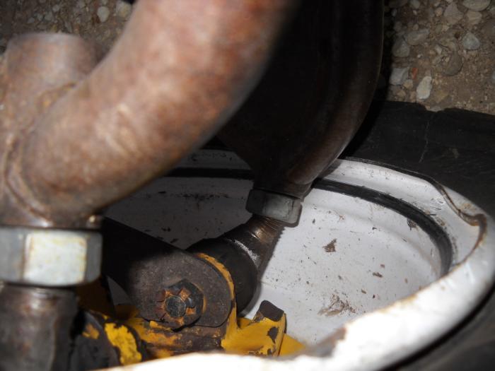

Here are some pictures...
Mud I think I will need some brotherly love on some A-Arms you mentioned!!! The lower one is tweeked pretty bad, and I am not sure if I can get it twisted back to shape! I am afraid this will tweak my Shocks! I have a race next week end and at the end of the month so I am trying to get this done this week! Tomorrow I have to take the top end apart on the 400ex basket case so I know what I need to order!

Is your front spindle cracked in the last pic just above the R or is it just an illusion?
Redman
 Post subject: Re: Damage
PostPosted: Sat Aug 08, 2009 11:27 pm
Redman
I see where you are talking about, the upper right corner? I will look tomorrow...
PostPosted: Sun Aug 09, 2009 9:11 am
Joined: Wed Feb 11, 2009 12:25 pm
Posts: 70
Turbotexas wrote:
Redman
Actually it's right in the center of the hub...See the R on the hub in the pic? Now look just above it...It runs horizontal...
Redman
