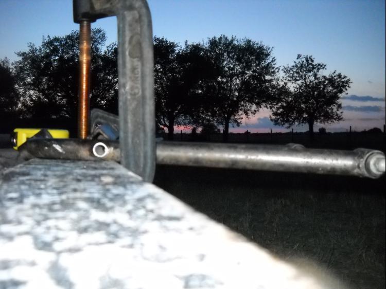

I will try to find a piece of card board around here to trace this and the upper arm out and measure! I am unsure if I want to add a piece of angle iron to the front of this ala hoserize it or put an aluminum skid plate on the bottom? Niether one of these would have prevented the damage inflicted by the fence post, but I do get into some rocky terrain... worried about the wieght...
I am also contemplating 450R spindles??? which will make up for the added wieght of the angle iron...
File comment: You can see sunset
File comment: looks flush/square to me???
PostPosted: Sat Aug 15, 2009 10:01 am
Looks pretty good to me. Does the shock bolt line up ok. Should probley have mentioned to install as not to twist out of place. Sorry.
U=You would be surprised how many use can be found for that piecs of pipe. Leverage is pretty cool. Those arms must not be to weak if it took that much leverage. You now a back yard hacker/ truck stop hacker. I like to say
N B D, just do it. No Big Deal. Now take that cave man tool ( hammer) to that rim. Please replace ball jiont thu do not straighten and check all bolt for fractures around the head of the bolt. Bet you fell better now.
If you change to 450 r you gota have the uppers adjustable or it wont turn, ok not as good since you have pilot set up welded to frame.

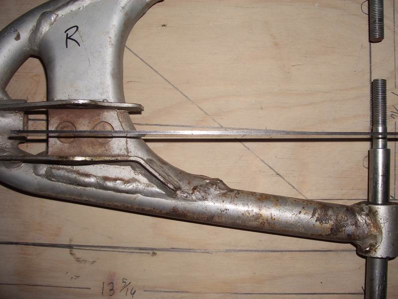

PostPosted: Sat Aug 15, 2009 1:08 pm

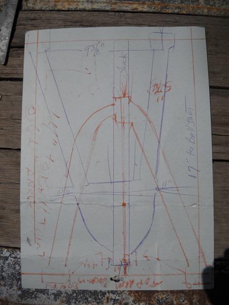

ok here is the top right (passenger) side a-arm drawn out...
10" from center of bushing to center of bushing
5" to center of ball joint a peak of the A
14'' from center line of bushing to tip of balljoint as installed and a 60* angle on the threaded piece

ok here is the lower a-arm
from top left corner it is 9 3/8" from center of bushings to c.o.b.
from top left corner to center line of ball joint threaded piece is 6 1/8"
from top to end of balljoint in a T line is 17"
and in a T to the shock mounting bolt is 11"

PostPosted: Sat Aug 15, 2009 6:10 pm

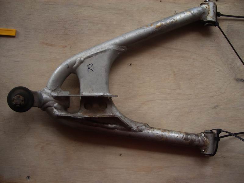

Got back from town and had an hour to get this. I will look over all the numbers tommorow and try to mock up a sample. Need to go eat with folks and listen to good band. I,ll be home late.

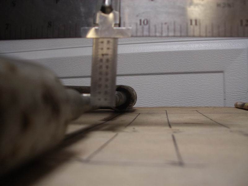

PostPosted: Sun Aug 16, 2009 2:59 pm
Turbo. did some measuring and this is what I come up with on the lower.
The diff from stock to yours.
Yours=:
Center to center on pivots +1/8 inch
Note: I measure over to it on the tube this will give you a center to center. This may account for diff.
Wheelbase change - 15/16 ) to 1" back
Note: This may be ok for the ody. Need to check yours verses stock for a accurate # of change. One item to consider here is if this is used on a pilot it will narrow up the whellbase ( lenght c to c of hubs) and will increase lawn darti avgle and rocking thu wooops more noticable increasing kick. This will also effect steering angle.
Width of arms + 3-11/16 ) to 4"
Note: This is due to having adjustable on yours and stock fixed. You should set your lower and adjust camber with upper. The futhur your lower is out from tube the greater leverage force is applied to the ball joint shaft.
Shock hole +3-1/4
Note this is a stright line # this will change because your arm is a LT which is mounted under arm and stock is mounted above arm. This is done on the LT so it can use the longer shock shaft withot major increase in ride height at a given sag. The Stock 1-3/8 up from C of pivot at 7-3/4 from center of pivot( see pic).
Interesting fact on GEO of stock. The shock and ball joint Center lines mate up on C of pivot. I would take this as they wanted the leverage force applied to the same point which by the way is about 2/3 of the arms c to c on pivot.
Thoughts: I would not use this arm on a pilot for the reason of reduce wheel base. If one was to run a reduced wheel base on there pilot with a extended front bumper OUCH , as the front suspension goes into bump the front has a higher tendesy to hit and pitch the machine forward ( aka crash). This is why I run a skid plate under my stock plastic bumper. This way when I dive it in the suspenion will asborb impact and have time to rebound before bumper hitting and letting what was set in motion to stay in motion instead of adding opposing force allowing the rear to go over. I do belive the added track width and longer travle has a major advantage over stock. I would replace the ball joint with a higher quality. On the upper I will have to do some more checking. I would add caster adjustment thu.
If the wheel base is shorter I would lean torward have new arms made +2. This willchange the steering and bump. Since your bump is bad any way one can unbolt ite hold move by hand back 2 inches and check to see if its better of worse before moving frame mount.
I will check other arms for fitment and fix. The +4 on yors is a HONDA LT + 2 on most 250s 400, and 450s. The key is the forward # and lT shock used for proper leverage ratios. If you change the uper to caster adjusteable youmay be able to just bolt on new ones.

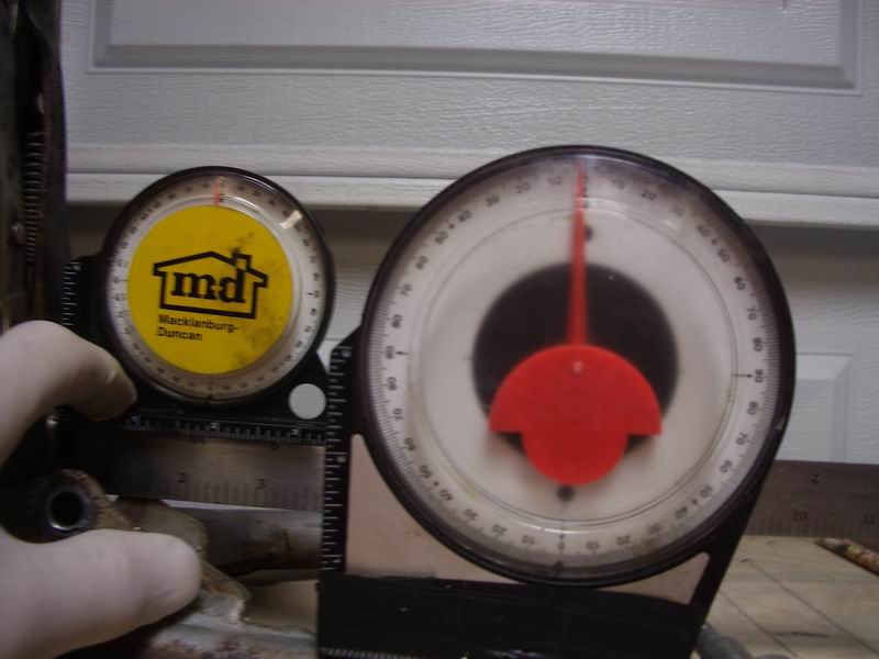

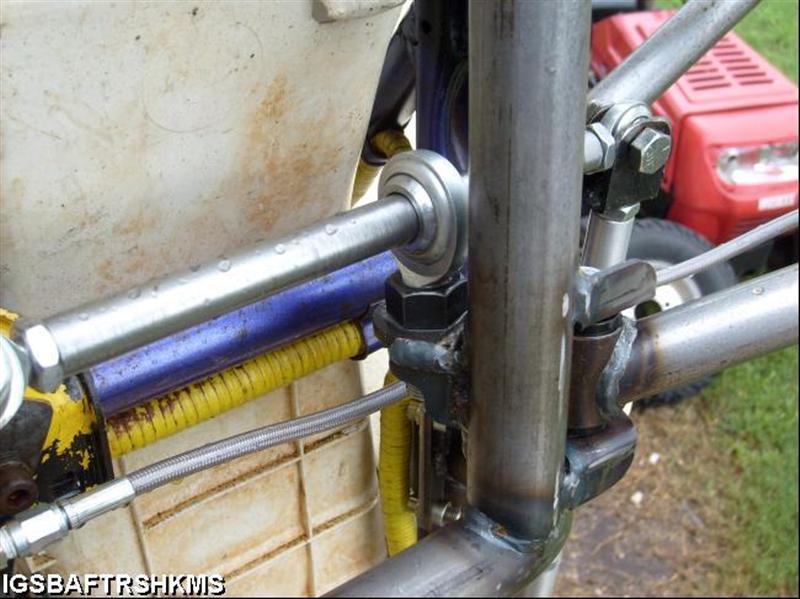

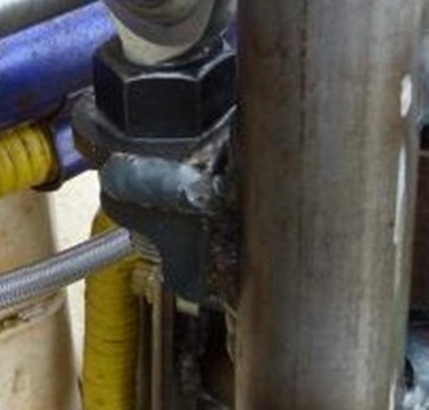

ok back on topic...
Here are the detailed pics chucklenuts at aftershot motorspurts sent with the kit...
And then some pictures of how I installed on my ody...
So maybe they will man up and come show me where I have this installed wrong...
I won't hold my breath though...
File comment: This is the revelation that hoodlum/rooky/redman or whatever he calls himself this week pointed out was wrong with the initial set up... But wait this is a picture of afterthought instructions!
File comment: this is the next thing they tried to blame my troubles on, they stated I had this screwed to far out...
File comment: just the full size photo...
File comment: here it is on day one installed just like the pictures Chucklenuts sent!!!

PostPosted: Sun Feb 07, 2010 11:05 pm
OK Here is the reason my right side steering is locking up...
If you notice the pictures above one tab is built better than the other, wel not built better just braced better... When you ride in the rough stuff like I do there needs to be some better back bracing in the piece you designed to act as a steer stop... Doh and they called me stupid!!!
I gotta give credit to adnoh because he pointed this out to me!!!
why it locks up.JPG [62.05 KiB]
Downloaded 261 times
PostPosted: Sun Feb 07, 2010 11:09 pm
Are you still trying to use a hiem joint for a linear bearing?
PostPosted: Sun Feb 07, 2010 11:30 pm
When I get home I will take better pictures of the wear on the lawyer links...
Hoodlum posted a new design from this bunch of idiots that is going to use a grooved or slotted lawyer ling to reduce "drag" LOL
I don't know what I will come up with for the linier bearing thing... I will do some research of what massody had on his...

PostPosted: Sun Feb 07, 2010 11:38 pm
Turbotexas wrote:
You mean after all these years of saying their is not a problem they are making changes, if their is not a problem why the change.
Materials are not the problem the design is the problem.
