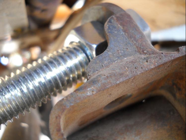

Well I drug out the ODY today to start the process of getting it ready to ride! First thing is to finally fix the piss poor job that chucklenuts at aftershot motorspurts did in his design and manufacture of this kit!
The basic issue is not how I have these adjusted as suggesested by chucklenuts here...
http://www.minibuggy.net/forum/good-sto ... pilot.html
Even after I showed him that it was impossible for me to have these hiems "too FAR out" as I have them screwed in all the way! No threads showing!!! So that debunks his lame blame turbo game!!!
The reason this Kit kept locking up on me had nothing to do with how this was adjusted or tuned in, but because the Design team at afterthought removed the stock steer stops and replaced them with some flimsey thin metal, then didnt brace it properly!!!
Here are some pictures of how I used to have to un-bend the mounting point for the hiem that stops the steering!
I have some video also but it needs to be reduced...
Basically I am using a 3/4" piece of all-thread to bolt on either side of this piece that keeps bending... It is is hard to get to, especially on all 4's

What I did today was to cut some 1/4" plate steel to replace the junk 1/8" little brace...
File comment: This side has never locked up...
old 350 fix welding 002.jpg [42.12 KiB]
Downloaded 291 times
File comment: see how this is bent? That is from the Steering stops chucklenuts didn't brace right...
old 350 fix welding 004.jpg [43.57 KiB]
File comment: the piece I cut to fit!

OK Here are some more photos...
File comment: this straight edge shows how far this is bent...
old 350 fix welding 011.jpg [45.26 KiB]
Downloaded 277 times
File comment: the other side still straight
File comment: See how big the corner piece is on the good side?
File comment: cant see this side???
old 350 fix welding 021.jpg [47.18 KiB]

I had no idea you were bottoming out that nut on the hiem joint as a steering stop, I knew Steve was dumb as a rock but this tops all not only are you NOT suppose to use a hiem joint as a linear bearing your NOT suppose to apply shocks loads to them or side loads like you are for a steering stop, how dumb, is this really the best he could design every time I look at that mess I see more jackassery.

Hoser is right I cant believe they would run a heim like that, not only should it not be used as a slip joint I cant believe the nut on the steering shaft just slams into the heim for a steering stop, the heim has to much leverage being applied to it plus what happens when the nut on the shaft eats up the heim and make the shaft seize in the heim?

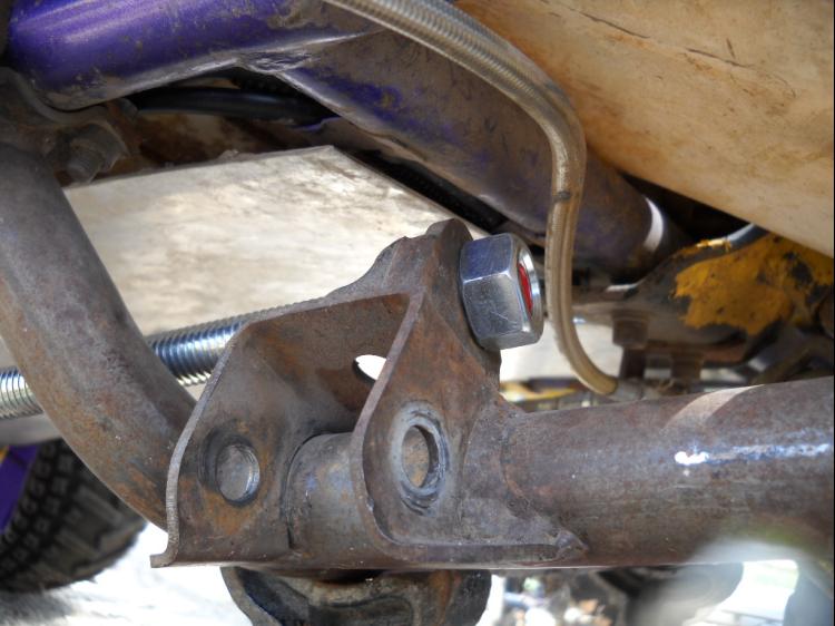

Well aftrer re inforcing the cheesy bracing and buying a heavy duty hiem, I have started to put this back together! The first thing I noticed is a 1/8" difference in the hole and the hiem bolt size! Such sloppy tolerance are to be expected from chucklenuts at aftershot motorspurts!
PostPosted: Wed Sep 01, 2010 10:48 pm
here are some pictures... Below are the pictures of what I was refering to earlier... Why is there 1/8" inch or .10 inch on my caliper? That's a lot of slop and as muchg as chucklenuts at aftershot motorspurts blamed ME for not having this set up right all I can say is he should have done a better job of putting the right size holes in this mess...
File comment: here is the gap I was talking about...

These Hiems were bought from ATVRacing in Phoenix... They are a heavier duty item and cost maybe 10 dollars more each!!! So why does chucklenuts at aftershot motorspurts charge $2700.00 and cheapskate over something like this...

OK So a while back I braced the big sloppy hole that chucklenuts at aftershot motorspurts provides with this kit! Now I have some heavy duty quality hiems, unlike the crap aftershcok provides with this $2700.00 kit... Now I have installed a way to return the steering stops to the odyssey!
