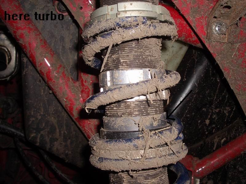

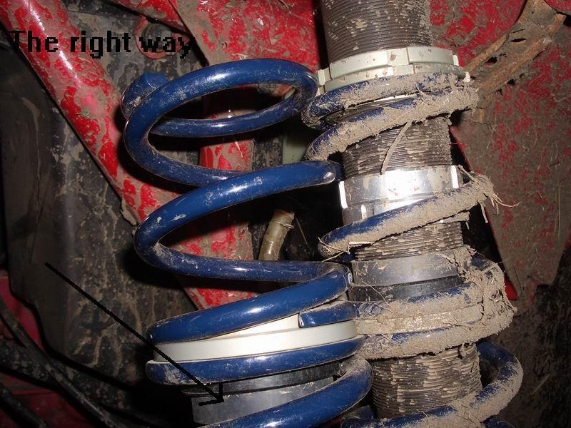

Yes the black plastic thing is in upside down that is spring spacer slider install upside down the right shock transitin to the tender spring sooner then the other side. The Al colour is up and slider down. This is why it took off funny as the spring compressed it transitioned sooner on the right side getting stiffer and tossing it left side down as it unloaded. Told you I was an Idot. I 'll blame the red and white ,will that get me off the hook.This also will cause kick on entry into woops bieing to stiff to soon and slam the right side left and make you feeel like it packing. I knew it was not the take off ramp I jumped the wifes and 450 to make sure.
I fixed it and adjusted the transition spacer + .1475 and + 8 clikes on rebound ready for test tommorow. Was fun thu wasent it finding the OOPS. I hope every one got a good laugh out of it I know I did after wife gave me the look. Once dialed in tommorw I will try double if right Yes my freind will be to shoot video.

I bet some can can add arrows to pic for easy explation I cant get it to work.
PostPosted: Sat Nov 22, 2008 1:08 pm
Arrow test. Here Turbo I think I have it. I like learing new stuff.
