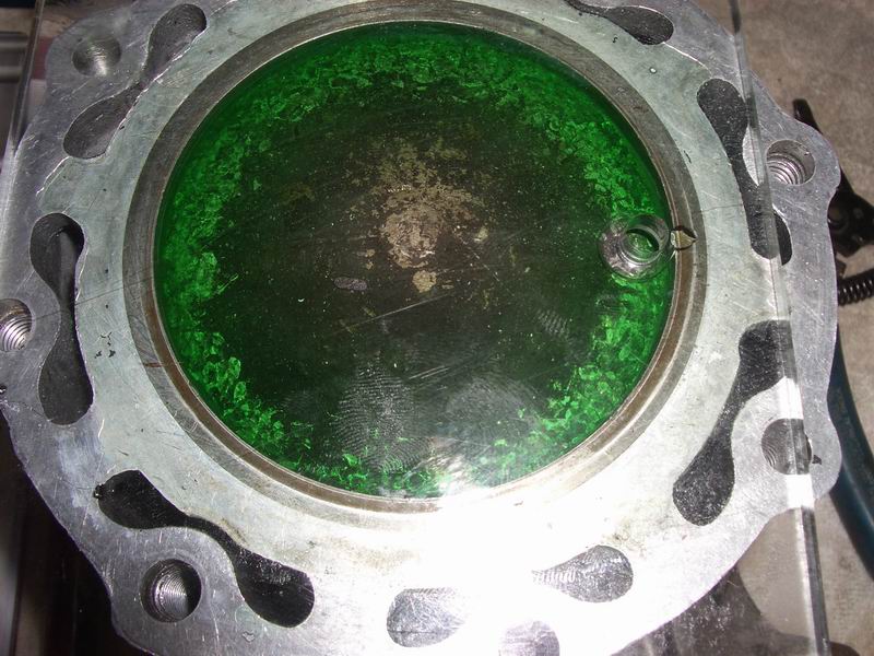

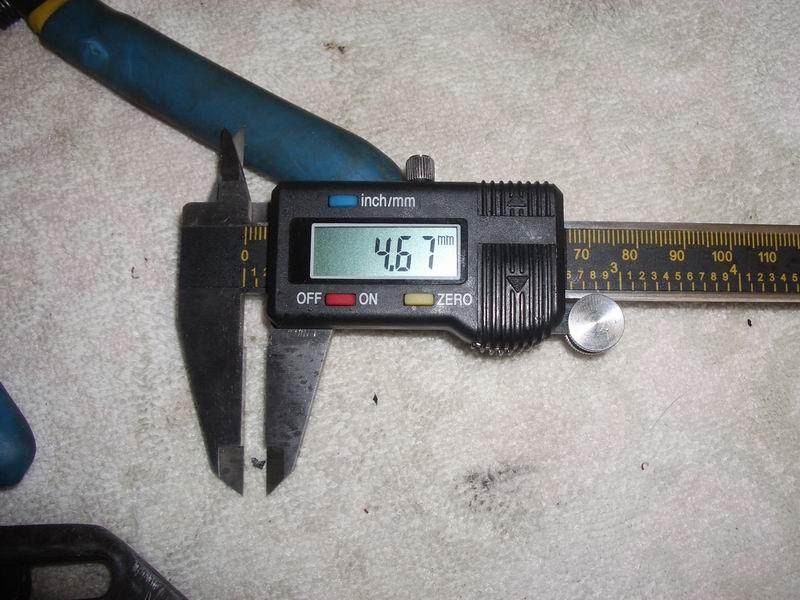

PostPosted: Sun Jul 11, 2010 11:06 pm
more pics

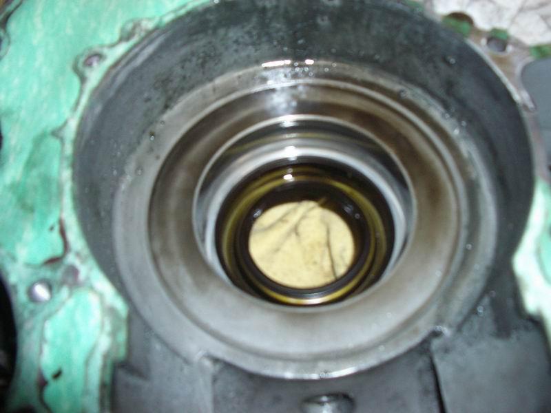

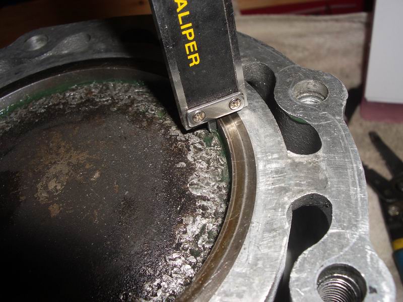

Getting crown edge to top of cylinder measurement.JPG [ 124.55 KiB | Viewed 5078 times ]

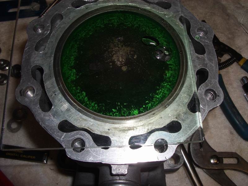

PostPosted: Sun Jul 11, 2010 11:15 pm
Test #1 yeided bad result due to the hole in the flat bar ( TDC (Top Dead Center) bar) did not quite set the piston flush and the plate had a littel warp to it and leaked . Thought I would get a more accurate #. The piston had to be moved from 4.67 to 4.93 mm.
Test #1 16.5 cc's.JPG [62.47 KiB]
Downloaded 91 times
Test #2 15.5 cc's.JPG [57.33 KiB]
Downloaded 91 times
PostPosted: Sun Jul 11, 2010 11:52 pm
Well test #3 went much better and fell good with this one. I willuse this number for spreedsheet.

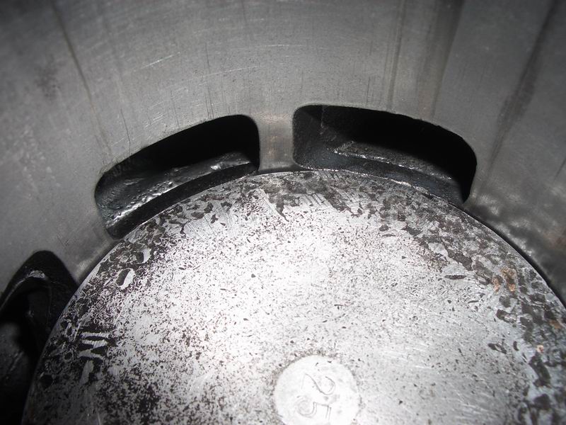

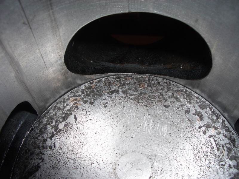

This pic will show the location of the piston at the point were the transfers start to open showing how much of the exhaust port is open. Notice in the pic the width of the exhaust window at time of transfer port opening. So what I did was pretty simple. Take and measure from the top of the cylinder down to were the top of the exhaust port opening and write down this number. Then measure down from the top of the cylinder to the top of the transfer port openings are and write this down as well. If you have not take the time to measure each transfer window to make sure there are all the same. If not they may need to be matched as that is part of the blue printing a cylinder. If they do not match there out of balance and will effect the way the cylinder is cleared of spent gases and the amount of new charge which effect combustion and power. Be careful as not mess with the roof angle that will do more damage than good.

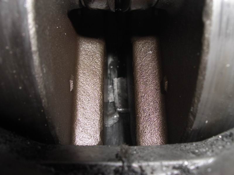

Now that we have the numbers I can input them and get degrees. What I also did was factor in the .18 mm of deck ( already had data) and subtracted this from each number taken at top of cylinder.
Here is some pics showing the piston at BDC ( Bottom Dead Center and the Port floors matching up. Now look again at the drawing and you see what I mean about the sleve. A note to you 350 guys look your over and go UM. Then start measuring your blow down. And you may see how this is relevant even to a 350 and possible changes.
Piston at BDC right side main and rear transfers.JPG [ 152.41 KiB | Viewed 5078 times ]
Piston at BDC left side mani and rear transfers.JPG [ 132.45 KiB | Viewed 5078 times ]

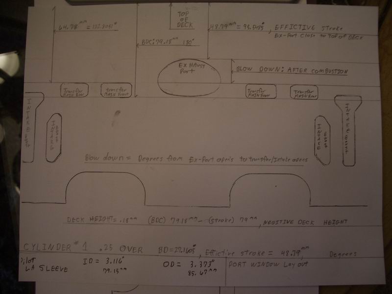

PostPosted: Tue Jul 27, 2010 11:13 pm
That piston is hammered dog S_ _ _ . But it works for the discussion. and base line number to use for a plan.
Now I will post up a pic of the port window lay out showing the relaiton of the ports and some numbers with the degrees and the blow down for this cylinder.
What I did was draw across the windows where I took the measurments from and the lines show a relation to the windows. Now look at the sleve ex port window and were the line goes through it and where the widest part of the oval is at and also note the amount of area above the transfer opening.
What I ended up with IF I did the math right was 27.1605 of blow down. SO what does this tell us and How can I use this imformation.
I will discuss this later as it's time for some sleep had a rough day at work. Rememebr as always this is just Back Yard Hacker stuff and not to be used other than for discussion. Please let me know if I oops some where. Thanks.
cylinder #1 .25 over port window layout and blown down degrees 27.1605.JPG [ 58.29 KiB | Viewed 5141 times ]

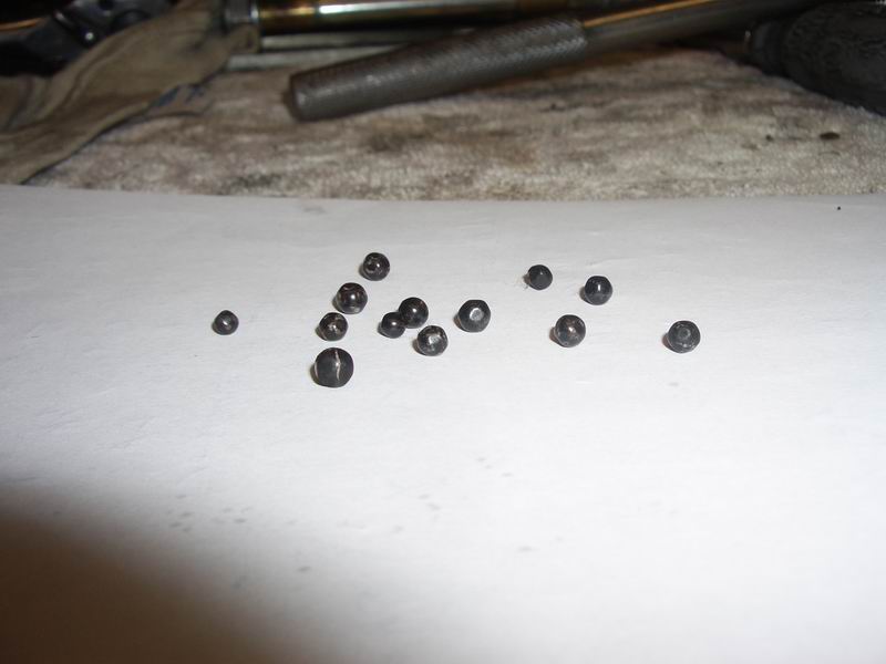

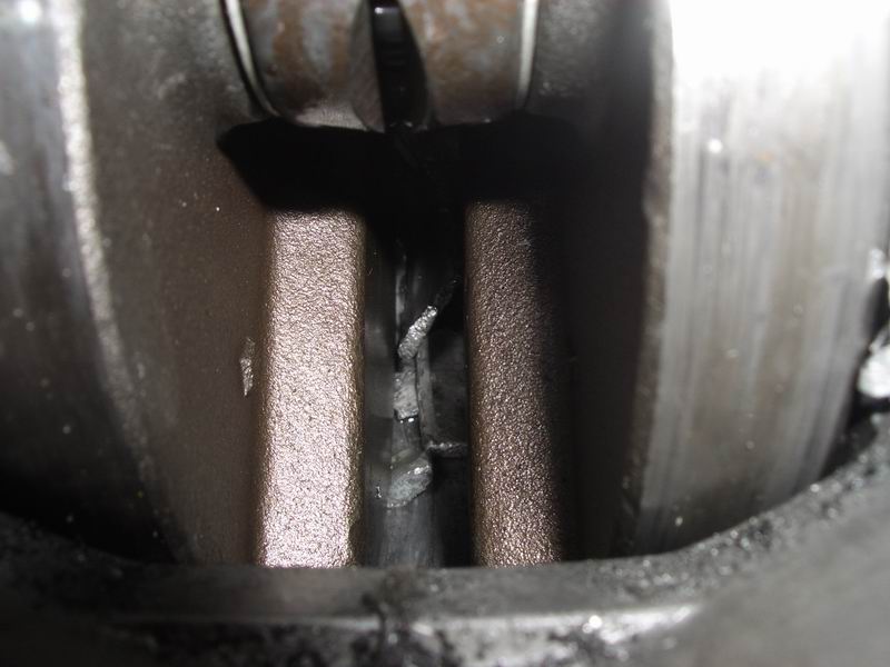

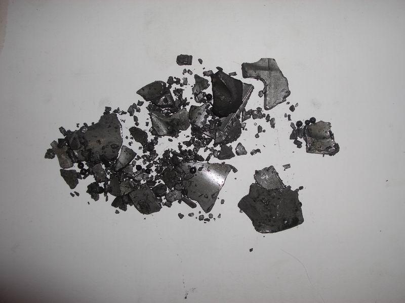

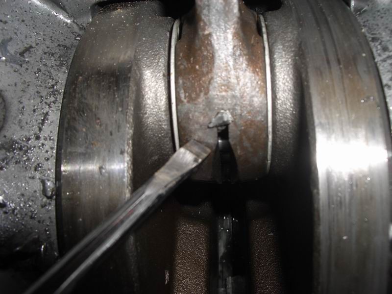

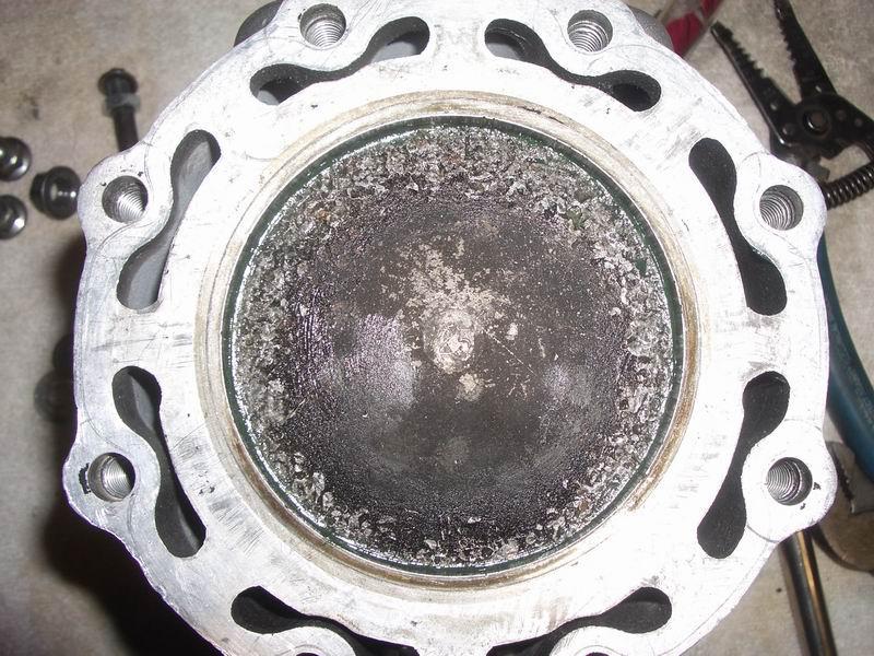

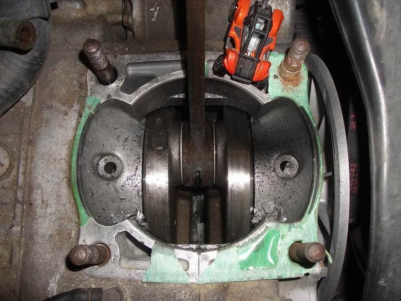

For those who like pics better than the math stuff. Here is some pics of the bottom end tear down.
Since the piston came apart ( gernaded) I was being carful taking it apart as not to move the crank any more than I had to as not to damage the botton end any more than is already done. So what I did was pull the Engine and remove the drive side case first and clean out the big chunks before tearing down the alternator side. This way as I remove the big nut under I do not intervertanly dig the parts into the bottom of the case if it spins on me.
I would never recomend just washing it out and installing new piston due to the amount of debris that ran through the Engine case. You just never get it all out and I have pic to show that. Plus this way I can inspect all the parts. It needs a boat load of new stuff. Ouch goes the wallet.
Bla bla bla, I will let the pics do the talking and I'll shut up.
Bottom end tear down , Found the rest of the piston.JPG [ 134.01 KiB | Viewed 5078 times ]

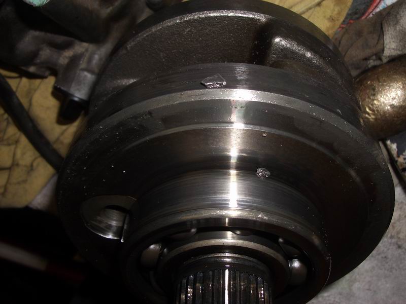

Remove drive side to clear out debris before tear down .JPG [ 122.7 KiB | Viewed 5078 times ]

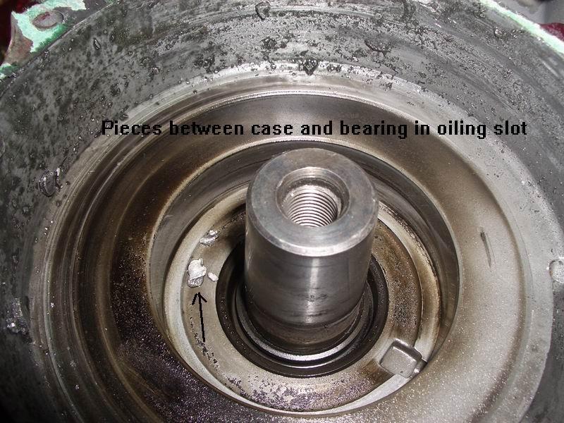

PostPosted: Wed Jul 28, 2010 10:06 pm
more pics.
debris that can not just be washed out with going thrugh the bearing or damaging the deal and willlead to later failure.JPG
debris that can not just be washed out with going thrugh the bearing or damaging the deal and willlead to later failure.JPG [ 155.06 KiB | Viewed 5078 times ]
crank removed and still parts stuck to crank bottom.JPG [ 88.83 KiB | Viewed 5123 times ]
Piece wedged into case in oiling slot between bearing and case.JPG [ 133.58 KiB | Viewed 5078 times ]
PostPosted: Wed Jul 28, 2010 10:26 pm
more pics. sorry for all the misspelled words kinda tired.
Found the rest of the piston. This is from teh bottom of the case.JPG [ 81.1 KiB | Viewed 5119 times ]
