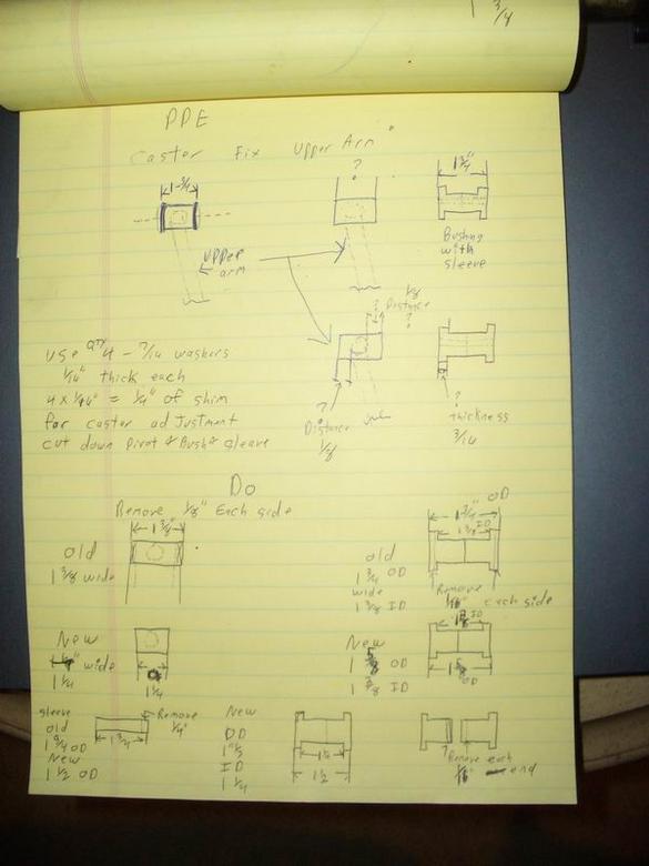

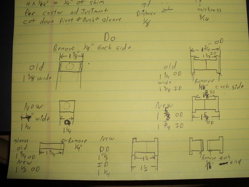

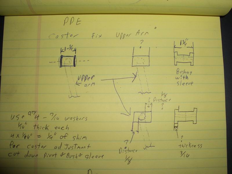

Her is an idea for the caster adjustment without adding hiems and bungs. This is how we dialed or trx 250's. Nobody noticed the change and those who did we told it shimed the bent arms back into alignment. I sketched up for you to look over and measure yours up to see if it will work. Best I could do from memory. This can be used for a various arms with diff tire and wheel combo's. I will start on new bump kit tommorow for you based off of pics. I will need info for more accurate kit. I let you know what I need. get your hacker bench together and tape measure out. I did forget to the vise for bench sorry.
I will do the math tommorw as well when I find my protractor and graph them out using pilot hubs. I will know how much change can be expectied. If not enough I will change numbers and shim thickness to compasate.

oops!!!! remove 1/16" fromm each side of the upper pivot on arm not 1/8". Check the math over closely. I hope someone will run the #'s for varifaction, please. To many red and whites.

Wonder if that is where the houser trick tact arm came to be. I looked into using them on the piolt but would have to change the angle of the upper arm for them to work. Shouby (for short untill i get handle on his spelling)can use them on his set up since he used hte stock 450r confiquration for the odyssey. It changes the caster on accell and decell. What do you think about using the drawing to help Turbo. It should give him 4 deg of adjustment. to dial in. I'am starting on a drawing of the bump kit for him got any idea's, anybody, besides the get ride of the hiem slide. The heim slid is gone. Turbo what do you think,look feasable.

Do you think he needs to adjust the caster?
Others that have this kit brag about hoe great it is, its suppose to be the same on both the Pilot and 350 the 350 just adds a frame to copy the Pilots mounting points why is turbo the only one that needs caster adjustments?
Looks to me that your idea will work but wouldn't it be easier to just add hiems to the arm? I realize the cost would be much greater but if he bent something in the future he could use the hiems to adjust it out.

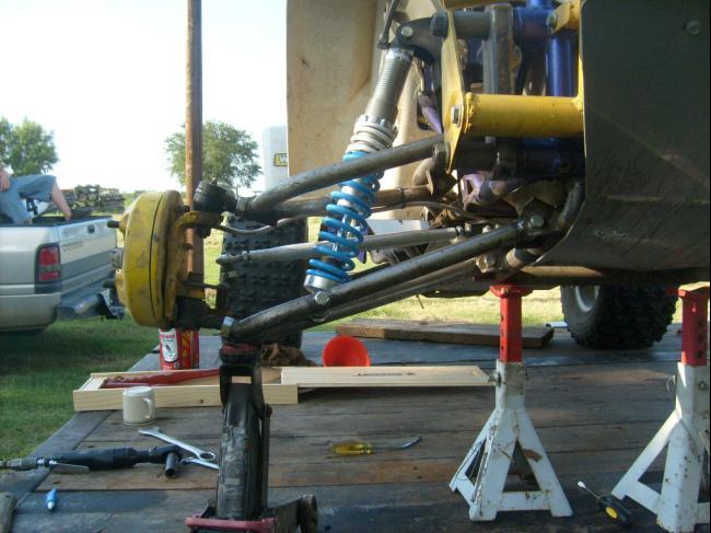

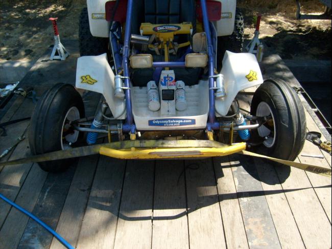

Yes. I been logging pics of the build and feel once the bump is fixed it will need to be adjusted to a netural steer and then dial in. The toe out on bumpis ok but not that much it takes it to an unsersteer on exit. The caster asjustment will dial in the camber when turning with out making a spring rate change in the rear. Instead of dialing in more negitive static amber you can dial in some caster. Since he tried stiffing up the front and it handled poorly in the woops a stiffer rate inrear may need to be in order to get some laterl wieght on rear and off the front. It's the turning where he is in trouble. The toe out in bump is good for straight line stability thu woops. Once the bump kit installed and the proper tie rod location are close he can dial it in to control the toe out in bump. When he shortened up the tie rod he made it worse. Alos the agressive toe out when whells turns in bump is alowing it to overrotate and lock. When you take some of toe out on bump out you can dial in negitive camber with positive caster. the more caster when turned will add negitive camber. Any way that's my thoughts on the caster or possible caster change needed. Also the uneven arms are very aggresive for negtive camber and the hub may even need to be rolled forward depending on set up. I also feel theres no anti dive built in like the pilot so a caster may be in order to combate the added compression on bump. This is why it may even need some positive caster taken out. Plus with to much caster it will require more input from steering to control. This is why I need him to test what I posted. When it rolles into cornor the the weight transfer side to side and rear to front toeing out to fare for the camber setting letting it over rotate and lock. I really do not like the bump stops hitting ball joint. The new bump kit will difently need a stop
Thoughts.
File comment: Too much toe out on bump. reduce and dial in caster for slip angle
File comment: the angle from upper to lower pivot. and the upper in not angled up. no anti dive built in to arms.

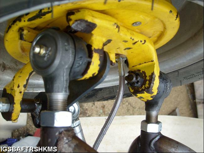

File comment: bump stops hitting balljoint.
