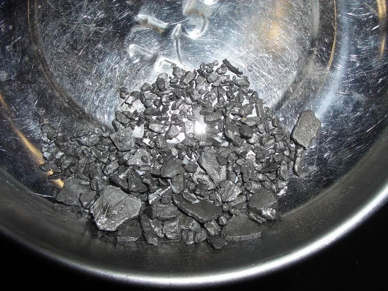

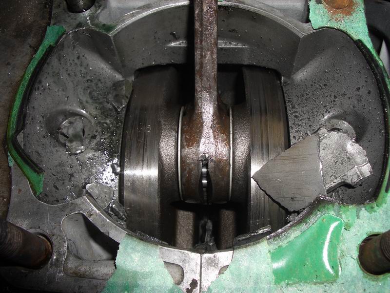

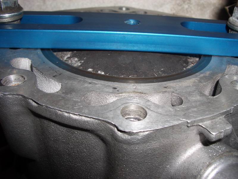

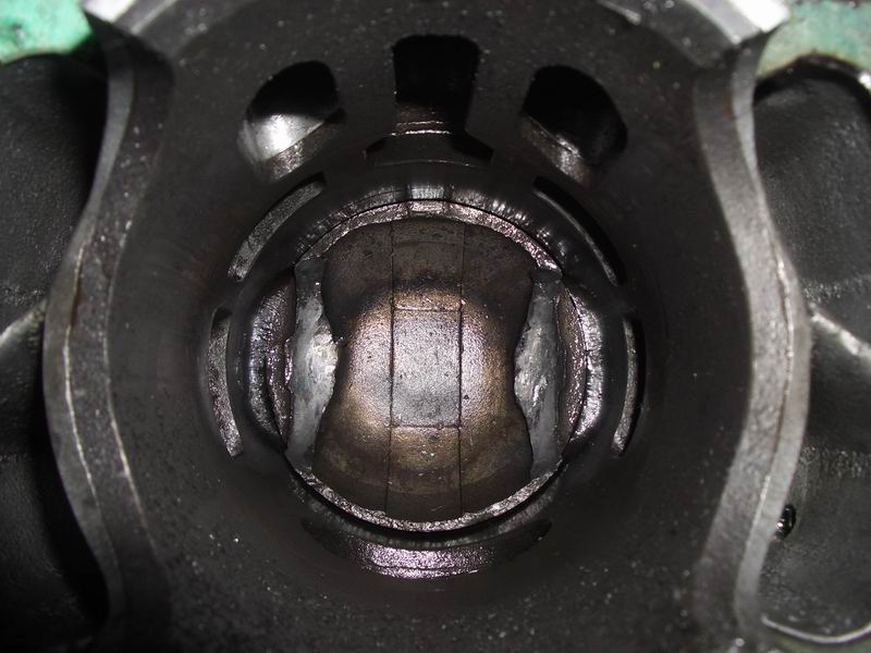

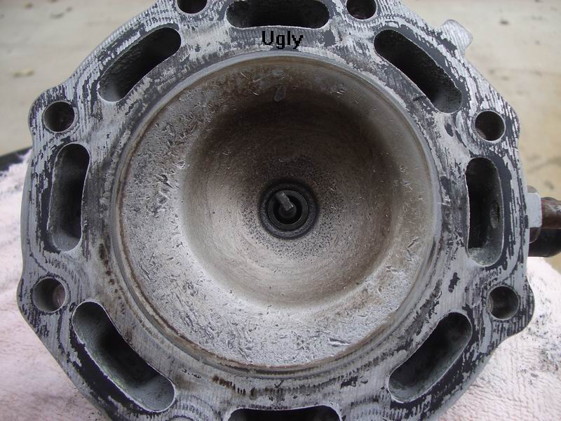

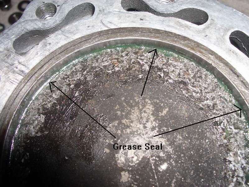

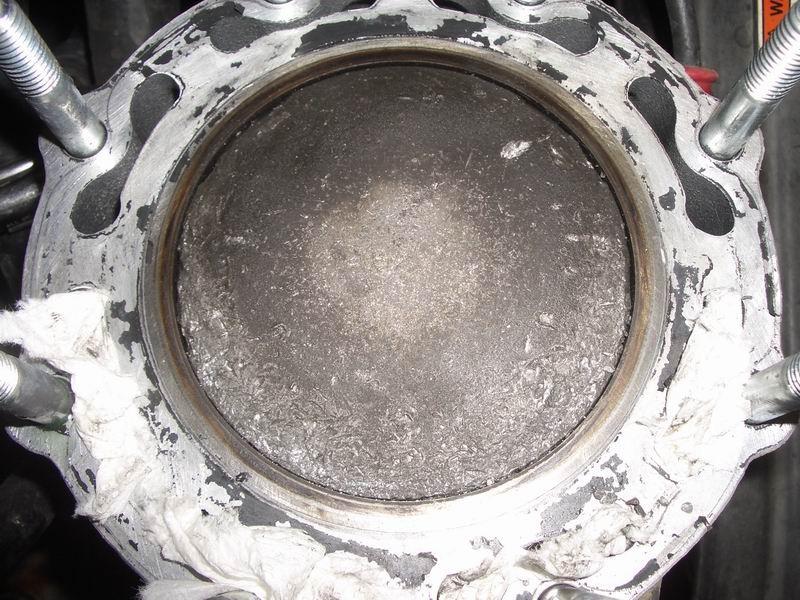

I went ridding last week and My Engine sounded like it had rocks in it. I shut it down and brought it home for some Fun CSI to see if indeed they were rocks. While I pulled the head and went UM.
This is what can happen over revving the Engine and not checking the piston more frequently. I just had to laugh as I tool it apart.
The piston is ( was ) an 80 mm arts ( oem). I think this piston had seen too many new rings and I missed the fracture or fractures oops. Good new not a lot of cylinder ,head or rod damage. I will no more upon disassemble. I swore the Engine was saying " no disassemble no". Darn Johnny 5 anyway.
So lets have some fun and do a few mods while I'm at it. Time to start making a PLAN using collected data.
Enjoy the ugly.
Upside view of jug with piston crown still in it.JPG [ 102.92 KiB | Viewed 7629 times ]

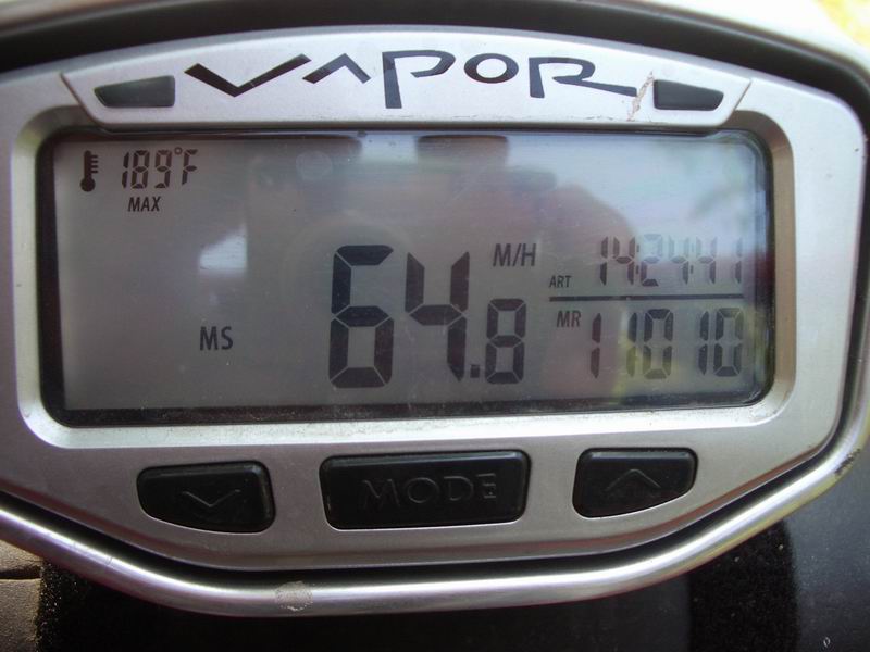

PostPosted: Mon Jul 05, 2010 8:02 pm
You know Rand I could change the number in the vapor and get mine to run fast than Turbos. Then mine will be faster. Thanks for the idea. Flawed data but good bragging rights. Yes mine is on the front tire on the trx spindle and mag pick up in place of one of the disc bolts. I find the vapor to be a usfull tool just like a compression guage. How else would I have known the after market belt was slower and allowed more over revs and a higher rpm and less speed for the same clutch setting. It soulded faster but was slower. I know I will sell Tubo those belts and I then will be faster.
PostPosted: Mon Jul 05, 2010 9:00 pm
This discussion made me go look at my maximum rpm for the trip Turbo and I took and found out it only registered a maximum of 6850. I think I might have to do a little tweeking on the ole Vapor. I think it's a little low. I did check my top speed pacing beside someone else but I need to check it with my GPS. So far it works great as an hour meter and temp sensor but I need to get it set up so I can use all the functions it offers.

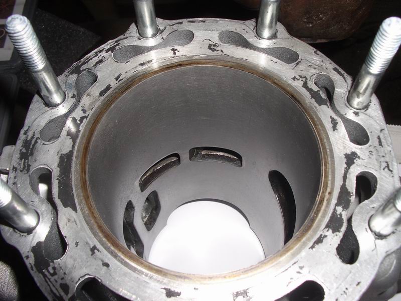

PostPosted: Mon Jul 05, 2010 9:44 pm

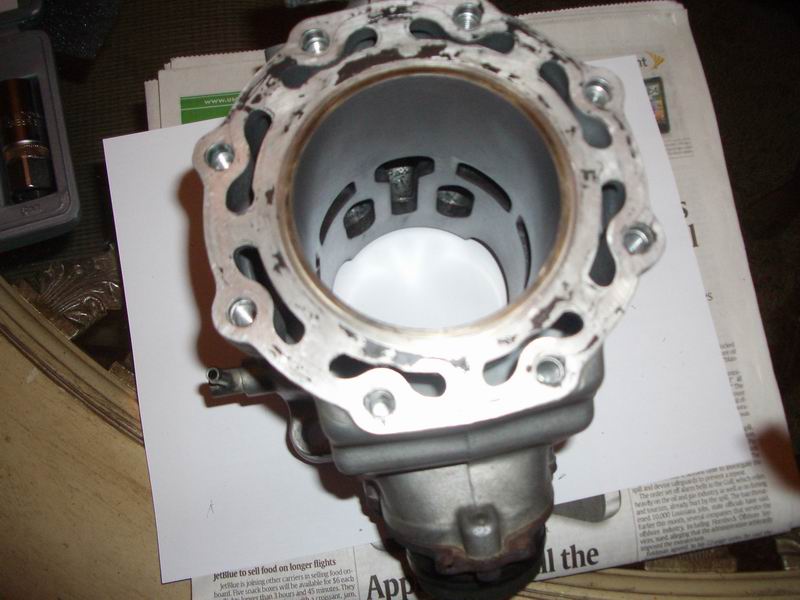

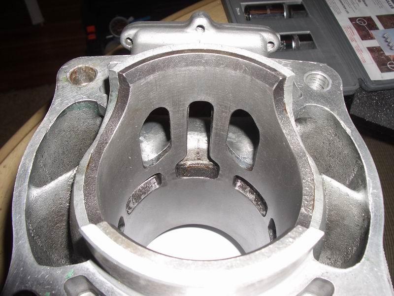

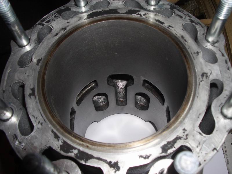

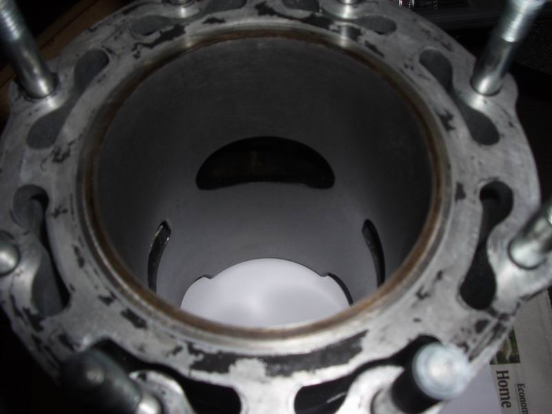

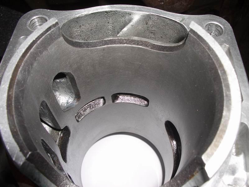

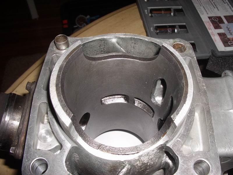

Well I cleaned up my cylinder a little to get some numbers. I already new it needed bored but thought I would go through the process for general discussion. I also wanted to see what the damage was and wear for hours.
This set of pics is the top view X and Y
PostPosted: Mon Jul 05, 2010 9:46 pm
This set is X and Y bottom view

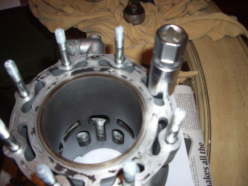

PostPosted: Mon Jul 05, 2010 9:50 pm
Time to remove the studs

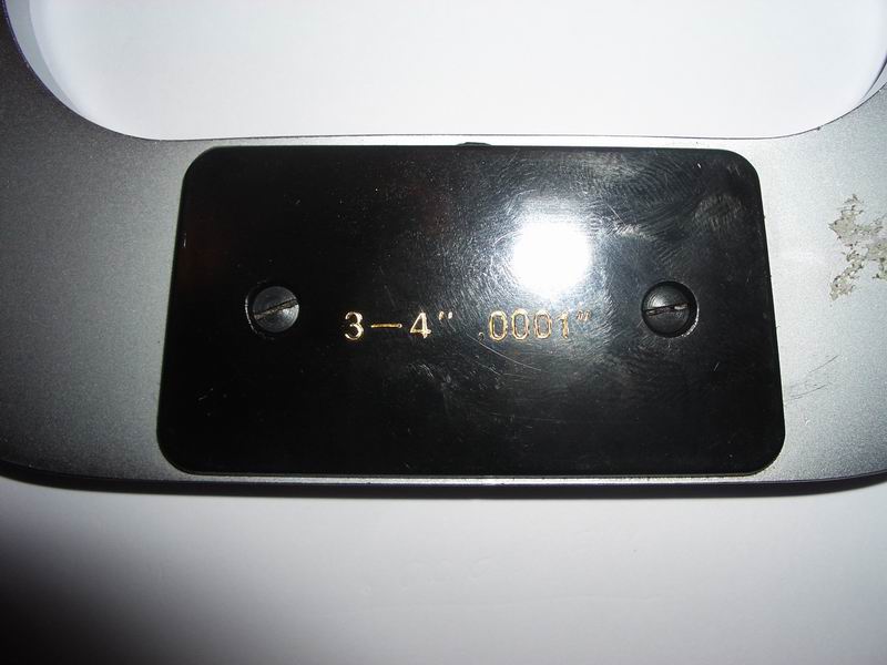

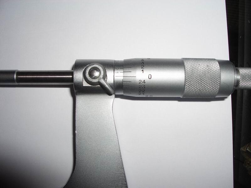

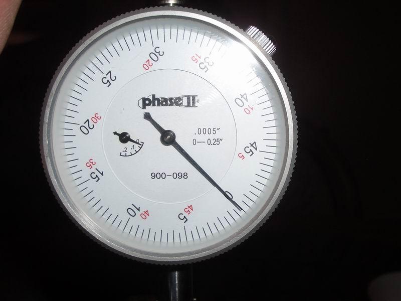

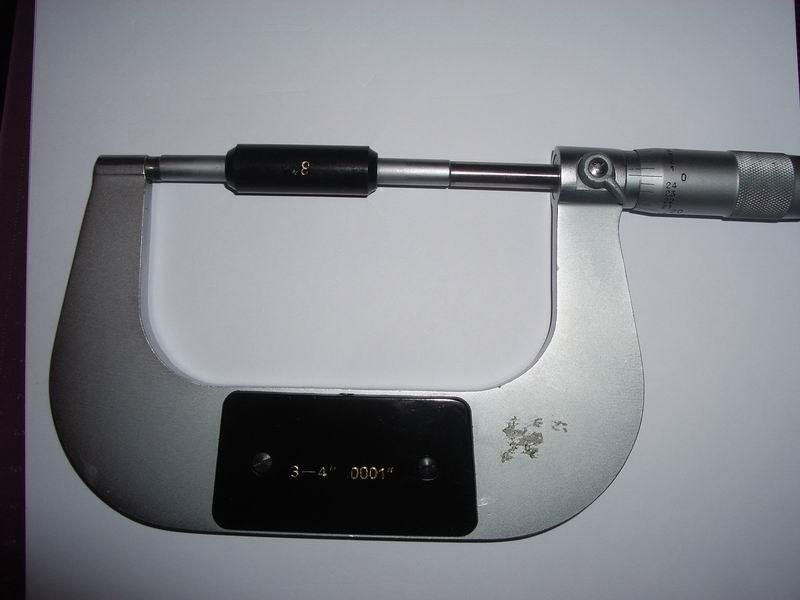

PostPosted: Mon Jul 05, 2010 9:56 pm

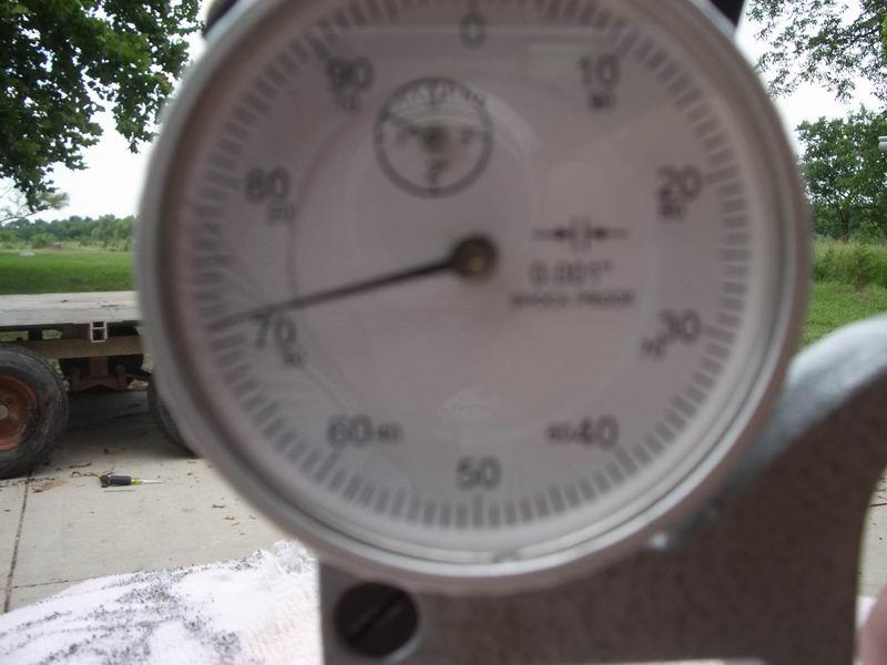

Now for some fun time to set up the bore guage for readings.
Setting bore guage 3.150.JPG [63.28 KiB]
Downloaded 324 times
PostPosted: Mon Jul 05, 2010 9:58 pm
Missed one set at 3.150 then insert bore guage and zero. Sorry
Setting 3.150.JPG [63.39 KiB]
Downloaded 368 times

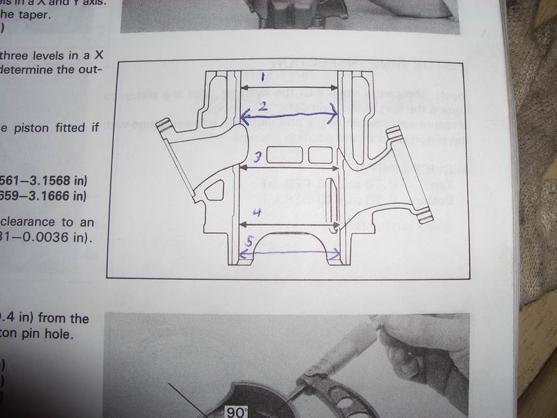

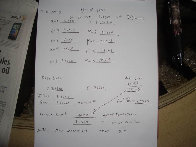

PostPosted: Mon Jul 05, 2010 10:34 pm

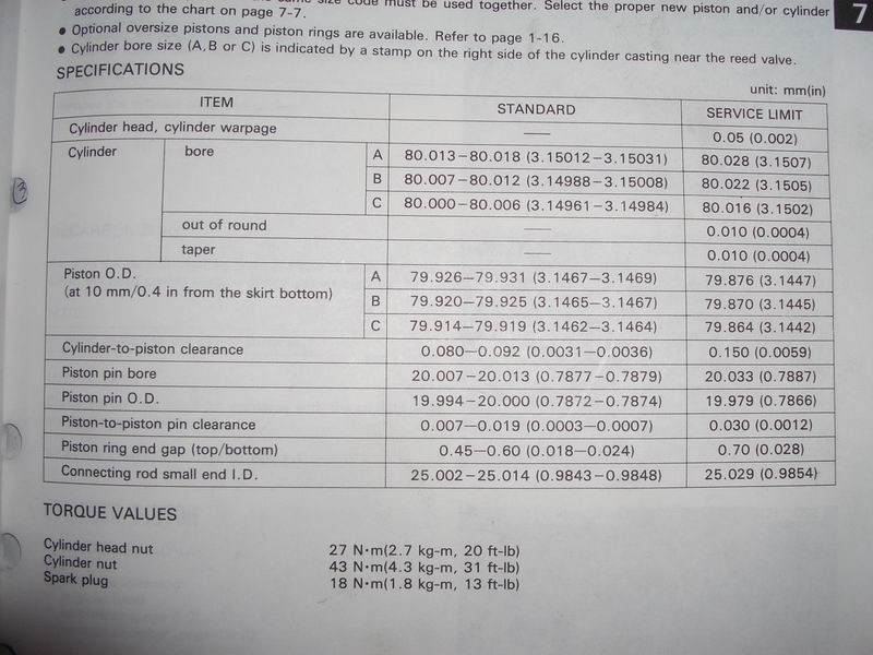

Time to get pen and paper and spec sheet and start measuring.
Oh MY, does it get any worse. It didn'nt look that bad, did it.
Since I only have the old piston numbers to compare it to ( not much left of the inthe bike) It should be real interesting and why you do not run a piston this long
The service limit on the bore is 3.1507 see spec sheet pic.
Even with the largest piston OD on the "A" of 3.1469+ service limits of piston to wall .0059 =3.1528 it would run with the bore at it largest of 3.1520
The Out of round is another matter. Service limit 0f .0004 and the base line numbers was .0005 out of spec by .0001
Now if we take the min and max it not so close. Min# was Y-4 at 3.1505 and the Max# X-5 at 3.1520 now its out by .0011. How about that taper. Need to go back and check Y-4 again just does not look right.
While I beter mole over the info and put into the dcp peed sheet for comparison. I also have another cylinder with about the same time which I will clean up and check to see if the results are compariable in the wear areas.
WHer I'm gona measure bore and get out of round #.JPG [ 98.17 KiB | Viewed 7629 times ]

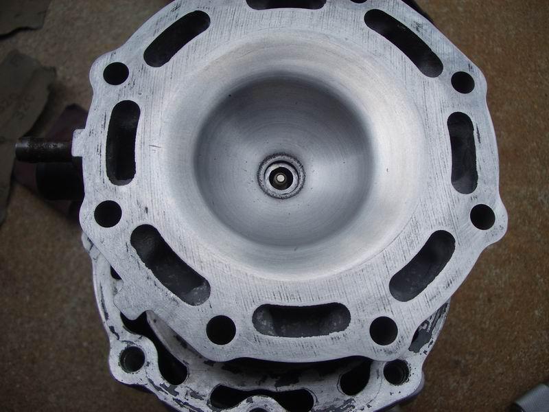

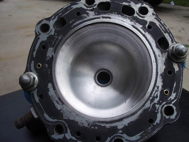

PostPosted: Sun Jul 11, 2010 9:17 pm

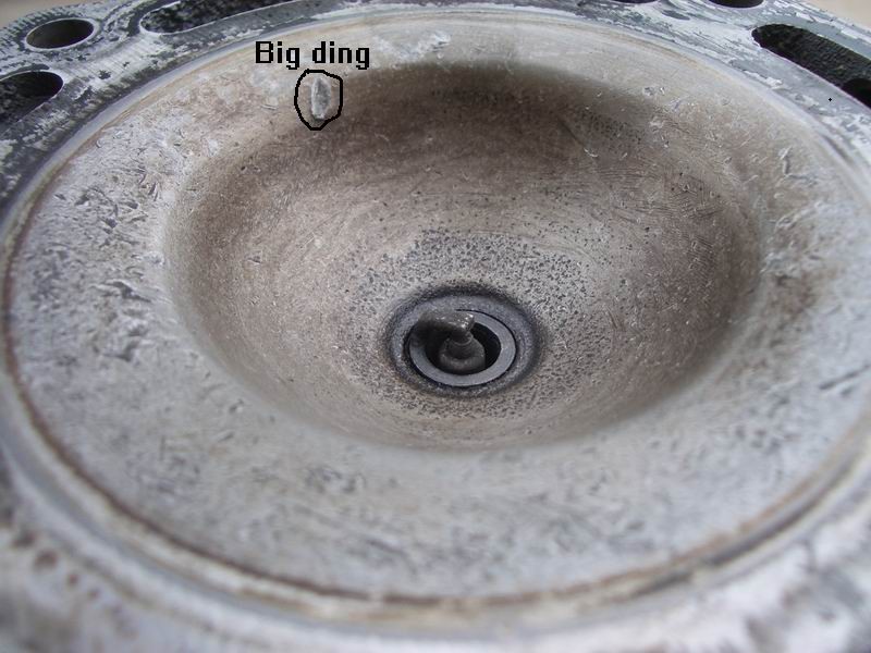

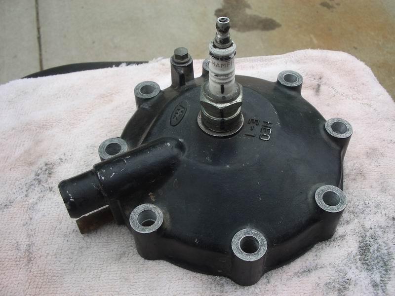

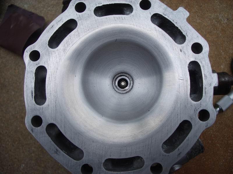

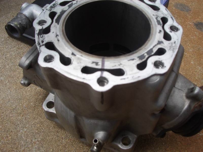

Well had some time to take a closer look at the head, Yuck. So I cleaned it up a little and did some testing and mesureing for a .25 over rebuild of the 80 mm cylinder.

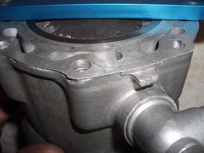

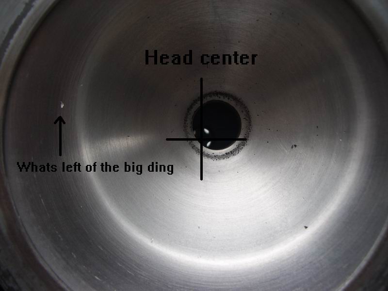

PostPosted: Sun Jul 11, 2010 9:22 pm
more pics

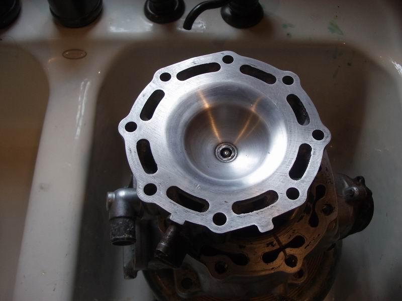

PostPosted: Sun Jul 11, 2010 9:29 pm
more pics

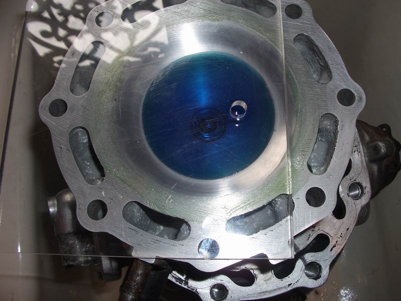

PostPosted: Sun Jul 11, 2010 9:37 pm

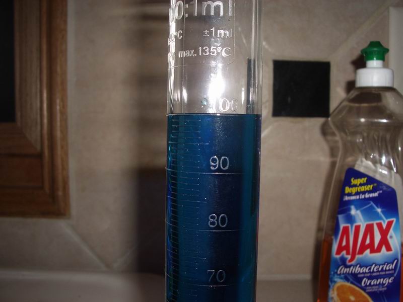

"H" Good question, I think I will let the board decide. I will rework this Engine for a spare if new power plant goes in. I plan on testing this Engine with a thought I had a while back using a programer. Don't know yet to many choices. What would you like to see.
More pics of the cc and plug.
Flask full for new cc measurement 100 ml's or cc's.JPG [ 77.78 KiB | Viewed 7634 times ]

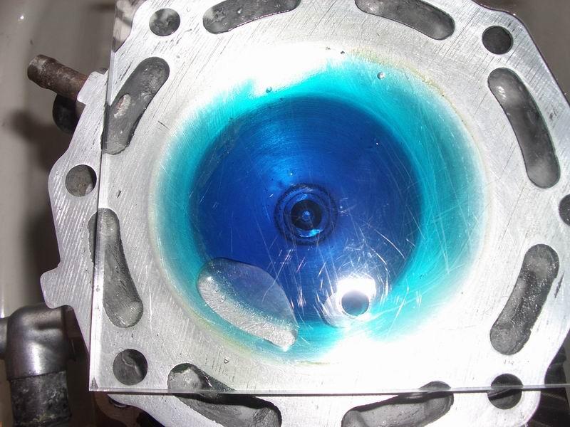

PostPosted: Sun Jul 11, 2010 9:55 pm
Ok looks like the New DCP head is at 49cc's with the combustion chamber at 29.5 cc's and will get entered in the DCP work sheet for CR of a .25 over arts set up. I will measure the crushed thickness of the head gaset to enter into the spreed sheet as well as the internal dia for for cc's Now lets take a look at the gernaded piston plug.
File comment: .028 inches .71mm thick
81.13 dia
Total 3.68cc's

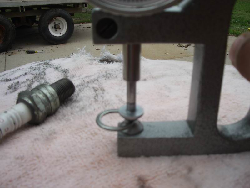

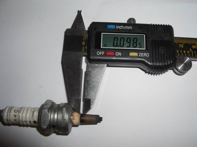

PostPosted: Sun Jul 11, 2010 10:08 pm

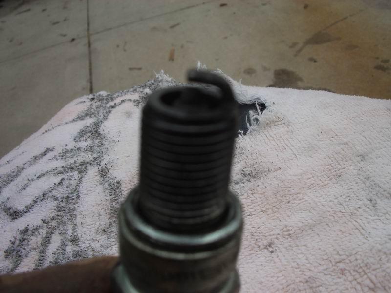

Plug pics. The plug measurd up a little lean still ok but I should have correted when I noticed it a little lean and running a touch warm. The Engine temp was ok just felt lean. One should always listen to the little voice in there head. A simple one more clip would have corrected the touch lean condition. This in part with other factores contributed to the destruction. It does show I had ring seal right up to the piston breaking.
PostPosted: Sun Jul 11, 2010 11:04 pm
Now I have the nw head data and teh gasket data It's time to collect some .25 data for the new Cr and any correcton that need to be done. What I did was take a .25 over cylinder and old piston and installed a copper wire in the ring grove to hold it in the cylinder and install a flat bar across the cylinder to put the crown of the piston at the top of the cylinder deck. Then I put a grease seal in the land area and measured the distance from the crown edge to the top of the cylinder deck. Now I can cc and calculate a piston crown vloume and use this information in the spreed sheet for CR.
Pics
Copper wire in ring groove for seal with greases around crown edge.JPG [ 102.01 KiB | Viewed 7563 times ]
