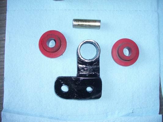

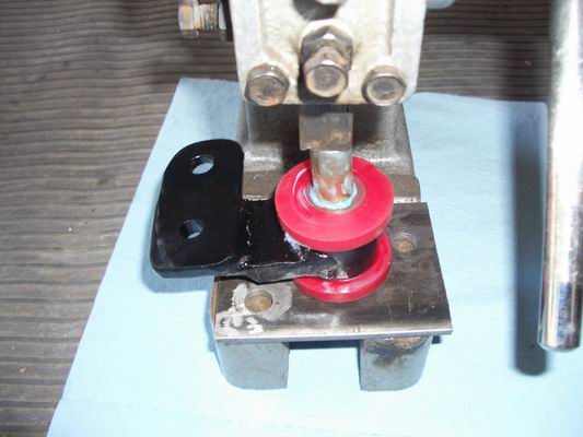

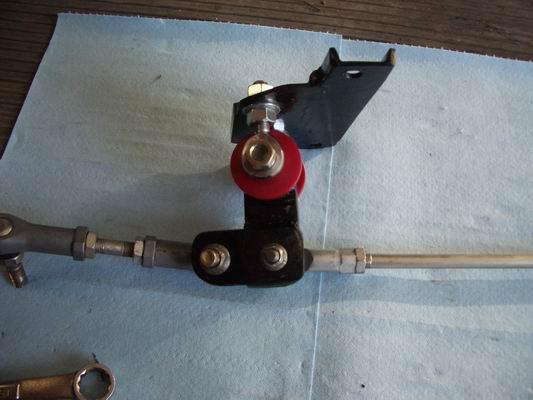

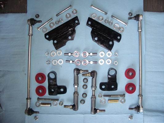

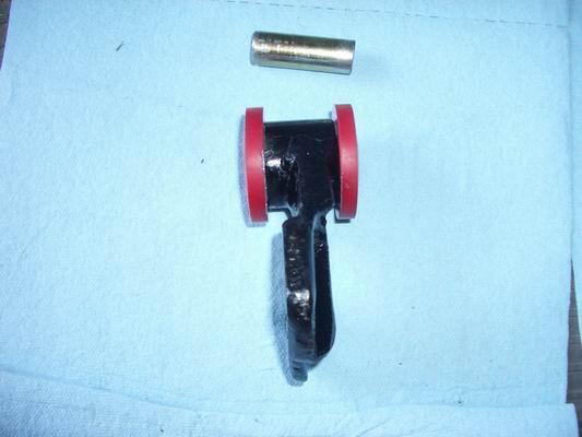

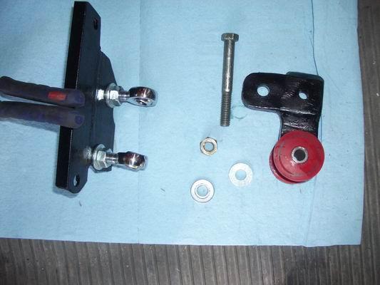

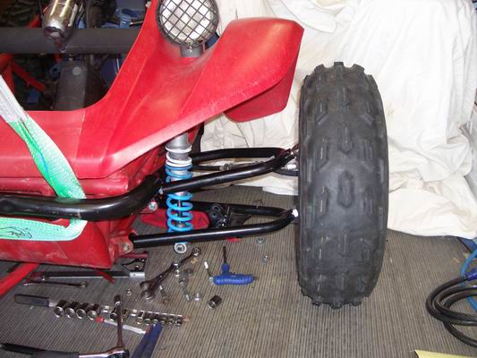

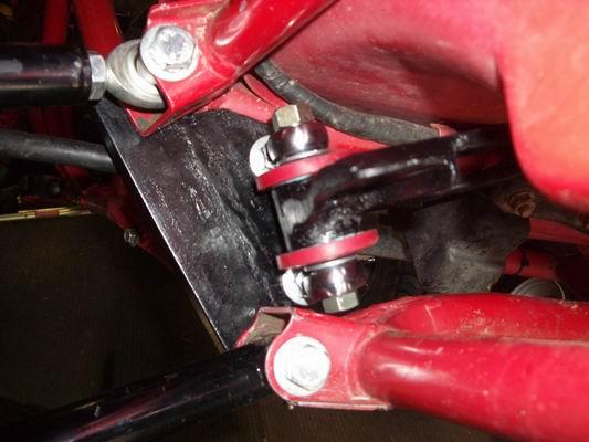

It's not atvr but its back yard hacker type kit. I should call it low budget. Ok, real low budget. I know "H" likes pics so here you go.

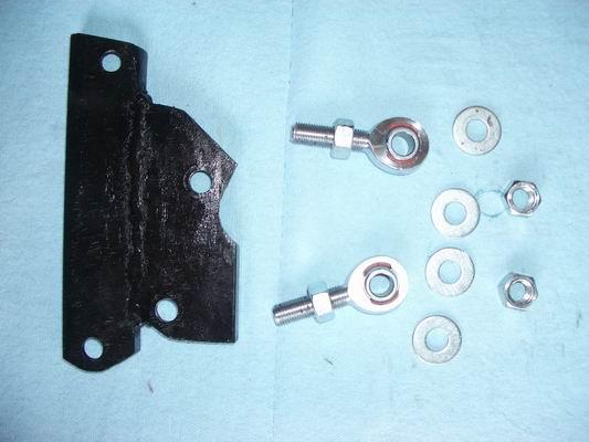

PostPosted: Tue Sep 30, 2008 7:57 pm

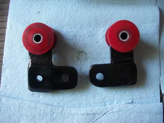

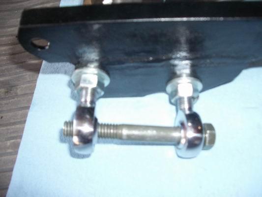

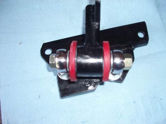

more pics

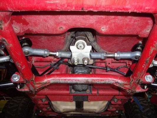

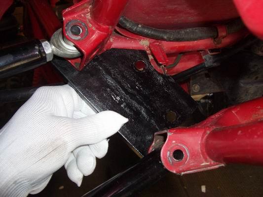

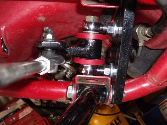

PostPosted: Tue Sep 30, 2008 8:02 pm
more pics
Idler mounting plate in place, bolt to rear a-arm brackets( tabs).jpg [ 70.63 KiB | Viewed 7093 times ]

Yes widely available. I used a set from Rancho. Once again I tried to use part I could find on the fly and is common. In this case it is a Chevy front spring eye bushing found at any off road shop. The part # is RS971 It is 1-1/8 " OD bushing with a 7/16 ID sleave (sleve= the steel insert that goes into the poly bushing). I just cut them off to fit my bushing. The external bushing I used is found a any farm and ranch supply. It is a tractor 3- point linkage part. The part # is Speec co-B8312YBU, lift arm bushing. This piece is is 1-1/8 Id and 1-7/16 OD. the poly will push in then once the sleve is installed it gets nice and snug. I also cut it to size. I then welded the tie rod angle piece right to it forming the idler arm. I used grade 8 bolt and lock nut thu sleeve. I used 7/16 chromoly hiems with teflon inserts for support to flex bracket( backing plate) they will self lubracate and are cheap to replace and easy to find at any stock car race shop,buggy shop ect.
I should also mention if stock and stock works are used no bump kit is needed just have new tie rods made or do a "H" mod and lenghten. You will experence some feed back in steering with a non bump kit thu. For experminting with tie rods get some wooden dowell 7/16 and use a right and left nut to semi thread and then use for mock up. Saves time and money. I used stock Honda tie rods for kit. The short ones are 400 ex cut and new right hand threads added. the long ones are stock leenght trx 450. Rember mock up is no load steering( jacked up on stands). I have ordered a long set and new HD for my mod. You should be able to find 12 mm right hand die at any speciality tool store. mine cost $6.00. that is why I cut the right hand thread side off and then rethreaded so it would twist out the tie rod end for adjustment. The additional right and left luts can be bought at honda shop. I used stock honda pilot for short and trx 450 for long since I used a trx set up. Once again finding parts on the fly for repairs.
Please rember if your trying to duplacate this is an unproven set up with only three hours of testing. If you find a way to improve please share.
Note on binding: If you extend the idler to far forwrad it will bind steering prior to full stering lock. I am working on new revised set up to add a greater margin of error. I pose a thery of shiming the flex bracket back via spacer. This will help but also creates addtionl stress on tabs. In order to reduce stress I will build offset flex plate and test. I will install thermal snensor on flex plate to get flex plate heat ( metal get hot when bent / flexed from monclule displacment)reading at tab and idler mounting hiems and convert to BTU to measure stress. I will use the #1 flex plate as a base line for the revised flex bracket measurment to determine if any additionl stress is encountered or created.
I know babble babble babble, sorry.

Thanks for the help and tips. I spent four hours yesterday on front end. I did try moving the outer rod out in line and found that it made it worse. It lacks about 1" from being in line with pivots. It sounds like time for a total redesign. If 2" is the max I will use it as a guide for proper fit. I changed the angles of hole,location and holes and positions. As well moving bracket from first location to + and - 1". The further forward the worse and back and 1/2 a little better. I wondering if the trx arm on there has a bearing on it and hole new design will be required or change arms. I,ll give it a couple of days and doodle. So for know it get a thumbs down and I will work from there. Please keep the ideas comments comming.

16 hoours later I have this to report.
Well I tore it done and set it back to netural ( zero) and started over. I move the tie rods in line and it was worse. I could only get 6" of travle before it started to toe. I tried three difference elevation on the rod to confirm it was not the rod angle in relation to vertical as well moved it forward and back three inches to see if it made a difference and it did not.
So I took a new approach. When in dought check it out. I put 450 on stand and started collecting data for comparison. I found that the 450 toes in and out as well when it reaches it full extend and compression. The interesting thing was as it reached full compression it started to toe back. So I did what most would do and try to duplicate it on the conversion. I found the the rod angle forward +2 and down -1 and the rod lenght ball joint to joint -1/2" achieved the same reaction at 13 " of travle. I locke down the idler and ran thru motion. The #2 idler was changed to meet this configuration and the next herdle to overcome is the steering quickness. it to fast. The whell hit the arm before the steering arm hits it stop. The stop lacks 1/4". I played with the lever ration on the idler and found no matter what angle and ratio I used it achieved the same action. The inner tie rod is in 2.5 inches for pivot center line. I believe its due to the geo of the trx arms so the pilot atvr long travle set up will not work . On the plus side the front turn in quickens and try to match the other front turn out.
How to resolve. I will build a working modle scaled down out of popcicle stick and drill holes in modle to to adjust using pins untill I achieve a desiderd result. Not good at math got to go old school. I also did comparison on steering stem and the tie rod end spacing is different accounting for the wheel lock issue. I have considered makeing a change to the steering stem but want to keep it all bolt up orignal. I do have old wore out stem for resurche and modafacitons.
Yes I will post pics of my school project. I'll even get Dad to help. Elemrs glue and popcicle stixs. I wonder if I could get Drakman to sell me some ice cream out of the Tiger hauler for project.
Final note on toe. The toe change as it rakes is pretty cool.

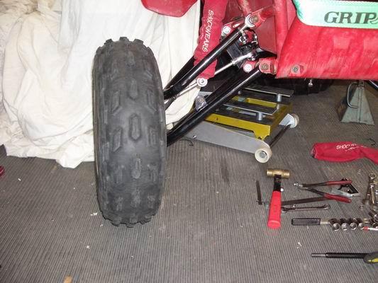

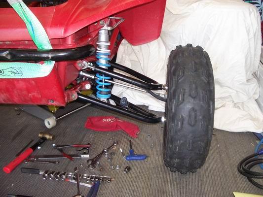

PostPosted: Wed Oct 08, 2008 8:29 pm

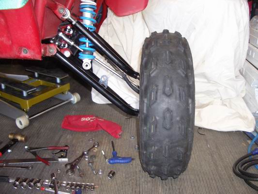

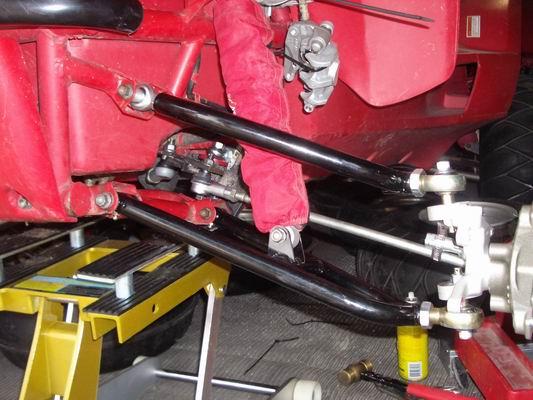

Ok thought about a for a day and bought new gloves. I rework the left side and fixed the issues with old kit. I can know after rework arms and kit get 16" of travle. Yes I said 16". At 16" it bindup the ball joints and tie rods. I called my shock supplier and they have not made fronts yet so I changed the stroke adding 3/4" which will put me at 13.5" in front. I have some pics for comparison. Left side fixed right side old kit. I will do right side next and test. I also solved the wheel lock issue not allowing the steering stem to lock before wheel hitting arm. This rework cost me 6hr and one nights sleep. I hate it when I mess up. I do feel it worth it. I still have to set up caster and camber on new kit. It's a good start. So heres the pics.
PostPosted: Wed Oct 08, 2008 8:33 pm
some more comparisons
PostPosted: Wed Oct 08, 2008 8:39 pm
Side note: look at sag and droop pics follow tie rod inward and see where it was relocated future in bound and down as well as forward and changed to ratio on idler. Once tested I will make new idlers. I hacked up the old and welded on new configeration. I will also post paper work showing measurments and angles and relation ship to arm pivot points. Please feel free to add comments if I can improve. Thanks Rich.
PostPosted: Wed Oct 08, 2008 8:41 pm
oops! in, up, and forward. Sorry. I also rotated inside ball joint 180 deg
