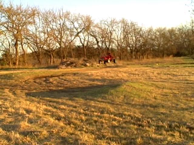

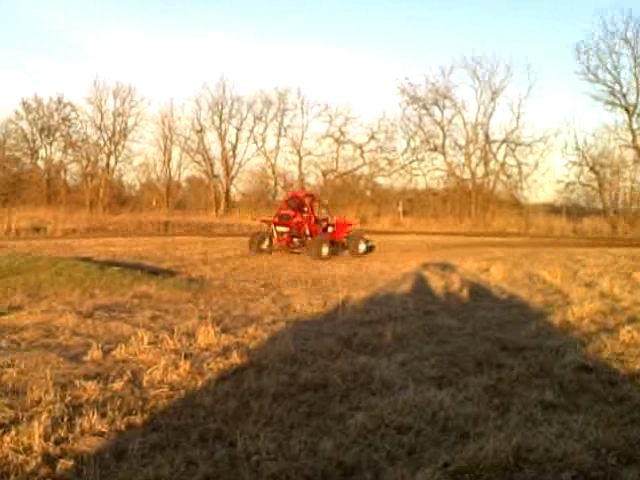

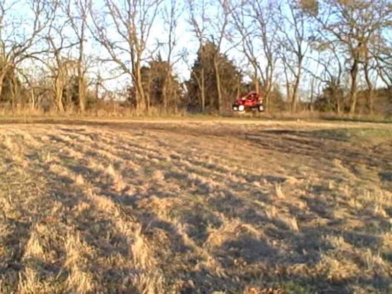

I did get just a couple of teaser shoots. #1 is power thu mid and #2 is next frame. The best ones is 3 thu 8 which this is where the computor said oh no you don't.

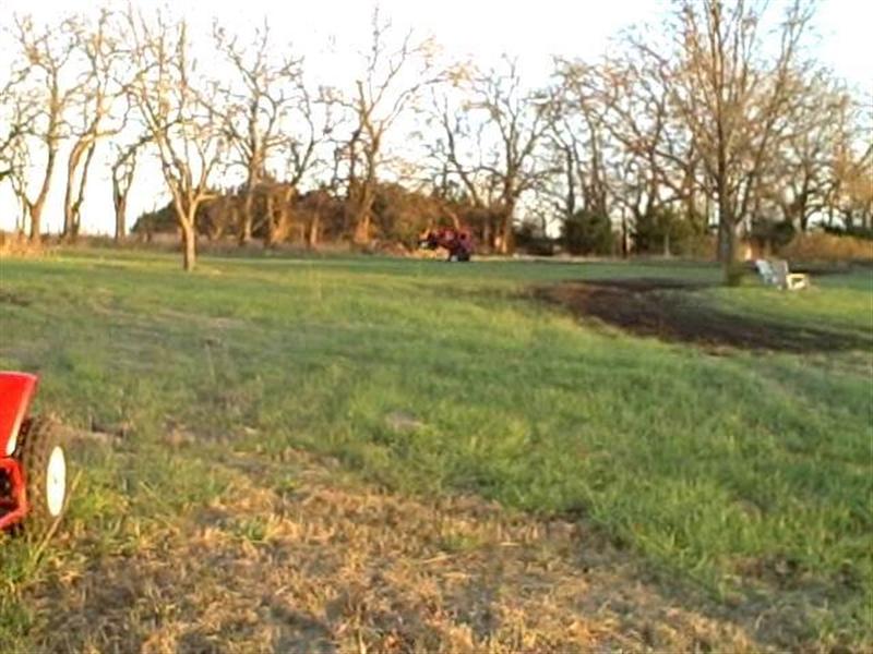

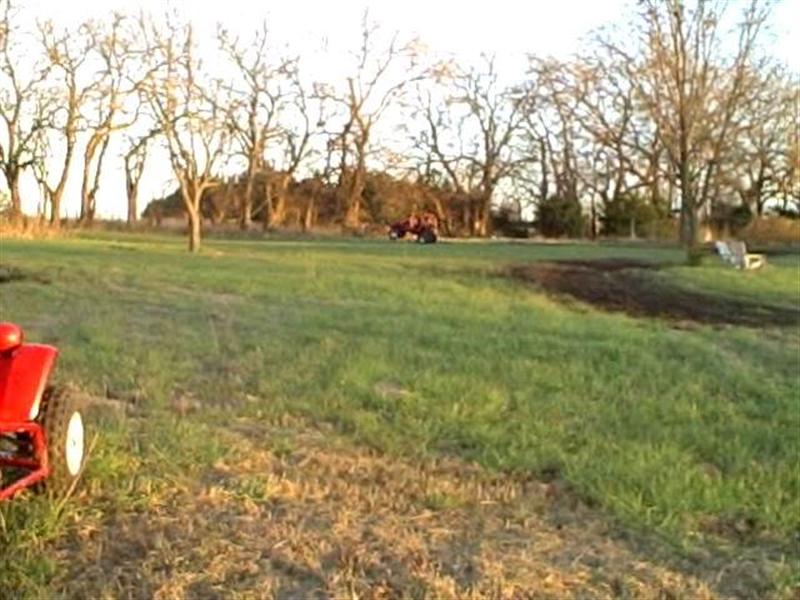

couple more

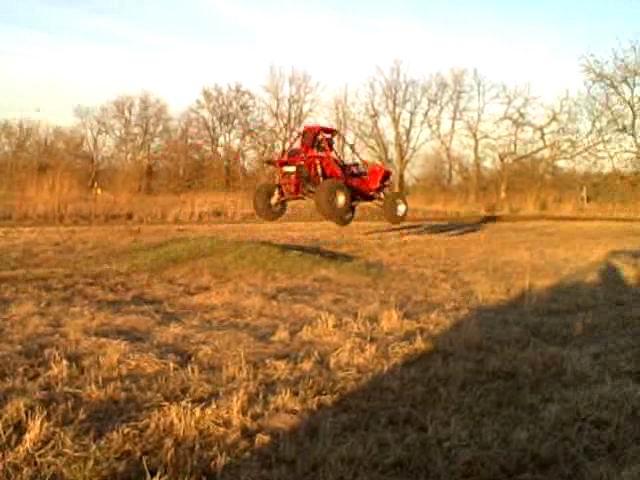

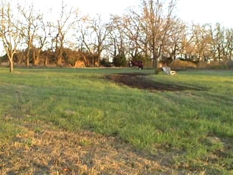

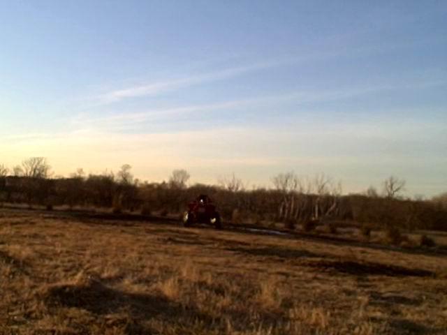

fooled the program into doing a few more pics

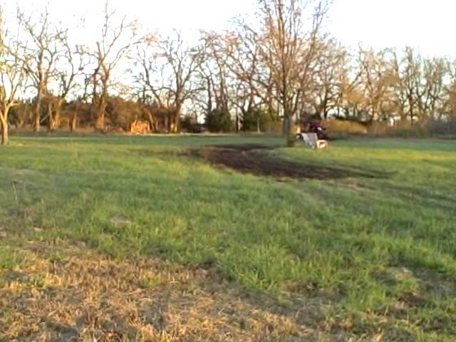

Ok squeeszed some more out of it. I sure did not like the noise my lap top was making. Thes are pics of low speed compression settings to soft. I was on the power at entry and all the way in and thu. I tought for sure this was rinkel the palstic. As soon as I felt it role and the seen the dirt fly I new it would be fun.

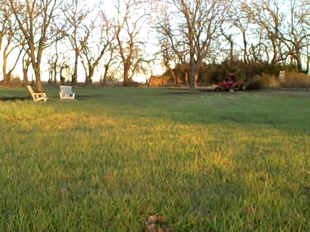

Heres #7 . If it wasn't for the rebound setting on rear the rear would not have settled alowing it to tip right over instead it rebounded and push it back on two wheels with front staying in the air on the power. Gotta like these shocks the old works would have just rolled over. I was kinda surprised to see this out of a linier spring.

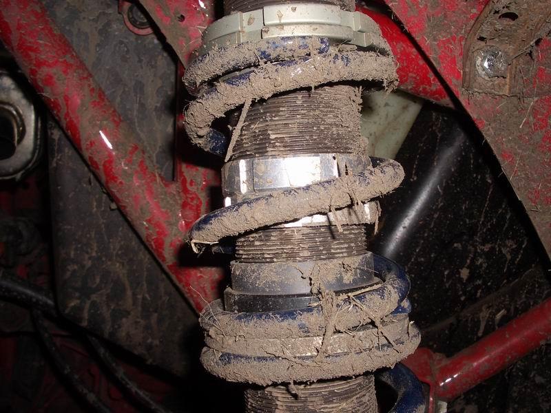

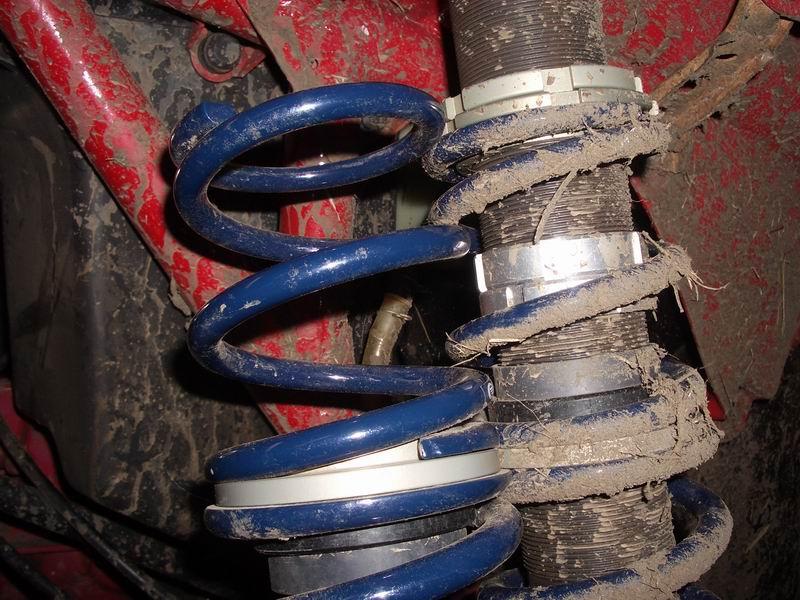

Ok went to garage to look over rear shocks. Issue being low speed entrance kick and launches funny. When entrering rollors or woops if it kicks after compression adjustments there is two thing s to look at first. #1 transition spacer and #2 rebound adjustment. If rebound is to fast it will kick the rear on entry and will effect take off. If the transition to tender spring is to quick this will also effect this or a combo of both. So I removed the left rear and disaembled and took measurments. First counting rebound clicks from base line each way. and then measure the distance from preload spaner to crossover spanner. Thes are base line for adjustments in case I really screw up setting to start back at zero. The rebound clicker was 36 clicks out from full slow and 20 clicks from full fast. I will set and mid point to start with 28 clicks. the transition spacer was set at 3.205 inches from preload spanner and pre load after check was at 24% with 180LB in seat I used two 80 Lb cement bags and two 10 lb weights lbs and got measurement I weight 170 so its close for this base line. One thing to mention about rebound is If rear kickes on entry slow down the rebound and if it kicks after a few hits ( this called packing) you quicken rebound. The rear is staying compressed causing the rear to swap side to side until you slow down and the shock catches up. I enjoy watching this at the entrances at LS to see who has it right. Now that's fun while you enjoy a cold one. All the power in the world what help ya there.
Now that the left is measured up I went to the right side and strated counting cliks and MY phone rang. Yes the wife calling me for dinner and as I leaned my head over to hold phone My eyes caught this. See pic. Can we say what an idiot and I'm the idot so plese feel free to smack me around. A big shout out to the Wife. Thanks Dear. I will correct before testing and will still change transition spacer allowing to stay on main longer and slow the rebound a little until kick on entry in gone or new springs are in order.
Told ya I thought there was diff in the way the shocks loaded and unloaded side to side. I 'am glad common sence took over before the double. Guess I'm not chicken but did not want to buy new plastic. This is a prime example of why you adjust one thing at a time and make the same adjustment side to side. Other wise I would have chased this and never got it right and wondered why.
File comment: Guess whats wrong here.
File comment: If no luck on guess look at this for comparison. I know what an Idiot.
PostPosted: Thu Nov 20, 2008 10:32 pm
I don't see it???
PostPosted: Thu Nov 20, 2008 10:58 pm
Posts: 539
Location: Nebraska
Up or Down - Heck ya had a 50/50 chance of getting it right :-)
BTW - Nice catch...
PostPosted: Thu Nov 20, 2008 11:34 pm
NOw that's the kinda fixes I like to repair
PostPosted: Fri Nov 21, 2008 11:59 am
Turbotexas wrote:
I don't see it???
Still don't see what was wrong???
PostPosted: Fri Nov 21, 2008 2:45 pm
Posts: 533
Only thing I see is the upper shock is compressed more than the one that's not on the machine?
PostPosted: Fri Nov 21, 2008 5:07 pm
Joined: Sun Mar 20, 2005 11:46 am
Posts: 158
Location: michigan
The spring from what I can see in the second pic, was installed upside down. Am I right? Did I win anything?
Jim
PostPosted: Fri Nov 21, 2008 5:43 pm
Joined: Wed Jun 04, 2008 10:34 am
Posts: 90
Location: Southern NH
I'm a little lost with what is wrong as well. The two side by side springs look the same to me. The orientation of the spring wouldn't mean anything would it? The spring rate is the same no matter what direction its being compressed from?
PostPosted: Fri Nov 21, 2008 5:47 pm
Posts: 90
Wait now I see the black plastic thing is upside down, but I'm not exactly sure what that is for so I don't know why it would be a big deal?
PostPosted: Fri Nov 21, 2008 5:53 pm
