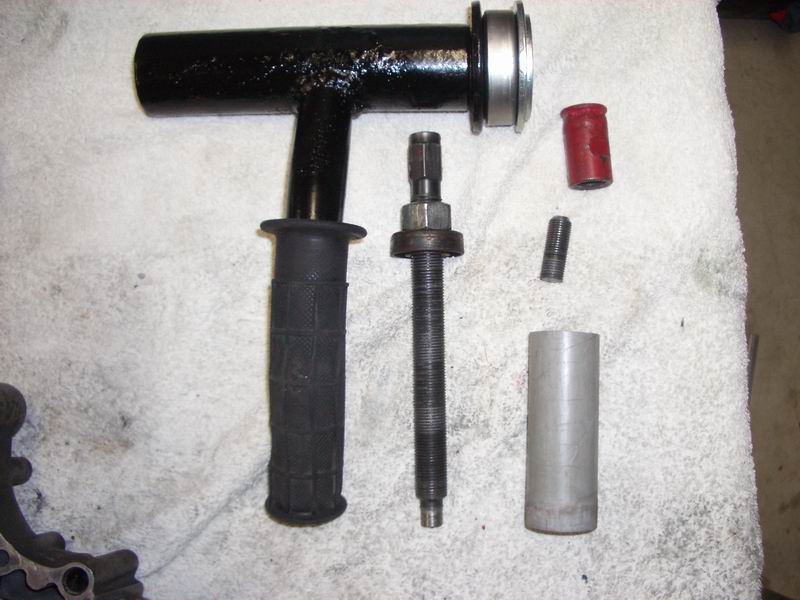

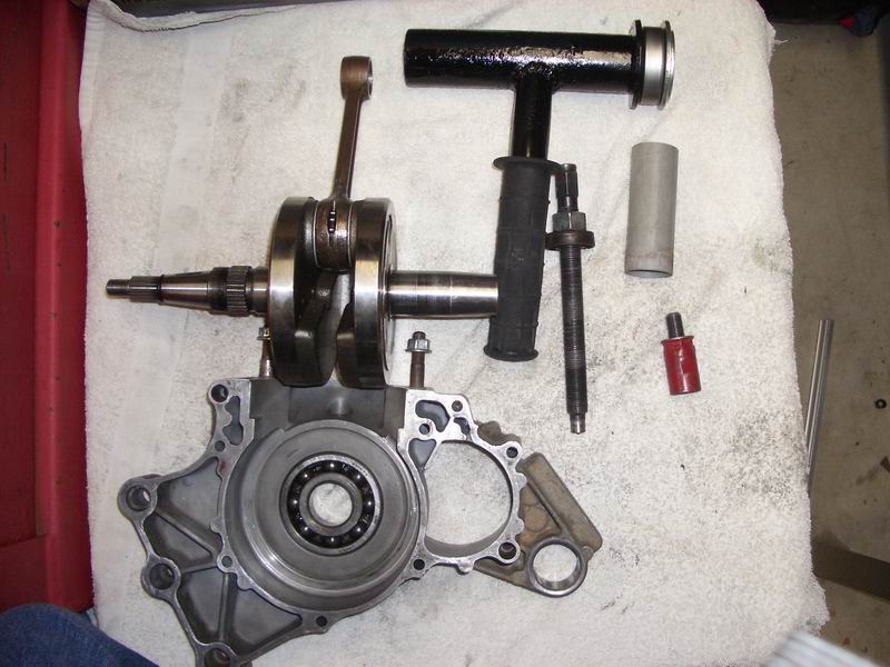

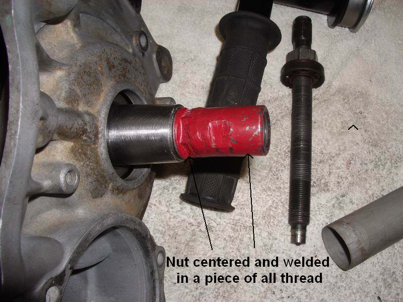

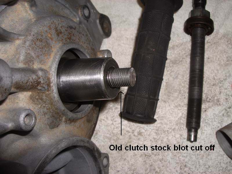

I thought I would share my Hacker tool I use to pull crank into cases and pull case together. This made of parts laying around garage and the only specail part is the puller bolt which most have with the bearing puller sets. In the pics I used and old crank and case halfs just for mock up pics. Since there been a little sdiscussion on bearings I thought I would post up. In the book it showes a similar device with no real detail. This puller allows one to only apply presser to the inner race as its pulled onto crank and prevent beraing and crank damage just like in the book. The cost of the puller was Zero for me since I had all the parts laying around. If parts were purched it would cost around $20.00 with out the puller bolt.
Note: There is no paint on the end on the puller tube. I do not want paint flakes in the bearings. Metal to metal with a light rub of two cycle oil.
Crank in case SEE THE MISTAKE rod not supported and centered.JPG [ 102.11 KiB | Viewed 5315 times ]

File comment: This is a piece of 1" sch 40 pvc tapered to fit both ends of crank.
It fits inside the puller tube

File comment: This is to show the puller bolt asembly which can not be seen once the sleeve/tube is installed
Adapter and puller bolt in end of crank Clutch side.JPG [125.47 KiB]

This is a hacker 2 due to the first one I made turned on the bearing face instead of just setting on the face. It worked ok but this works much better,smoother and more controlable. The head bearing and nut bearing allows for much less friction when turning and take all of the rotational force off of the tube.
