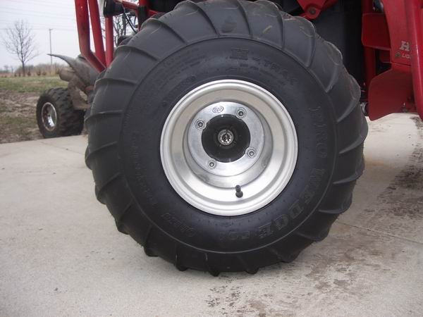

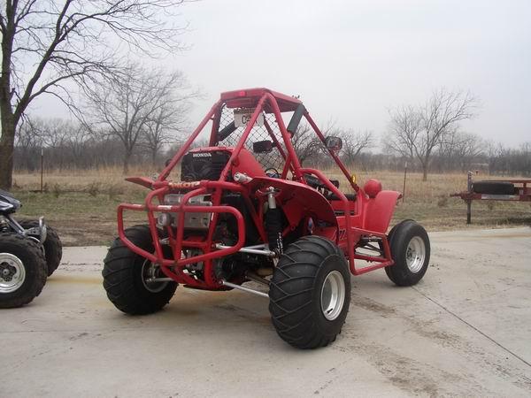

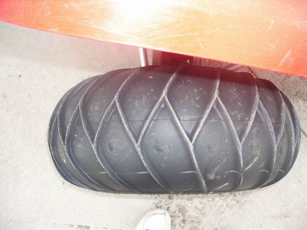

Hers is some pics with the prowedge on wifes

I have seen these on Richards Pilot and he had full control, was able to keep up with the tigers and spit sand all over my little ol ppe (purple pilot eater) I might try a set of these when my side winder paddles I have now wear thin... the side winders worked well today at buttercup dunes in California!!!
