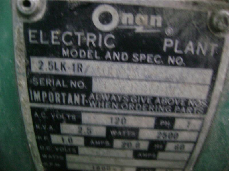

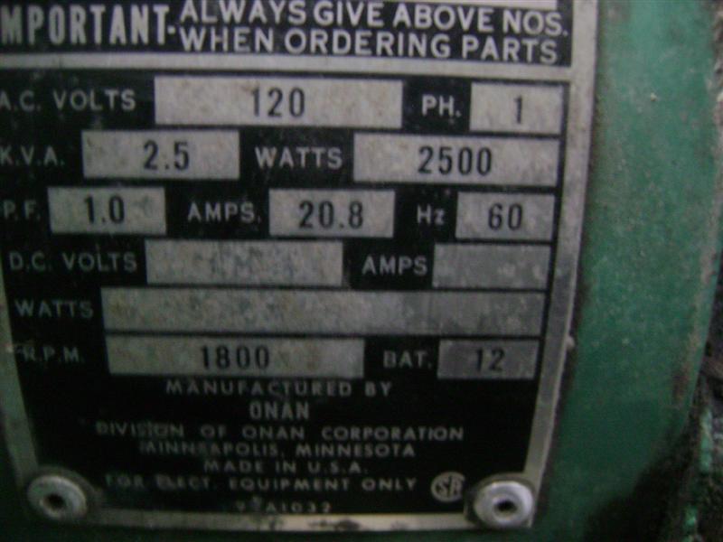

Coach battery was completely dead recharged it over night seems to be ok thought it might have froze since it had 0 volts, this tells me their is a slow drain some place gotta track this down.
Reinstalled the battery hit the generator start switch and it didnt want to turn over well, first impression was a bad connection some place kept trying it and finally it started cranking over, but didnt try to fire, manually played with the choke linkage and throttle linkage by hand got it to start up, runs great, starts great when restarted, letting it cool off a few hours to see if it will start again without manually choking.
It runs but everywhere I check in the coach I have no 115v power, time to get out the manual and figure it out, maybe it has a auto change switch that is not working? Cant find one, my old RV had a cord you manually had to plug in, when you were using 'shore' power you plugged it into the outlet at the RV park when you wanted to run off your generator you plugged that cord into an outlet inside the RV where you stored the power cord.
Its raining too hard and too cold for me to track this down at this time, I opened the door where the 'shore' power cord is stored and see the plug laying their not plugged into anything the compartment was too small to see if their was a outlet inside to plug into, didnt want to drag the cord out in rain will mess with it another day.
Hour meter says 926 hrs on the generator, when it started it didnt smoke and the exhaust don't smell like its burning oil it did blow out a bunch of soot on the snow from the exhaust like it might have been flooded at one time or is running REALLY rich, once I get it producing 115v I will plug in a few electric heaters to really load it up and let it run a few hours at close to full load (2500 watts) then will see what the spark plug looks like.
Forgot in last post Drakman my generator on the bus sips the gas it was designed for fuel efficiency, before I park I usually top of both gas tanks I have the generator on the 40 gallon tank, when I move I usually go back to the gas station and top off everything, I run the generator all I want when ever I want and in 5-7 days it will use about 7-10 gallons at least this year it did I ran the electric heat quite a bit since it was cold the whole time I was out west this trip, think I had one day it was over 70. http://www.poweredgenerators.com/guardi ... -40RV.html
Fuel Efficient: Up to 43% more fuel-efficient than competitive units
This generator looks like its from the 70's not the 80's lmao it will make a nice spare power plant.
Forgot in last post Drakman my generator on the bus sips the gas it was designed for fuel efficiency, before I park I usually top of both gas tanks I have the generator on the 40 gallon tank, when I move I usually go back to the gas station and top off everything, I run the generator all I want when ever I want and in 5-7 days it will use about 7-10 gallons at least this year it did I ran the electric heat quite a bit since it was cold the whole time I was out west this trip, think I had one day it was over 70. http://www.poweredgenerators.com/guardi ... -40RV.html" .".." ."..
I didn't realize there was that much difference in efficiency, probably a good idea to hold onto the newer one. Also, if you wind up getting a 115 Volt fridge, you could use a bit more power. I had a late model 2.8 in truck, it was using so little, it wasn't worth trying to figure out how much it was actually using.
I would be surprised if you have an auto switch for the generator/shore power. I have had both, the thing I think you should look for is a switch that goes between generator and shore. These are often near the breaker box, but, if there is one, it could be a lot of different places, also check near driver's seat and in and around the kitchen.

For sure the bus generator is going into this RV the RV came with only a 2500 watt generator its big enough for a single roof top a/c and most your needs but I want more power in case I want to run other stuff like the A/C microwave and coffee pot all at the same time.
I solved the generator problem, got out the owners manual and sure as hell you have to manually plug it into the outlet as I described before, went out in the rain and pulled all the shore power cord out and their was the outlet in the back, plugged it in started the generator and it works I now have 115v running smoothly, I plugged in my 1200 watt electric heater then the generator loaded up and now it makes more noise in the coach lol going to let the electric heat run for one hour see how the generator does, didnt seem to make any more noise outside thing is really quiet.
