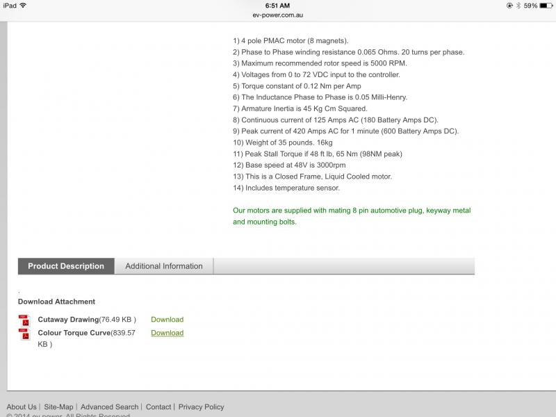

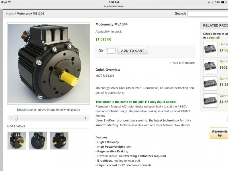

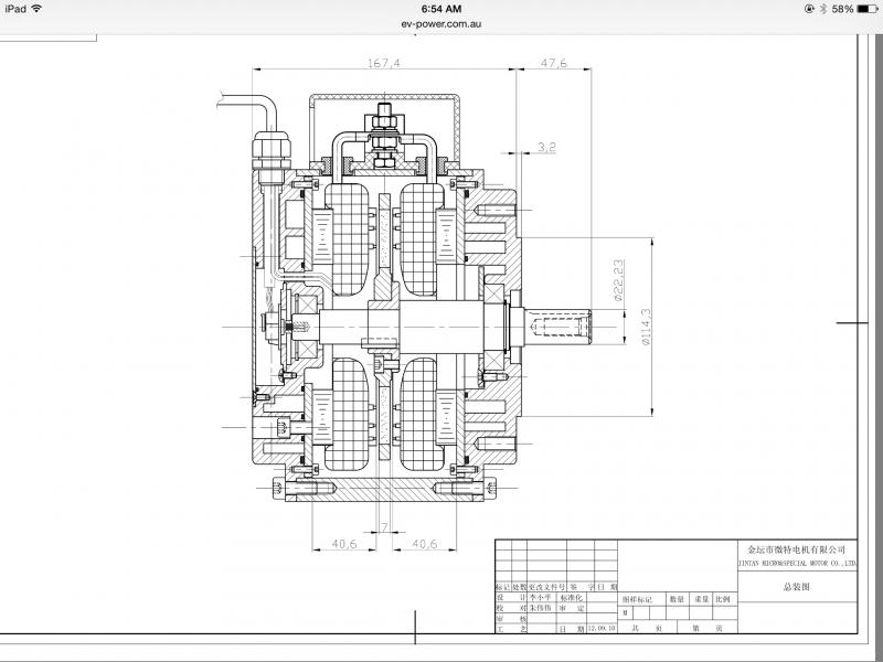

Very cool. I took a look at the "moter" too, as I have no idea about electric moters or setups. I hope you don't mind I added some information with picture. If it's an issue I'll ask H to remove them. Can't wait to see and read more.

I had a typo in my first post. The electric-motor (( Internal Combustion Engine ? )) is an ME1302 from Motenergy. It has the same physical size, but is wound differently to accept higher voltages (28 winding turns vs 20 winding turns for the ME1304). A little note:
An ME1302 is essentially a ME1115 with a liquid cooling jacket. An ME1304 is essentially a ME1114 with a liquid cooling jacket. Those are the manufacturer's model names, but some distributors will pay a premium to have their own model name, and as a result, charge an additional premium as if they have a different motor (( Internal Combustion Engine ? )). Couple this with misinformation from distributors, and it gets confusing for consumers. I verified from John from Motenergy that the ME1302 is the same motor (( Internal Combustion Engine ? )) as the DLC-28 and the EVD35.
Here are specs:
These specs are for 120VAC, but the motor (( Internal Combustion Engine ? )) can also be ran at lower voltages, such as 24VAC. The difference is that you wouldn't get as much power output since a lower voltage is associated a lower max attainable rpm. As power (W or nm/s) is the product of angular speed (1/seconds) and torque (nm), with the same amount of torque and a lower rpm, you would have a lower power output. You can achieve the same amount of torque at any voltage as torque is directly dependent on current. You may see something called a torque constant, such as nm/A or ft-lbs/A. Simply multiply by the current, and you'll get the torque output before accounting for mechanical and electrical losses. The main limiting factor on the amount of current you can pump into a motor (( Internal Combustion Engine ? )) is heat, which can melt the insulating varnish if too high.

I have also attached a mechanical drawing if anyone is interested in dimensions.
