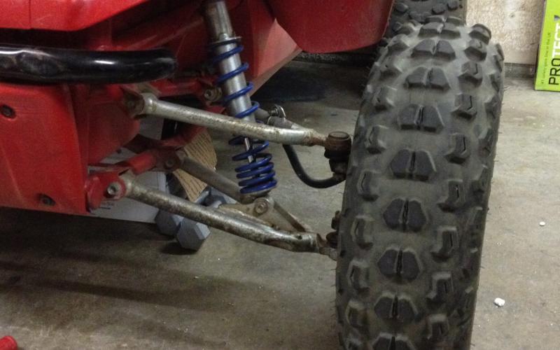

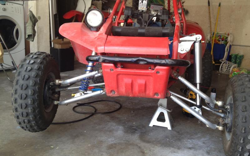

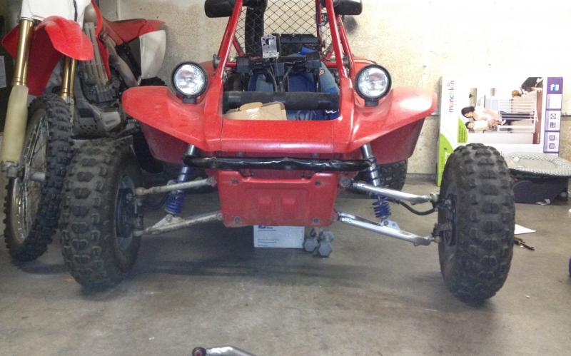

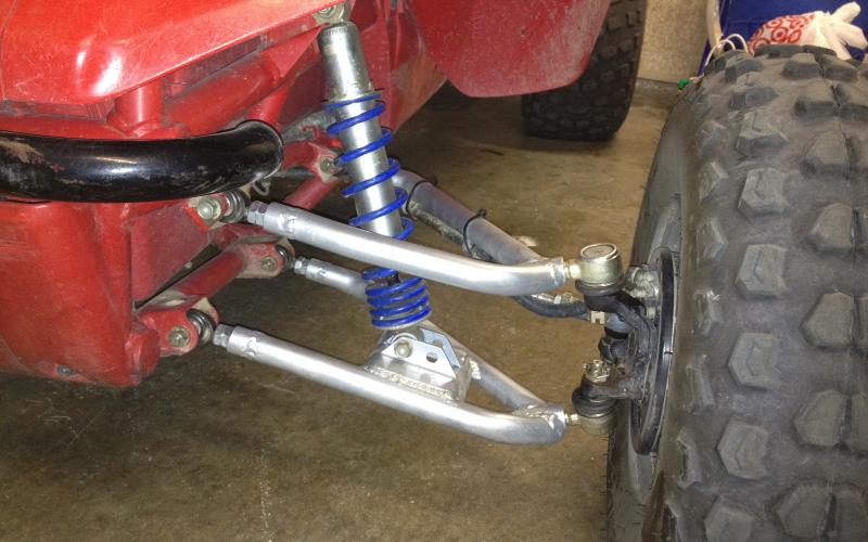

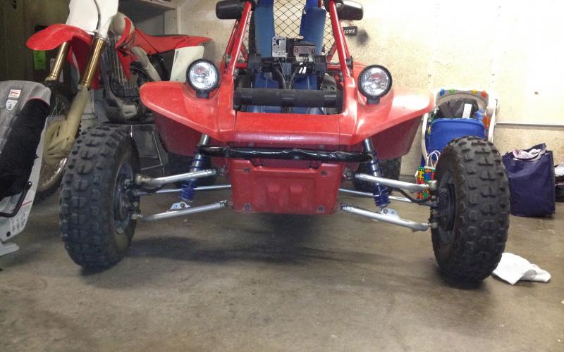

Well finally the time has come (almost) where I'm replacing my old suspension with fox shocks in the front and rear...
The front suspension is the Yoda Kit.. The kit was extremely easy to install and everything fit perfect without me having to alter anything.. As soon as I get the new fox shocks in the front, I'll install the LT brackets... It's a very well built kit. Thanks Tom!!

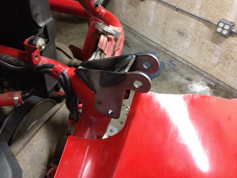

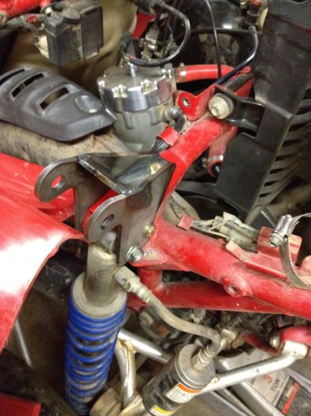

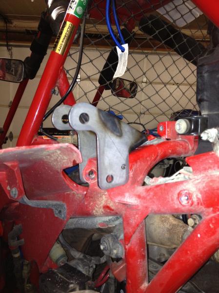

The rear brackets came from DC.. Kit bolted on easy... Thanks Doug
As soon as I install the fox shocks, I'll post some pics..
File comment: DC's bracket kit

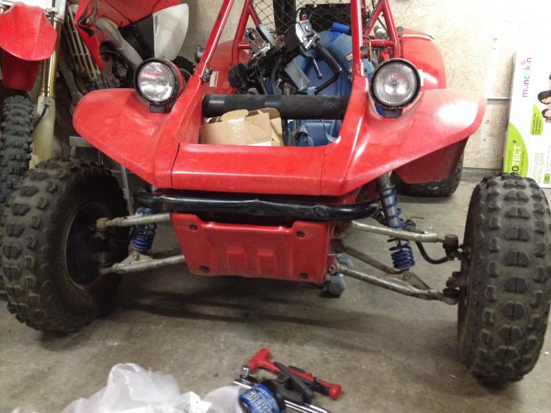

File comment: Stock Suspension

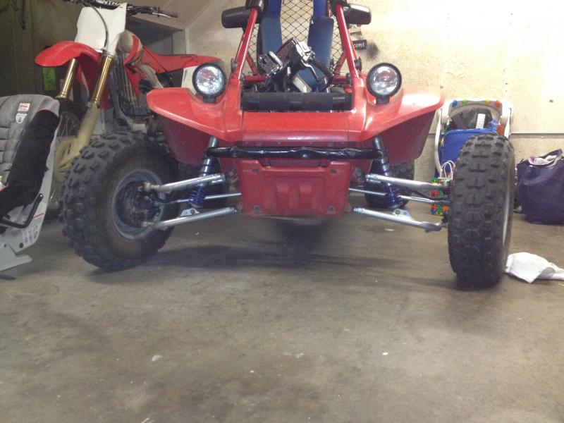

File comment: Left Side: Stock Suspension
Right Side: Yoda Kit

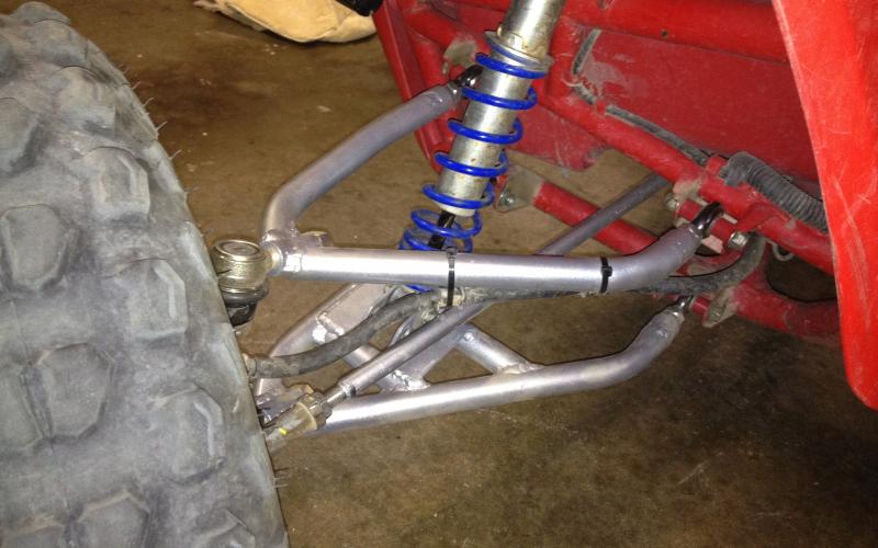

File comment: Yoda Kit

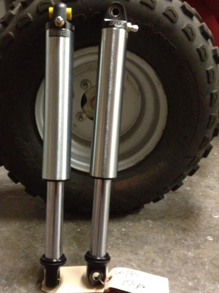

I'm going to start the front at 150psi with 60/90 setting and start the rear at 150psi at 40/90 setting.. I started the yoda kit with Tom since last May but it took him longer than normal to build the kit.. You should get yours a lot sooner than I did..

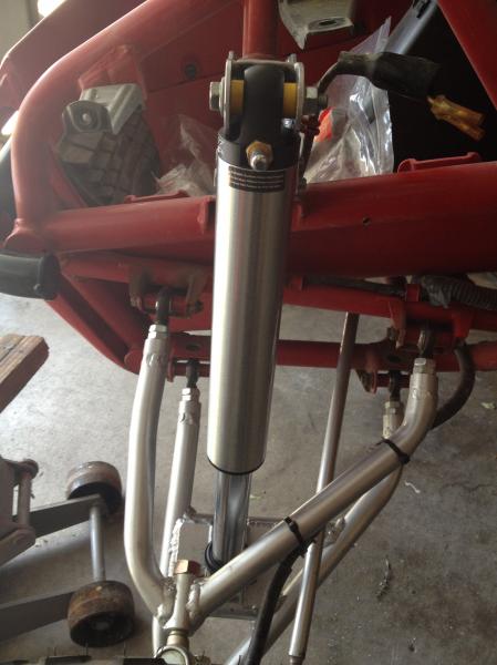

Update:
After having to re-pipe my house and other expenses that came around, I finally bought fox shocks for the front end.. Installing the LT brackets Yoda made was easy to do and I had no problems installing the new shocks.

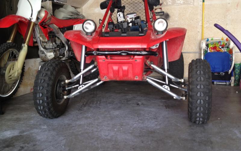

Finally got the right rims!!

I did on Sunday... I noticed a huge difference with the fox shocks in the front.. I rode in specific areas to test the new shocks where I had to slam on the brakes with the old stock shocks.. I only downer was after the fox shocks absorbed a hard hit with finesse I kept forgetting that I still had stock shocks in the rear so I kept getting bucked after every hard hit or landing..
Now I'm really looking forward to getting the fox shocks for the rear suspension.
The only other issue I had was the pilot kept pulling to the right and the steering wheel ripped out of my hands in rough areas.. My alignment is still way off so I still need to get that figured out!

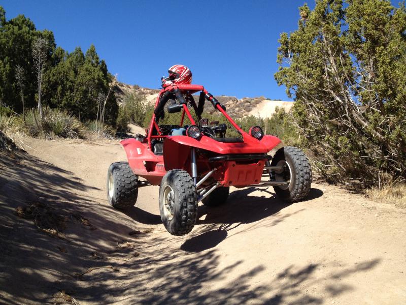

I finally got the fox shocks for the rear suspension and took the pilot out today and all I gotta say is HOLY SH!T what a difference.. I couldn't believe how well the suspension soaked up all the hard hits I used to have to slam the brakes before getting bucked..
I was even able to go through a whoop section at WOT (Wide Open Throttle) with no problem.. This was the same whoop section I tried going through with the stock suspension after I bought the pilot 4 years ago and gave myself a concussion.
I only issue I had was my inner CV boot popped off the axle stub after I tried doing a jump I shouldn't have done!! I created a post in tech stuff about this... Still landed smooth but will never try that jump again!!
Big thanks to Lutrev, DC and Yoda for designing an alternative suspension upgrade to an unskilled fabricator like myself!!
Big thanks to Hoser for keeping the site going!!
