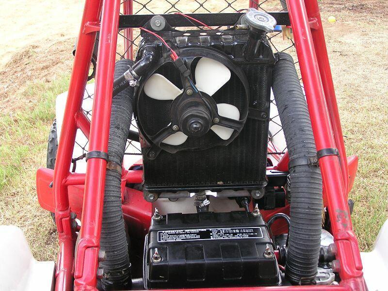

Had some time to take pics this afternoon. Still have to do the prefilters above the radiator and wire the fan (it's currently running off the lighting circuit).

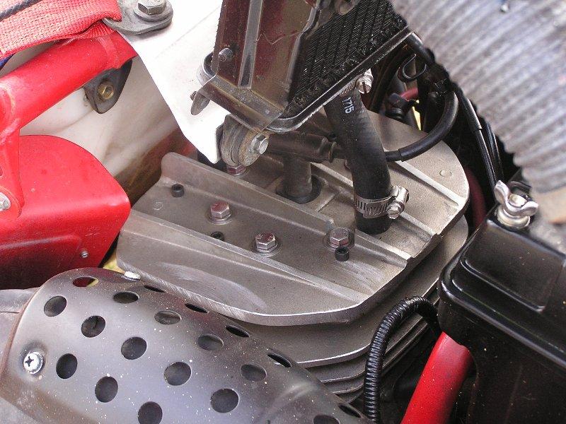

File comment: Hillside Honda head. Hillside couldn't find a source for studs and I couldn't either, but I've got some threaded rod on the way.

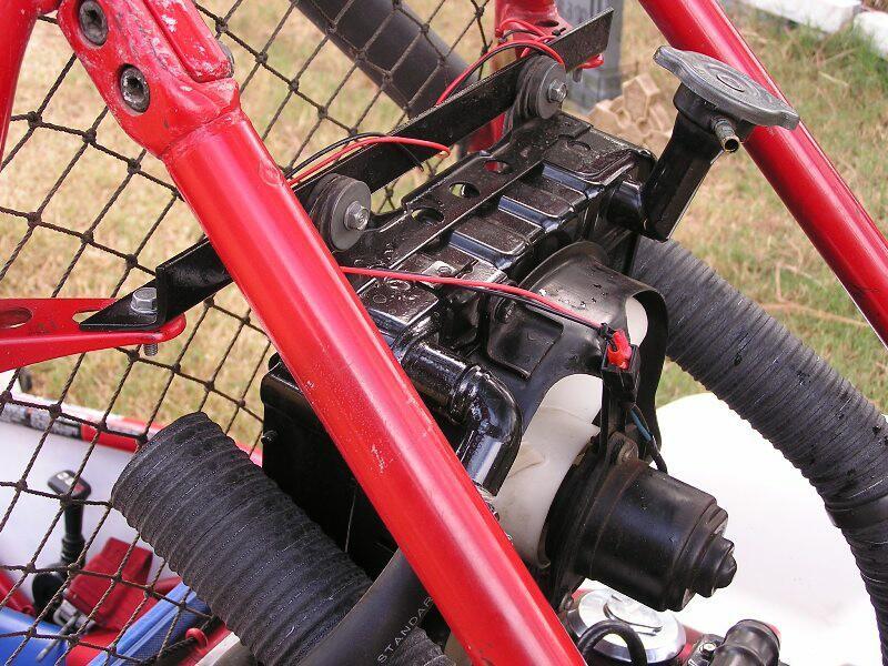

File comment: Goldwing radiator and fan

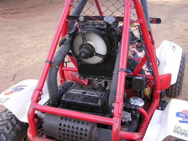

File comment: One of the kids cruising around to test it out, oh, and yes she was wearing a helmet, she just took it off.

PostPosted: Sun Jul 29, 2007 3:20 pm
Very nice work!
More pictures the better for guys thinking of doing the same mod in the future.
Cant wait to see the prefilters setup.

A small dab of RTV or di-electric grease in the tops of the crimp-on electrical connections would go a long ways towards preventing a possible corrosion issue.
Wouldn't hurt to drop some solder in there too...
DP

Sweet job on those brackets Odystabile-very nice indeed!!

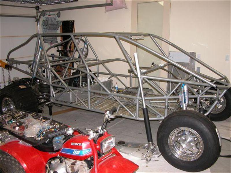

Funco
PostPosted: Tue Sep 11, 2007 8:42 pm
Oh that poor 110 vintage 3 wheeler, a shelve for nuts and bolts???????
