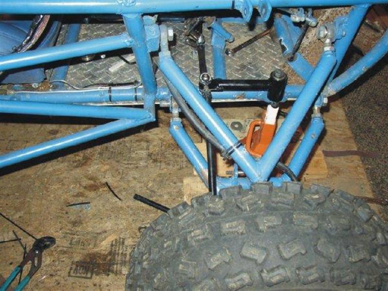

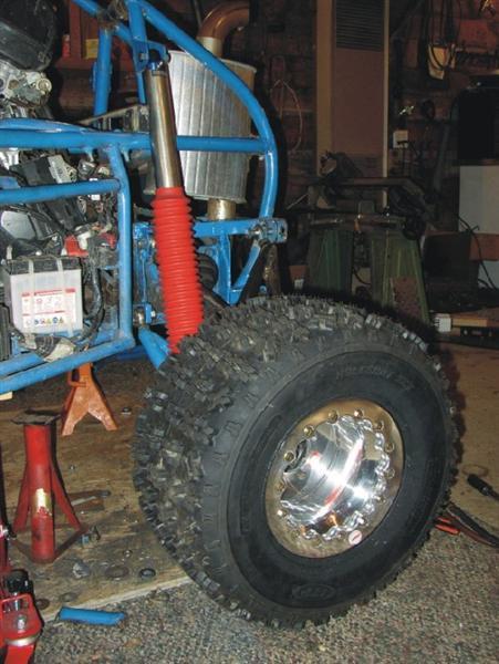

I bought new Holeshot XCT tires on OMF Beadlocks, added a bump-steer setup to correst the
heavy toe-in, and revalved my fox Air shocks. I was waiting for cowboy, but couldn't wait any

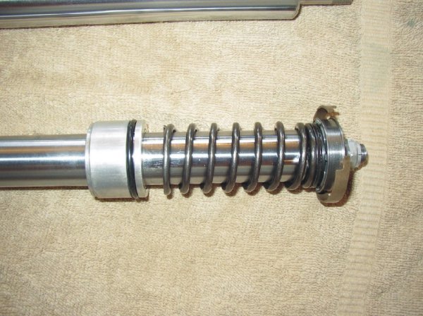

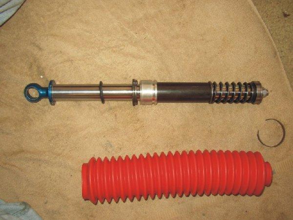

I changed my shims from 40-60 to 60-90, and added a 4" spacer to reduce the shock travel.
File comment: Bump-steer
File comment: New tires, rims, shock boots
File comment: spacer added, and new shims
File comment: old and new shafts
File comment: All of the old parts

If you remember the crash pics,,,,,,, my tires were VERY toed-in, about 2-3" , should be a very
BIG change. I have almost no change through the entire suspension movement :-) took some
time to do, but seems well worth the effort ,,,,,,,,,,,

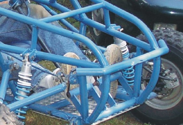

If you look close at this picture, you will see the floor pan sticking out 3/4" forward of the frame,
and understand why it stuck in the ground and flipped me a few times. The pan is now bent down
about 2" like a spoiler :-( Having a full skid pan up the front should be a good solution ,,, tom

PostPosted: Tue Jun 01, 2004 7:56 am
That should help but how about a bumper that sticks out the front a little with a skid plate
so it will tend to put the rear end down when you nose in, I know my bumper has saved
me many of times, I cant count the number of times I had nosed the front of my Pilot
and the front bumper has deflected and not dug in, I might add that the bumper mounts
have never bent but I have had to remove the skid plate and pound it back flat about
a dozen times, in the sand it tends to bow in the skid, this has no happen in the dirt just
in the sand, the sand gives and as the frame goes deeper more force is put on the
skid and it bends...
Some bumper pics here.
viewtopic.php?t=119&highlight=skid+plate
