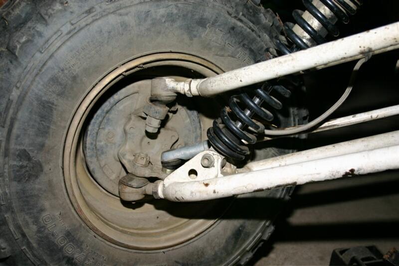

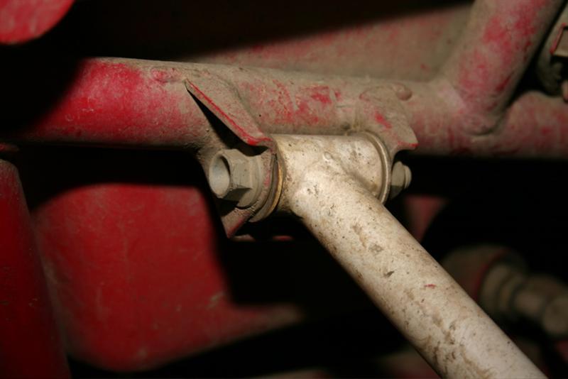

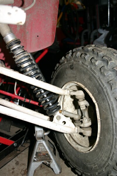

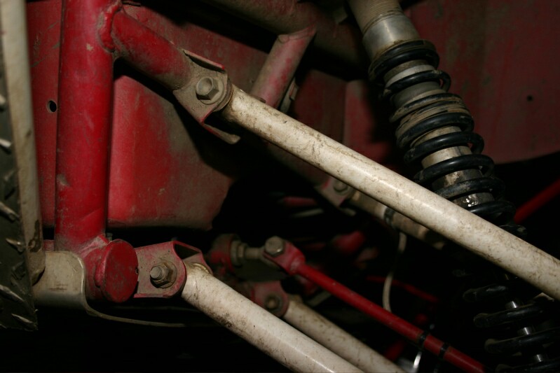

Hi All,

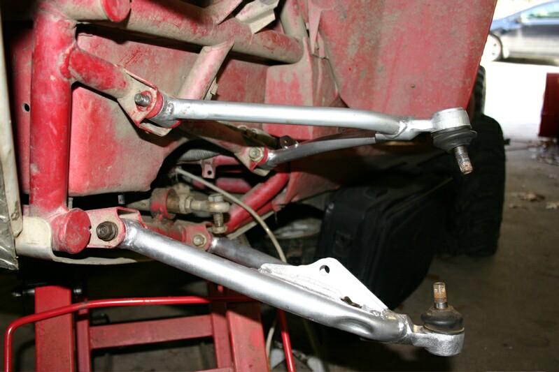

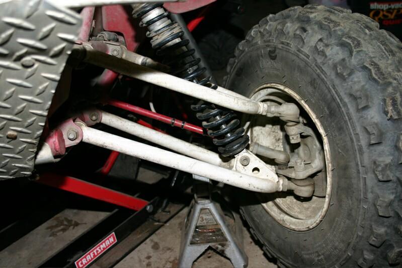

My Project among others.... is to maintain my front end and steering on the Pilot.
As a back ground this is the "Wheelman Pilot Project" from years ago. The board came together and built a ride for Mr. Wheelman. It has been passed along the way and I am the current proud owner of it. Thanks everyone!
Be that as it may.
I need to perform some repairs and upgrades to this setup.
1. Works shocks need over haul. np send them off if I can get them to respond....
2. Ball Joint replacements.
3. Replace Left side tie rod end. (Right is new) easy
4. Steering has a loose play that is additive from steering wheel to actual wheels. Shaft repairs. Bump steer bushing, bushing , bushings. :)
5. A Arms: loan to friend to look at.

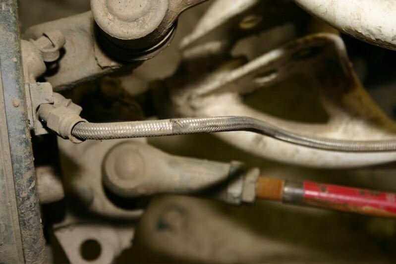

6. Breaklines...... I was a dumb ass and let my braided brake lines come in contact with the rim.....
File comment: Left side

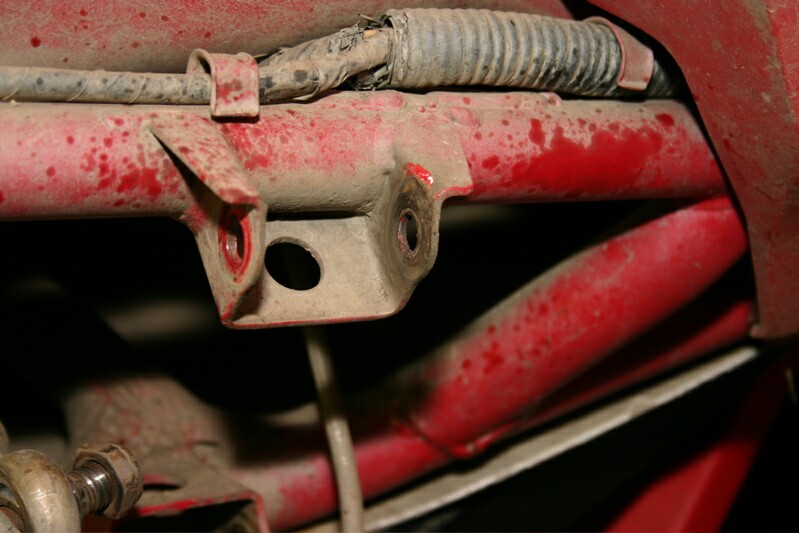

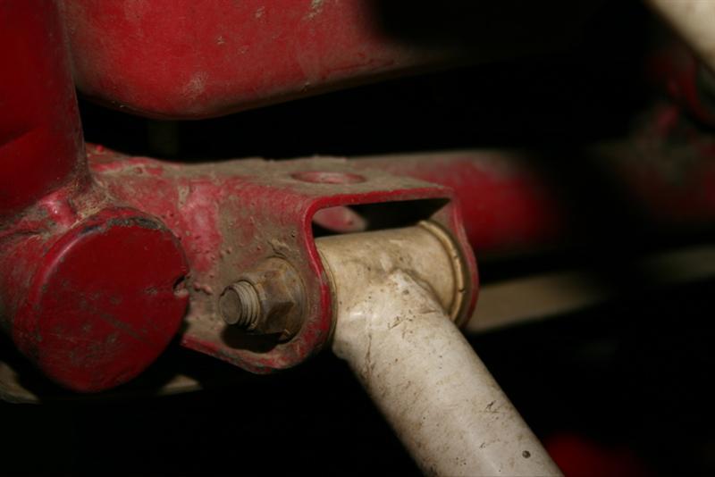

File comment: Left Side frame mount point

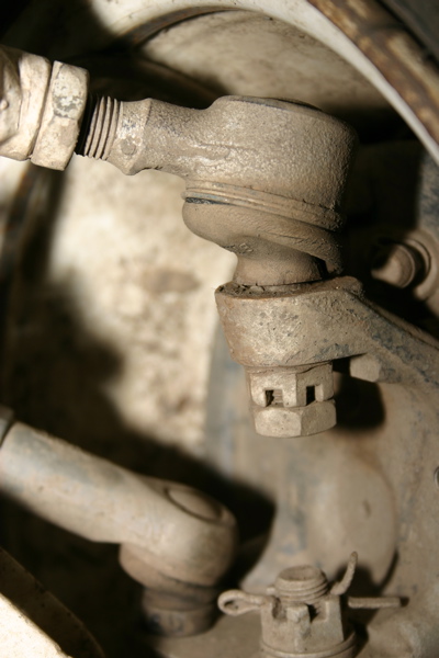

File comment: Left Side bumper Steer end. Inside Tie rod end.

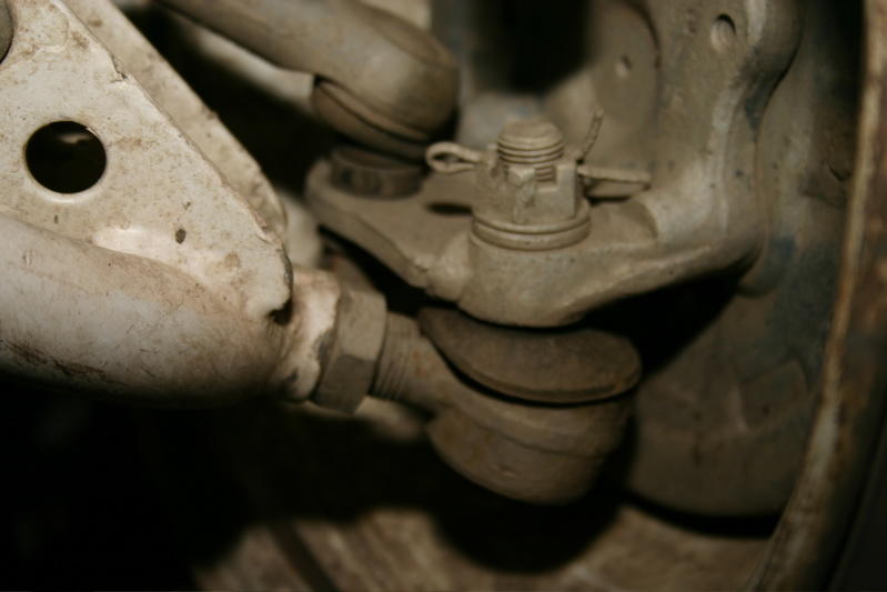

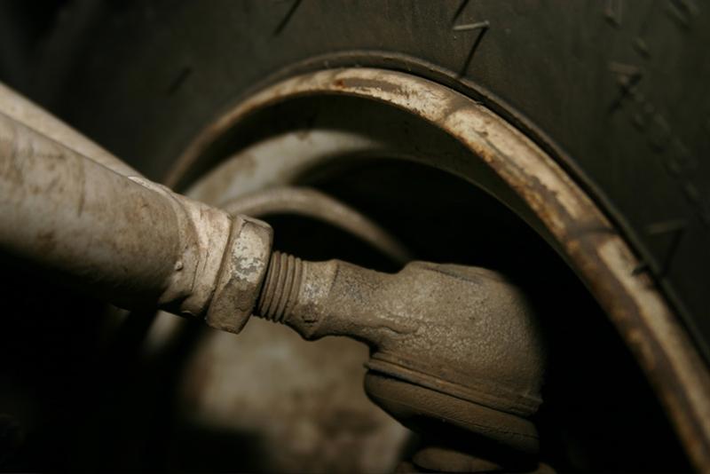

File comment: Left Side Tie Rod end
File comment: Left Side Lower ball joint

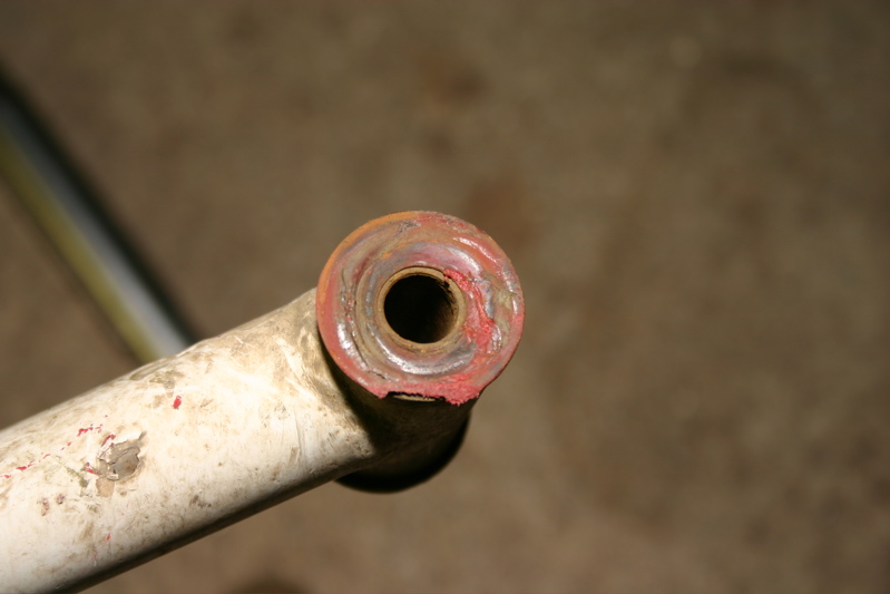

Upper Arm's OD is 7/8"
Lower Arm's OD is 1"

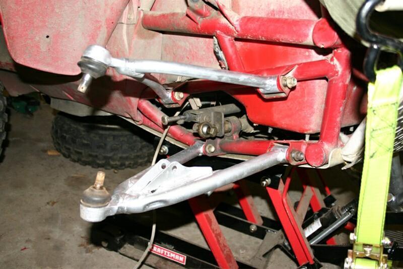

I started to pull the parts off.
Arms go out to get Bushings made to fit.
Shocks go off to Works to get over hauled and adjusters added. Hopefully dropped an inch as well.

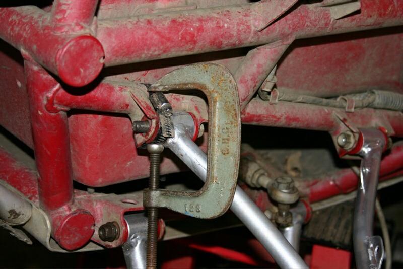

File comment: I allowed the brake line to slack and it rubbed the inside of the rim.

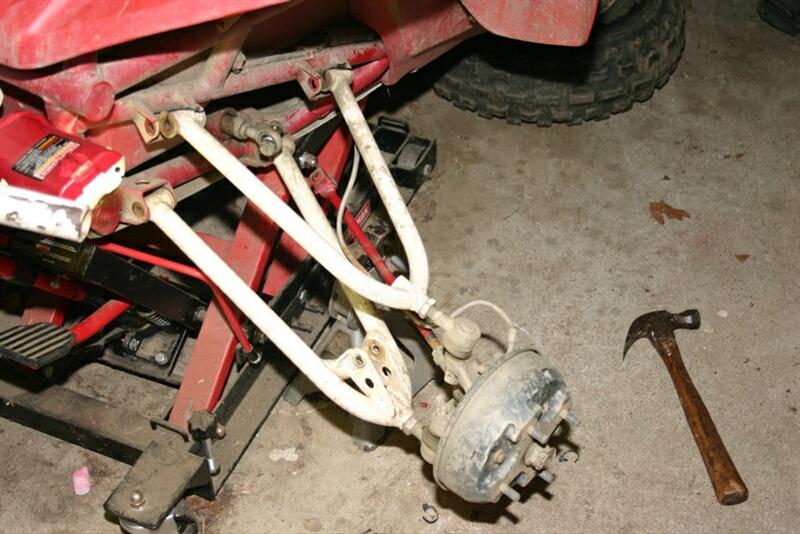

File comment: lesson learned: take huboff BEFORE removing the arms....

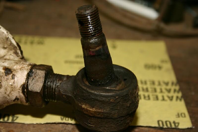

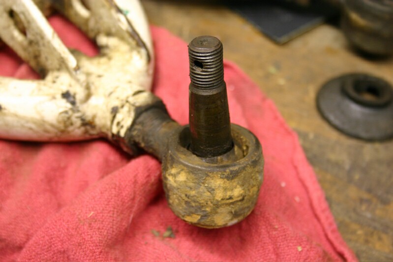

Got the Arms of and them seperated from the Hubs.
I see some numbers. We'll see if they amount to a new part #.
With all the frnt end apart. My steering is still real tight.
Next step after this is to rework the steering with a good douching, inspection, and bushings.

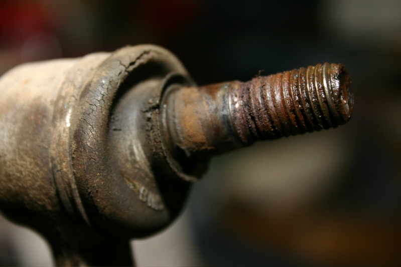

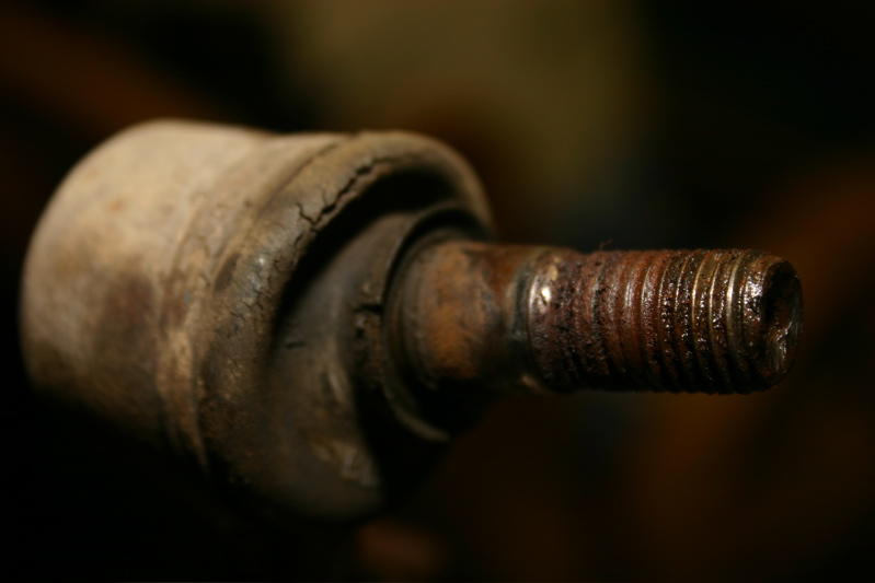

File comment: tough to get a pic of this. But its the leaky seal on my shock.

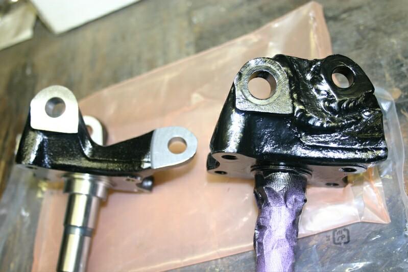

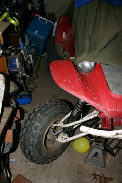

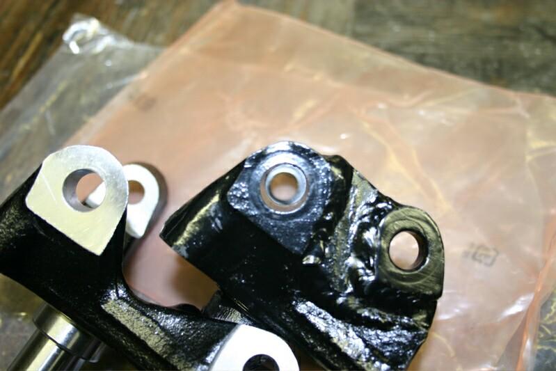

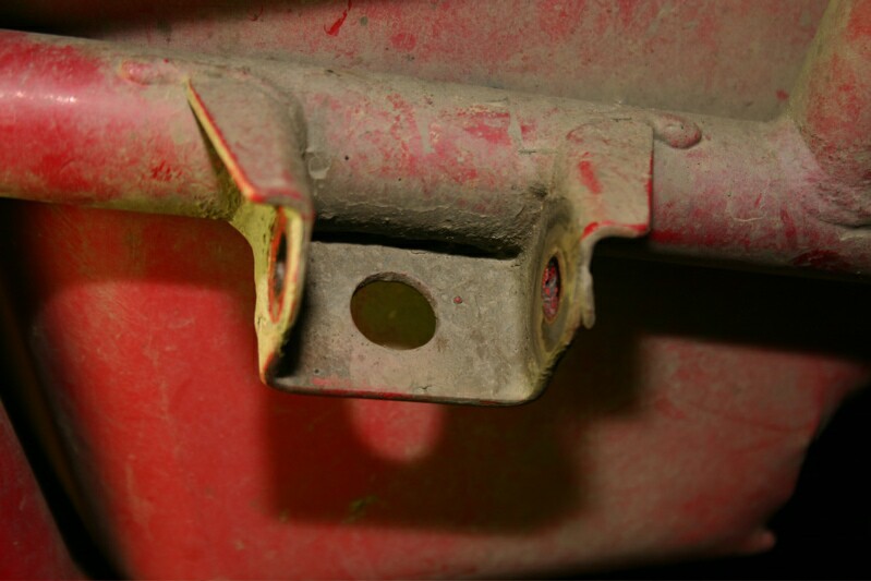

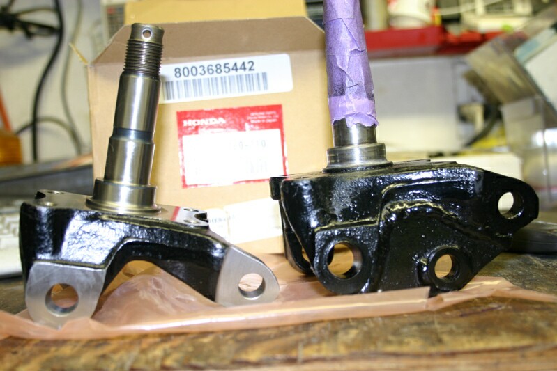

Started to install the stock rebuilt setup.
I'll miss the LT Works Shocks.
But here we go. In order for me to get this ride from my garage to my friends shop I got to get the front end together.
In doing so I cleaned up my front hubs and brakes. (work in progress)
The carriers have been modified. I hope the stock steering still fits.
Is carrier the right term?? The bitch ass part that connects the upper and lower A arm directly. ;)

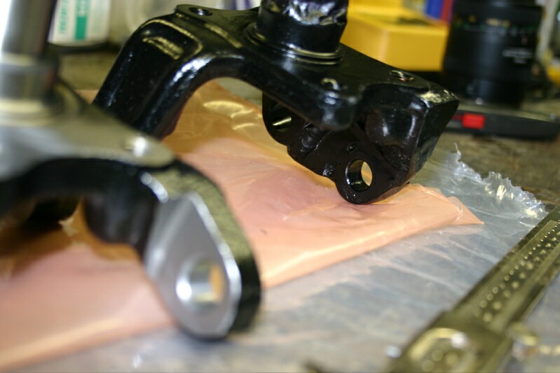

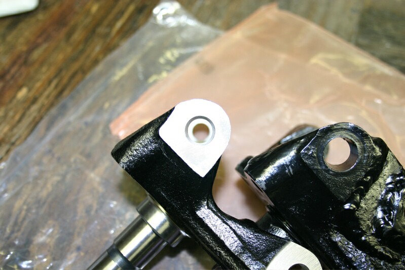

Going by memory they welded on a tab to relocate the tie rod end, is the ball joint tapers and holes the same as Honda or did they ream out the holes?
PostPosted: Tue Mar 13, 2007 12:46 pm
Posts: 806
Location: Bolton Ma
I'm worried of this as well.
I'll put the pieces together tonight and see if they are sloppy.
I hope not. Otherwise I'll need replacements.
I'm also hoping the steering wholes are close enough for government work.
PostPosted: Tue Mar 13, 2007 9:02 pm
Posts: 806
Location: Bolton Ma
Confirmed. The wholes for the Ball Joints are reemed out a tad.
And in a tapper.
Maybe these should go with the +4" Arms. Or sleeve them.
As I mentioned in chat I need to mic these out. And then compare to stock.
They match the mod well so maybe its best to replace them.

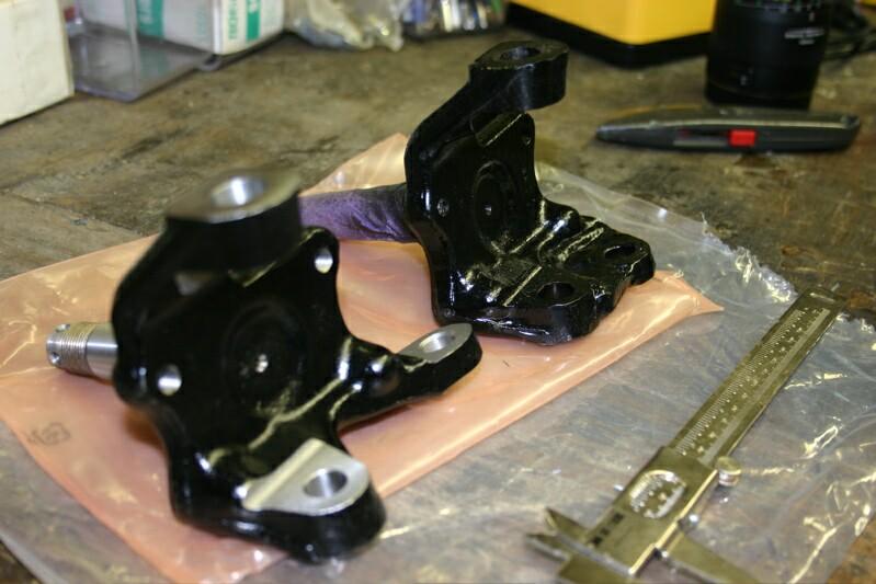

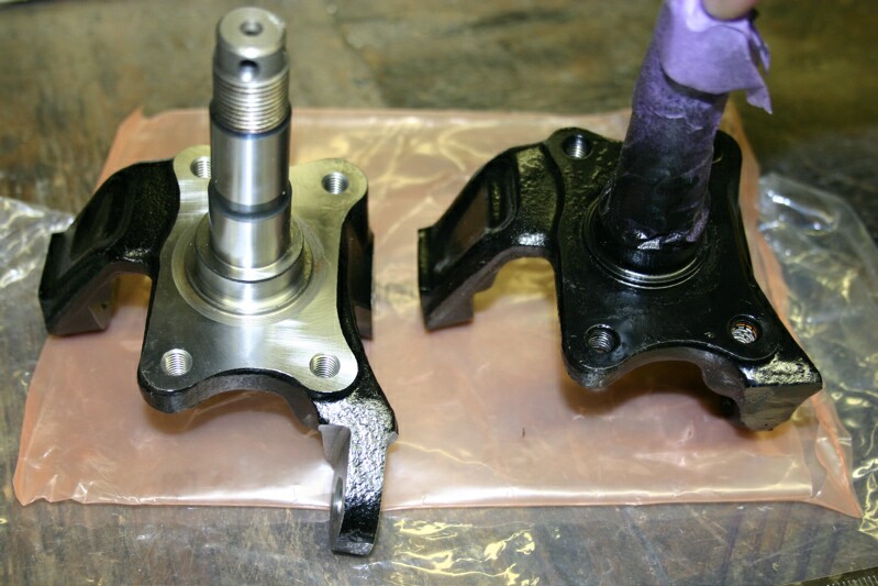

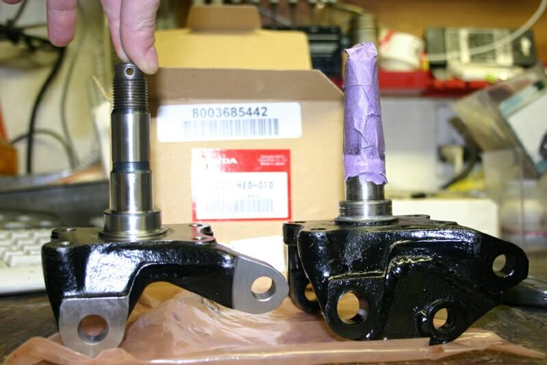

PostPosted: Wed Jun 06, 2007 9:56 pm
Posts: 806
Location: Bolton Ma

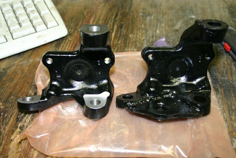

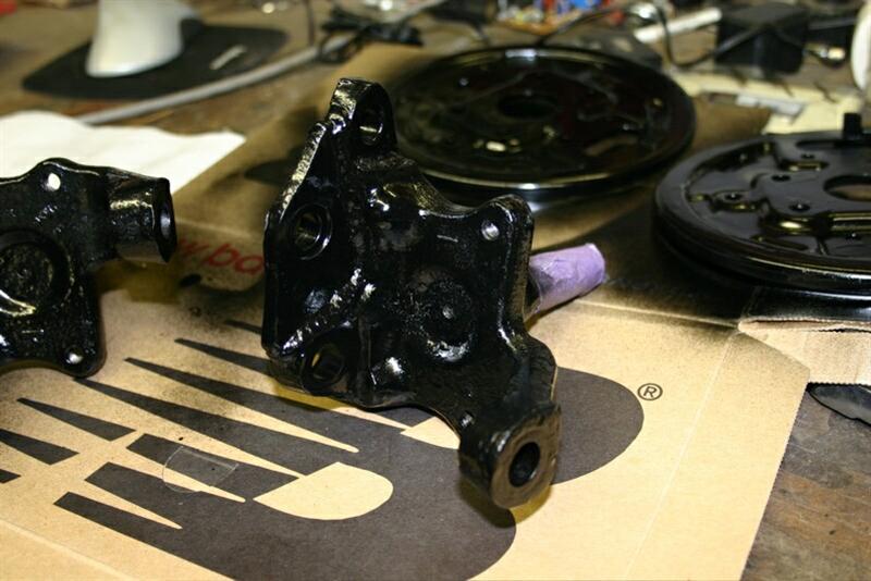

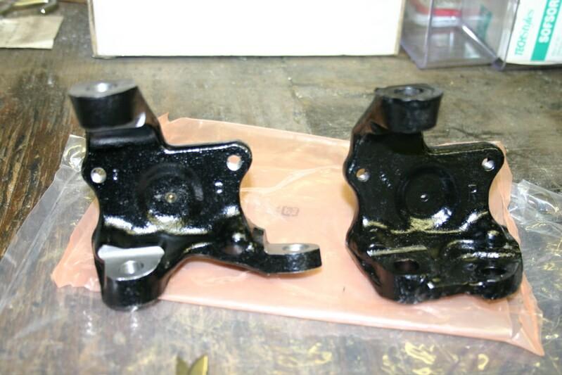

I got the replacement Front Knuckles from Service Honda today.
Yipppeee still available!

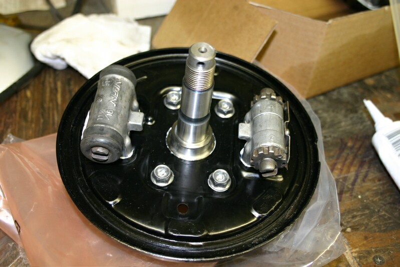

PostPosted: Sat Jun 09, 2007 6:42 pm

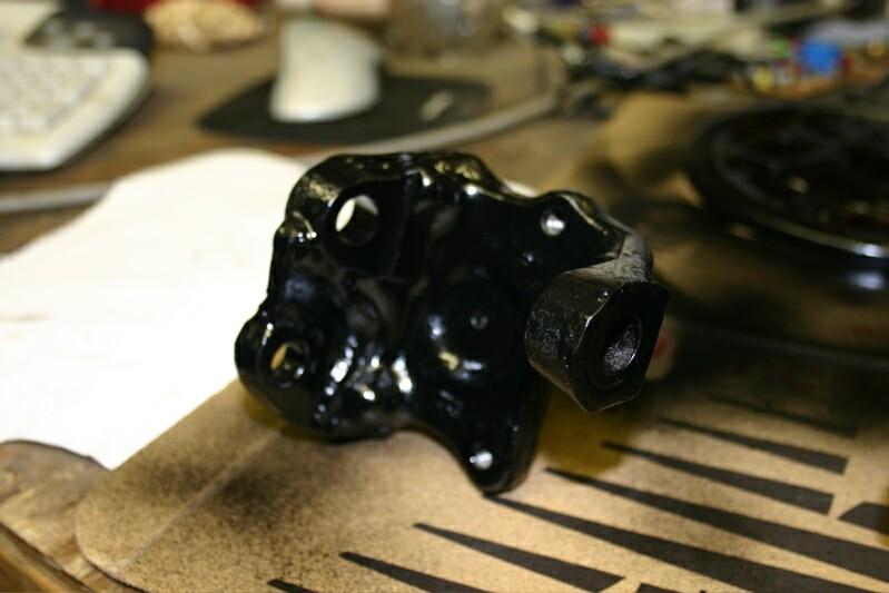

Posts: 806
Location: Bolton Ma

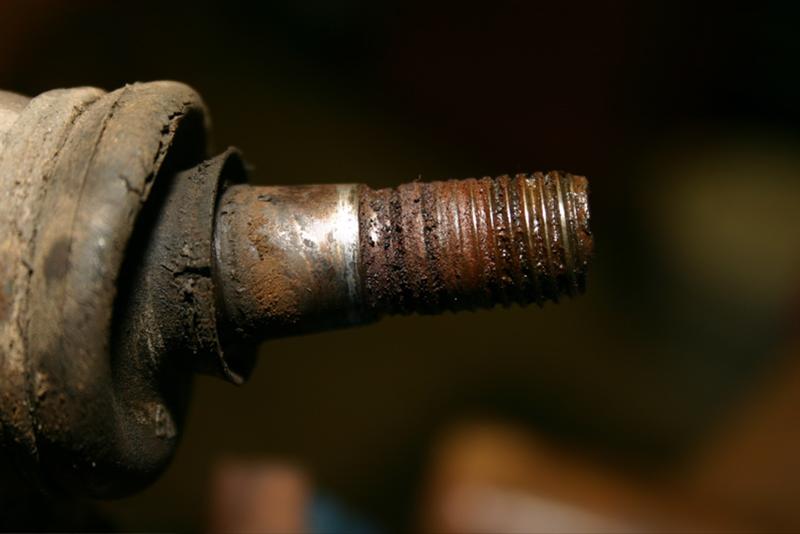

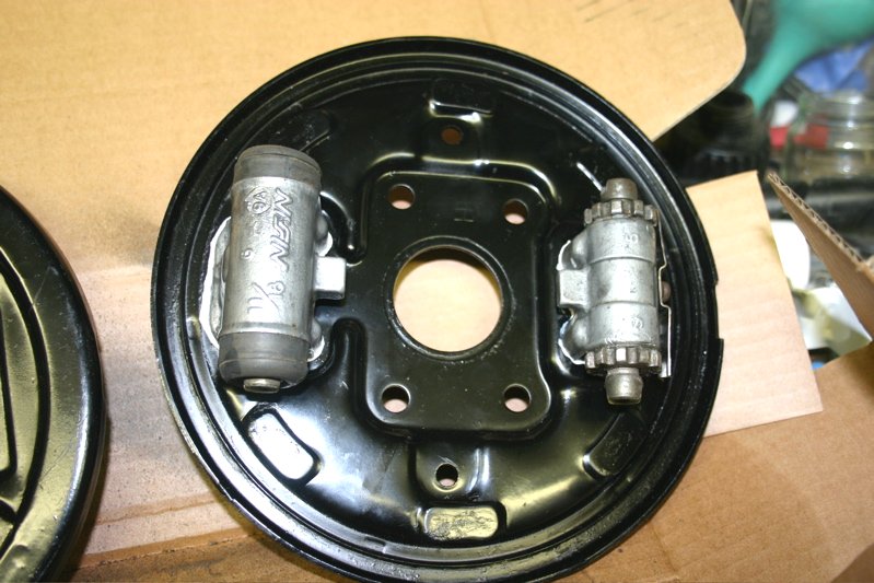

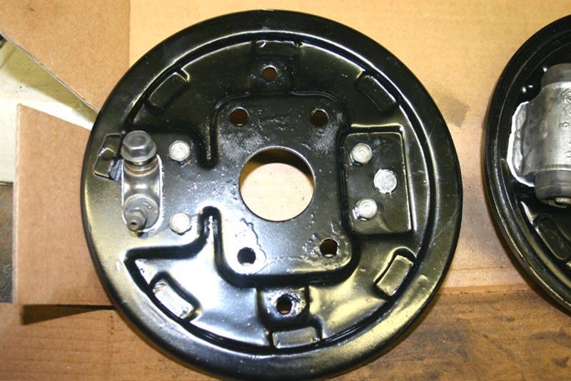

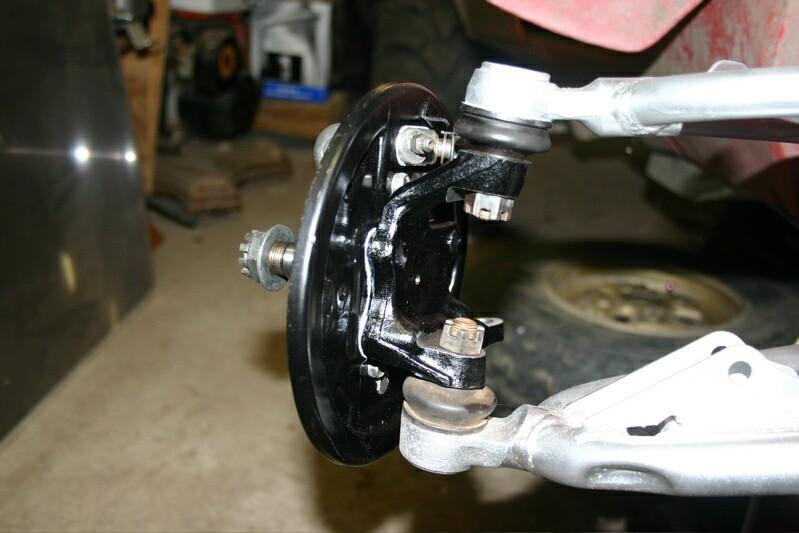

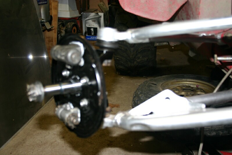

I built the hubs up today and snapped a few shots.
I used a bit of silcone sealer between the plate and the parts that attach to it.
I noticed when I took it apart it had trapped some crud in between.
I also ran the dremel with a soft brush over the parts. Got the residue crap off of the nuts and bolt heads.. Used a tight brush for the crater head bolts.
(wife thought i was crazy)
I noticed some of the 12mm bolts thread tips had rust and other did not.
Two bolts are exposed on there tip end to the elements. So I dabbed a tad of silcone on them to protect.

PostPosted: Sat Jun 09, 2007 7:19 pm
Looking good.
Did you grease the ball joints?
Put never seize or grease on the tapers before installing?

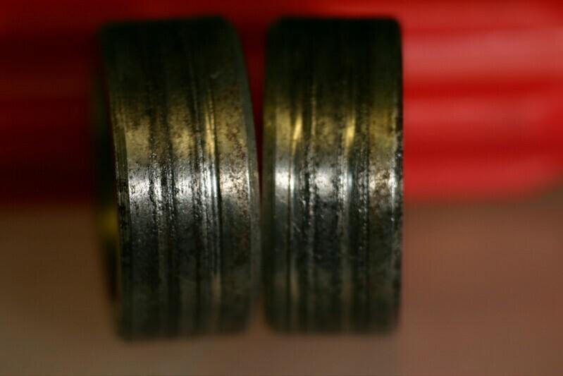

PostPosted: Sat Jun 23, 2007 12:15 pm
Posts: 806
Location: Bolton Ma

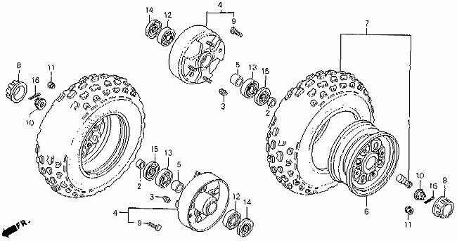

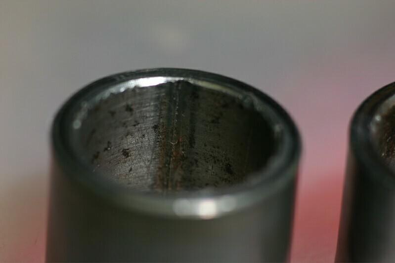

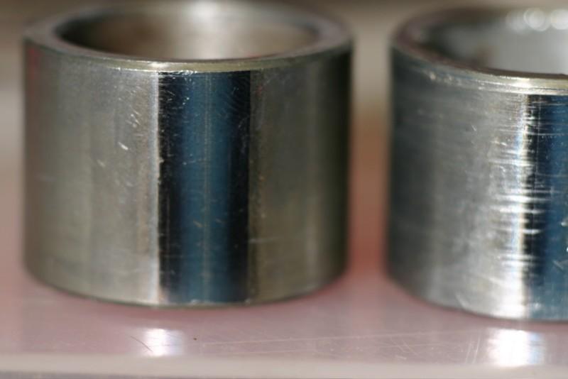

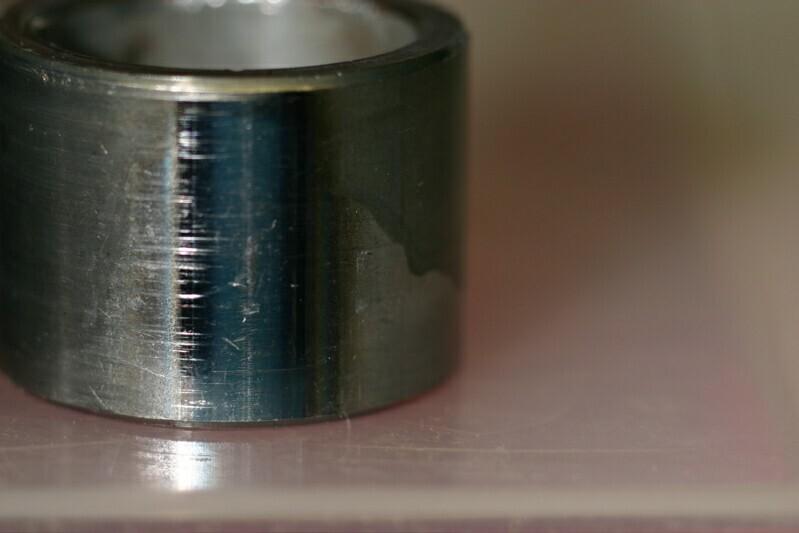

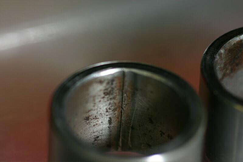

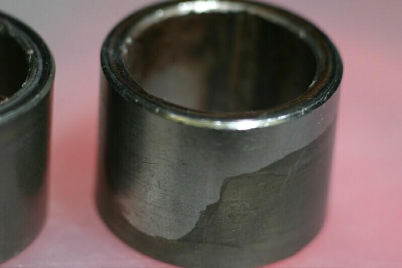

So I noticed the front hub bearings needed replacing as well.
And once I got them apart I notice the two collars were marked up a bit.
These parts are #2 and #5 in the parts pic,
44312-VN0-000
and
44620-HE0-000
How critical are they for being perfect?
The linear marks on them and th eheat stress it looks like on the outer side is concerning me.
New bearings and dust caps will be going in.
Will post more. gotta resize pics
File comment: Collars are #2 and #5

pics of the collar bushings
File comment: hard to see but interior wall has a groove
File comment: the other one
File comment: these are the other parts. they are worn on the outside wall only.
File comment: exterior wall shows what I see as heat stress??
File comment: Here's Mud in your eye Kid
