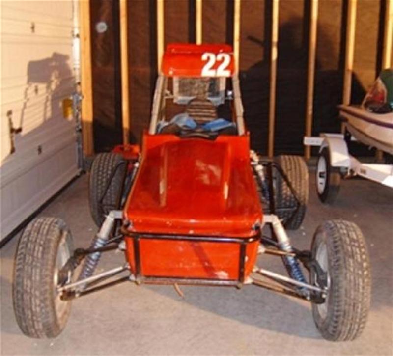

After getting my Oddy all set up, I can no longer operate it due to a hand injury. It is up for sale here and on P-O
But - I did purchase Jerrys B's Stadium Lite! It is a FL350r powered, H&R chassis, Coleman trans, works shocks, Full A-arm ex Mickey Thompson series car. And since it has foot controls, I can go racing again.
While it is 95% complete, it does need some work. Things like wiring, hoses will be redone. Shocks will be rebuilt and resevoirs added. Has a motor (( Internal Combustion Engine ? )) issue - Jerry had cylinder resleved and it will not longer rev up. (that one has all the experts puzzled). After a good prep it will be racing again in Elsinore in May.
Here are a few pics.

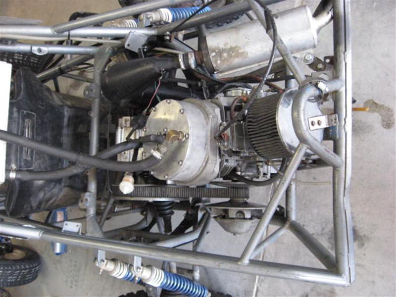

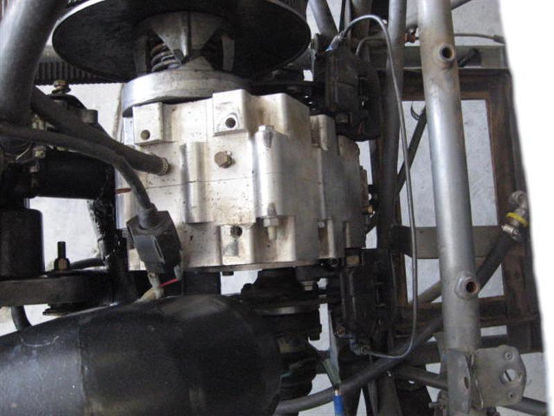

Here are some photos of it with the side panels off.

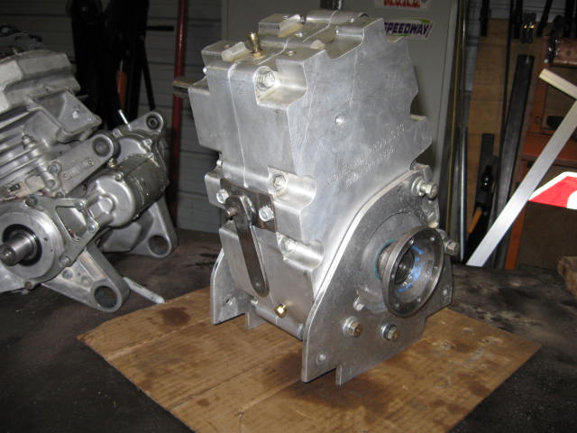

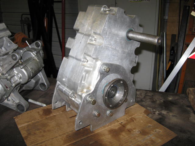

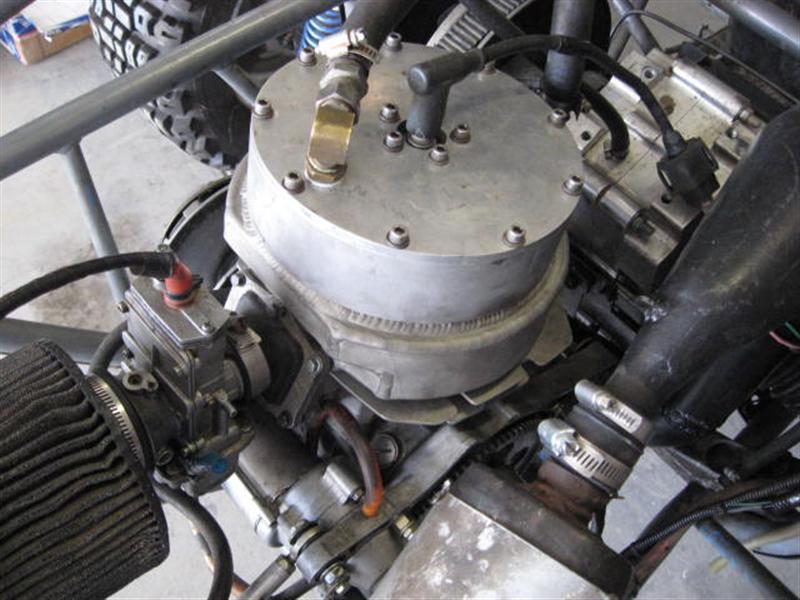

Here are some of the Engine - water cooled head and jug. Unknown manufacture
Transmission is engraved COLEMAN PRODUCTS. It is a FNR box with a center differential, uses what look like VW axles and related parts.

PostPosted: Mon Apr 07, 2008 4:24 pm
Can you take more detail pics of the trans, any info on it?
Your going to cover that gauze filter with a foam filter? UNI can make you one to fit if they don't already.

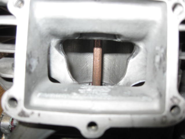

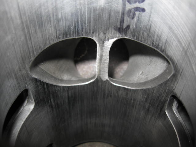

Cylinder:
Here are some photos of the ports before finishing up the port matching
** More before photos added 05/28**

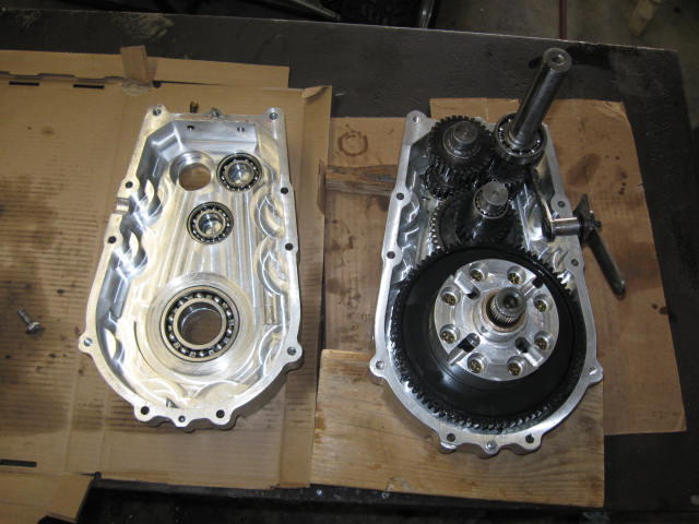

Hear are photos of the trans. Made by Coleman - no longer in business. All billet case, Baker diff that uses VW parts, no idea on the gears.
Just installed all new bearings / seals. The input drive gear has had the damaged "dog ears" filed off and flipped over, so the weak side will now be reverse.

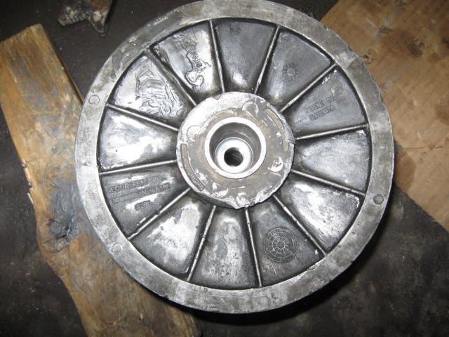

 Post subject: Broken Powerbloc clutch
PostPosted: Wed May 28, 2008 9:23 pm
Joined: Thu Mar 01, 2007 2:52 am
Posts: 109

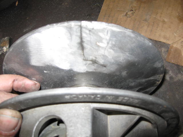

Found this nasty crack in the Powerbloc clutch. Not sure if it was caused by prying or impact with something. Either way it is now junk.

PostPosted: Wed May 28, 2008 9:28 pm
Posts: 533
why is it junk? cant u have it welded?

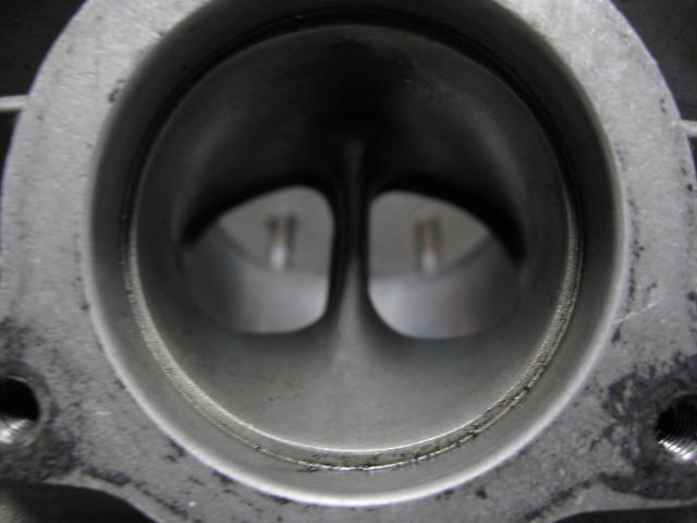

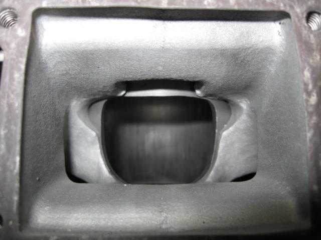

The intake port needed the most work. All the others only needed very minor touch up , radiusing. On the intake I radiused the uppper bridge slightly, and matched the wide side ports to the casting.
Some other CSI - the 'squish' with original 3 piece head gasket was .060. From reading here it needs to be in the .036 to .042 range. My plan is to run av gas so the compression can be higher.

Posts: 109
The cintrifugal forces at 8000 rpm would make in highly prone to failure and extremely unsafe.
 Post subject: Re: After porting
PostPosted: Wed May 28, 2008 9:52 pm
Can you roll the piston to BDC and take a pic of the intake?
