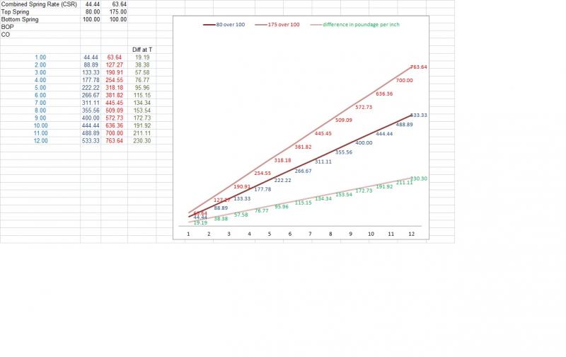

Having some fun with the new numbers
no pre load
no cross over
4x identical bath scales zero-ed out then put under each wheel
FL #174
FR #178
RL #270
RR #263
 Post subject: Re: Dave-Co Pilot
PostPosted: Sun Feb 09, 2020 1:32 pm

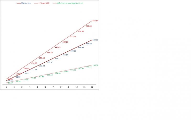

better pic
PostPosted: Sun Feb 09, 2020 10:13 pm
Posts: 1070
Yea my spring combo is 43% more down the chart at each inch with the 175/100 than the 80/100.
Your not calculating the crossover there though. I’m thinking of setting crossover at 4 inches. It should jump up to 100lb inch which would max out at about 1050lb at bottom.

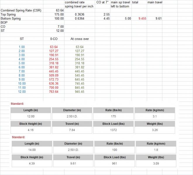

Take a look at this maybe call your shock guy to confirm.
Man I hope I am wrong
PostPosted: Mon Feb 10, 2020 9:24 pm
I did one with a 7" cross over for main spring travel (block)
made an error had to re-post pic
when I plugged in the math check found error, sorry
math check is easy
7" @63.64 +5" @ 100
7 x 63.64= 445.48
5 x 100= 500
445.48+500=945.48
block load on 14" 100 = 961
easy catch.

Adnoh,
You worried me there, but then I see you’ve plugged in the wrong spring heights.
The 175lb spring will be 10”
The 100lb spring will be 16”
Make the 100lb spring block at 11.10”, not 9.6”.
Co at 4” should be alright with about 0.5 clearance
Also, I’m setting up about 1.5” of bump stop seeing as at .6” bump stop my rear end is 1/4” off the floor. And that’s without compressing tires. Also the tires are touching the fenders. So that I don't ruin my fenders, bottom out the frame, or block the spring - I think I need to solve with adding bump-stops unfortunately. Still - calculate for 12", but I recon about 10.5-11" is where its going to bump stop on the shock.
So this Dave-Co suspension needs to be shortened from 12" rear shock travel to about 11" so that fenders clear the tires and skid plate clears the ground. Still much better than stock I guess.

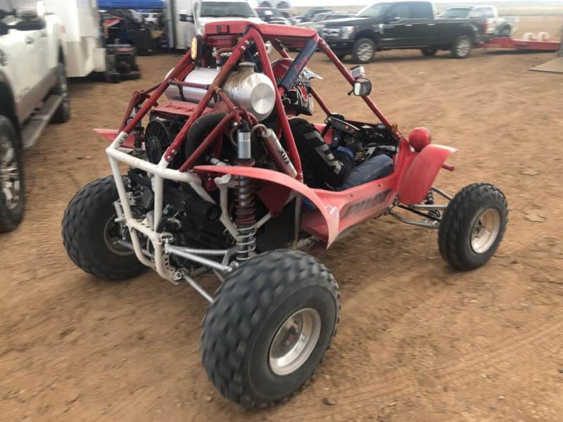

All of this while keeping tow, camber and BALL JOINT BIND in check, with the narrow rear and that much travel you get some serious camber changes.
Another thing I would check is the straightness of your axles, everything back there is going through enough, an axle that is out of straight even a little will wear things out over time.
I have run my Pilot as hard as you can run one, I have not worn out any front or rear ball joints, they are all tight. I do have 2 rear high quality heims that I have worn out and one bent rear lower arm, I was surprised on the 2 heims, one on each side.
The handling of her I think is as good as it gets.
Here are a few pics. (hope you don't mind), you can see in the pics. how compressed my right rear is.
