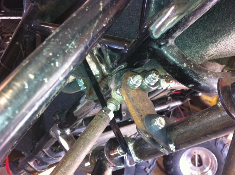

well i quickly made up a new bracket. still no bushings or anything yet. but i mounted it vertical like that photo and i think it might work pretty good. this was just a mock up again so everything can still be changed. also less welding this way, and i don't have to fight trying to get that little round tube in between the frame rails. this way might work to better
bullnerd how do i find that inner pivot point, in the pic i just tacked it up there. plus i think my swing arm is a little to long. still clears the frame and all. i have only done one side right now.

When mocking up stuff like that your on the right track but use a bigger plate drill 20 holes in it then play with different locations cycle the suspension as you try each location cycle it wheels straight then cycle it with wheels turned 1/2 way then full turn.
Same with your attachment points at the spindle use a plate with a bunch of holes.

PostPosted: Mon Apr 02, 2012 6:39 pm
Looks good.
Is the tie rod still parallel with the lower?
Are you ready for this, The inner tie rod pivot is the center of the arc created by the outer tie rod pivot.Read this over and over and look at the pic below,this is one of the first ones I posted.
The easiest way to find it now that you now the tierod length is(13.5?)is to tape a piece of cardboard roughly where you think the inner will be(you have a pretty good idea now right?).Put the cardboard vertical,basically right where your new bracket is.Now cycle your suspension(this is where knowing your shock lenghts would help)full bump,ride height,full droop.Put a magic marker in your inner rod end.Make an arc on the cardboard at each location(full bump,etc...).where these arc cross over is VERY close to where the pivot needs to be.If they don't cross over you can guesstimate the average of the three.

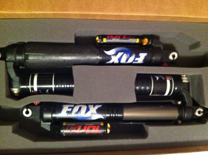

PostPosted: Wed Apr 04, 2012 10:17 pm

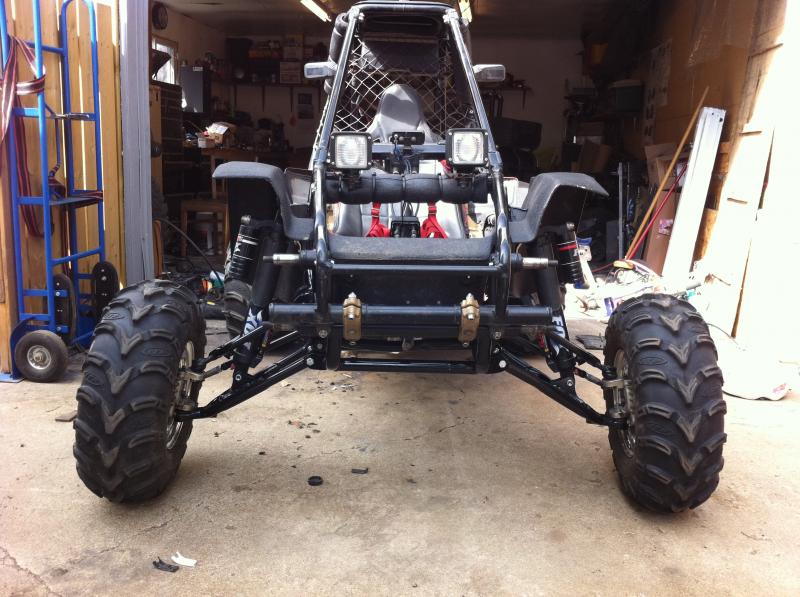

first day up north at work and guess what shows up.....now i have to wait 13 more days to see them try to get them mounted
PostPosted: Wed Apr 18, 2012 11:07 pm

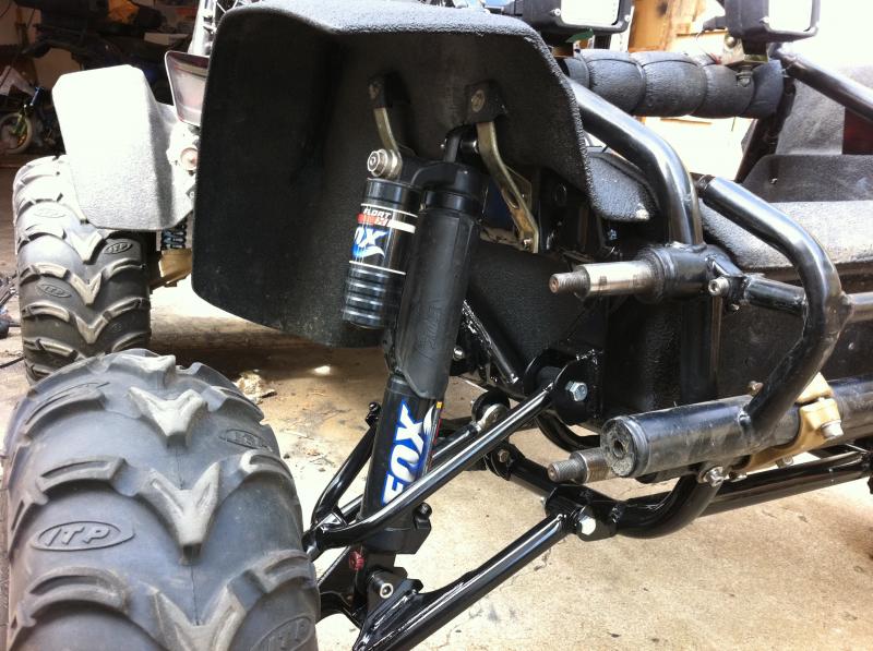

back home from work now. time to get back at this and get these shocks mounted. the came off a 08 ltr 450. 17" eye to eye. i don't think i will get a full 11-12" of travel that is available. i am hoping for 9-10" though. going to be a little difficult to get the upper mount right, also going to have to cut my fenders i think

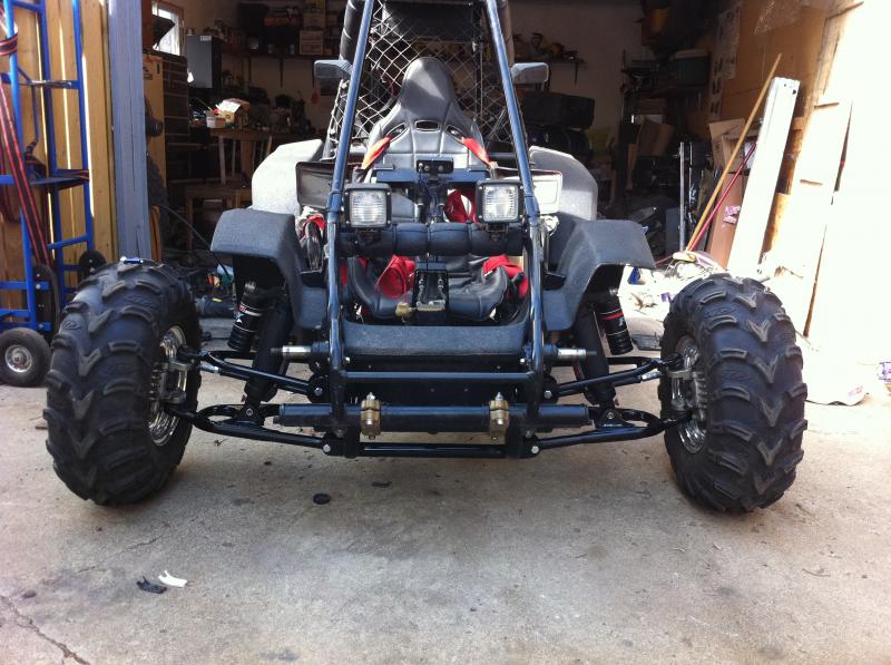

no ride report yet. hopefully soon though. i think it turned out pretty good. here are some finished pics. minus brakes didn't get that done yet maybe today..i probably will have to get the upper adjustable ball joints but for now i think it will be fine.

PostPosted: Wed Apr 25, 2012 7:08 pm
Very cool.
Yeah it looks like your camber curve is a little off.
You might be able to fix it,your upper tabs look pretty big.Maybe move the hole and weld up the old ones.
I would have made full bump a little lower but no biggie.
Remember how you found the pivot for the TRE?Do the same thing to find the upper inner arm mounts.Get an angle gauge of some sort and cycle your suspension.Make an arc with the upper arm,at full bump,droop,ride.Use the angle gauge to set the camber at each position before you make the arc.Not sure what works for the pilot?I think Shoubadaba said -2deg?
0deg at full droop,-2 at ride hieght and a little more -5deg? at full bump.
Give it a ride first.

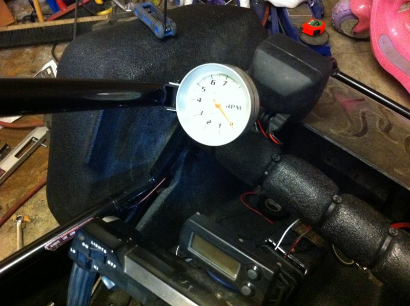

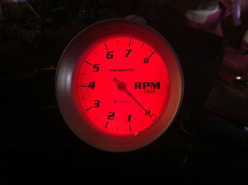

also go my tach installed.
