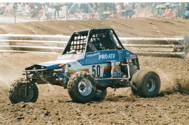

beastmobile wrote:
I can't take any pics of it right now because I sent it with the mechanic but there's some weld spots on it.
And hoser, because I'm running out of money, and I could get me something to ride this season. Give me an offer. I really don't wanna let it go, but I'm to the point where I think I'm gonna have to.
Put it on CL for trade? You have all the info in this thread to make a pretty good listing. Make sure you add this pic in the add.
