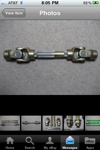

Does anybody know where to get axles like
these, on page 4 ?
Found a mini dune buggy frame, and
am building front and rear suspension, as well
as the complete rear axle setup, including the
centre section with the sprocket and disc brake,
similar to this.
Just trying to figure out which axles
to use, ...the PTO style, or can get CV style
out of a couple car wrecking yards cheap,
including the outer hubs and spindles.
There's an old VW at one yard right now
with a complete CV rear end.
