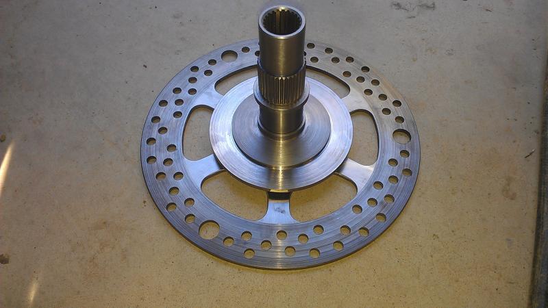

Built my hub today. Still have a bit more to do on it. I believe the rotor is for a buell 1125. It's the same outside diamete. The area of braking surface is slightly narrower than OEM pads. However I did find some pads with narrow material. This should fix this issue. It would only hang over a 1/16" on the inside anyway. So I could probably run regular pads and be fine.

That's beautiful work.
Question --- that was a hell of a lot of work but could you have just the stubs off the end of the stock shaft and run internal splines ?? Or were you trying to keep that old shaft ??
PostPosted: Sat Jul 18, 2015 10:06 pm
Posts: 642
The issue with that is the splines and threads for the brake rotor on the original shaft is too small. It would be paper thin. I believe that's what Farr had done here viewtopic.php?f=5&t=14515 if you look at his he had it chopped and EDM'd out. But since he now has no splines for a brake hub. He has to run outboard brakes. And it will offset the left side axle shaft inward about a inch. I wanted to retain the factory brake system. It's a lot of work but its my project not something I will be mass producing.
PostPosted: Sat Jul 18, 2015 10:17 pm
I see.
My formula race car had inboard brakes and it puts a hell of a lot of stress on the axel. In fact it would snap the axel bolts (mine were bolted not splined like yours will be). Outboard brakes would put less stress on those axels. Anyways you answered my question so thanks. Nice work.

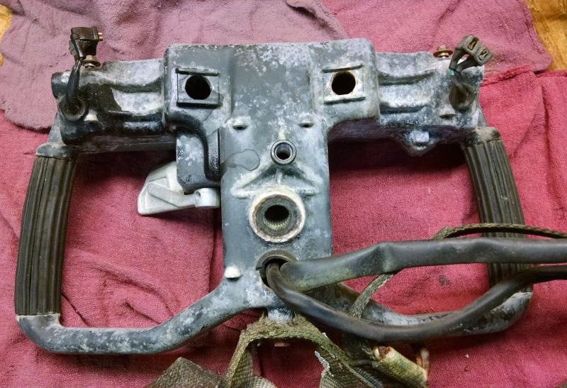

finally scored a pilot controller for this project. its pirty rough, but will clean up nicely. i got a good deal on it.

the pistons were seized. i drilled and tapped them 1/4-20 and extracted them with a piece of all thread, a washer and a nut. the bores look good. i ran a 1/2 ream down them just for clean up. the grips came off easily after soaking them in hot water. i found complete replacement sight glasses these are the no glue press fit oem type. i am missing the levers ill have to order a set of those.
