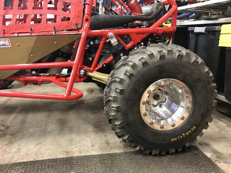

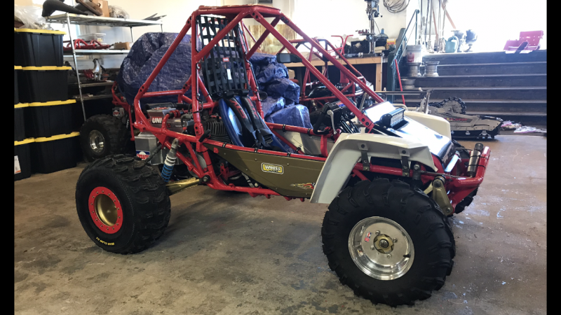

Haven’t posted on this in awhile. Got bead lock wheels installed on both of these machines now. After I blew out the rim on the #47 I wanted something stronger for both of them. On the #13 I am using the aftersh0ck mort0rsport conversion hubs to 4/110 w/ITP beadlock and on the #47 I am using an old set of OMF that I refurbished. I think I am going to powder coat the #13 to match, I love the look of the gold/red w/gold hardware. :-)

TerryH wrote:
Wow Curtis. Love the gold/red wheels.
Thanks Terry! :-) they do look pretty killer on there. I love the 80’s MX color schemes.
I would eventually like to do the front wheels as well. Might send them out to OMF to be converted like ZeroClient has done with his.
PostPosted: Mon Mar 16, 2020 10:16 am
I love bead locks. But I’ve been thinking of just adding a stiffing ring to mine. Would look similar

I like the bead locks. Can you provide a little more info since you changed hubs.
New rims, brand?
Bead lock kit from MFG?
Did you use stock rims?
I have never done them and would like to know more about them.
Thank you

Fully,
I agree that the rings will work just as good to strengthen the wheel. Many beadlocks have the ring on the inside of the wheel as well and makes them very strong.
adnoh,
I had purchased a set of aftermarket hubs second hand that changed my bolt pattern to 4/110. This allowed me to mount a pair of ITP beadlock wheels. The 4/110 bolt patter is more common than FL350 stock hub of 4x130. The sliver ones pictured above.
The red and gold ones pictured above are also aftermarket but they have the stock hub 4/130 bolt pattern.. They are made my a company call OMF. This is an older set that I also bought second hand, I refinished them myself. They do sell new beadlock wheels and can also convert Douglas wheels to a beadlock as a service.

on the subject of bead locks, I for one am in favor for a couple of reasons, strength, also you can run lower air pressure with less chance of blowing a bead or spinning a tire on the rim. with lower pressure you can adjust your traction but it is also good for some suspension travel, that said one time out at Dumont ripping around I did blow the bead off of the inside front tire, really hooking those turns :-)
On the topic subject, the ody is looking good!
