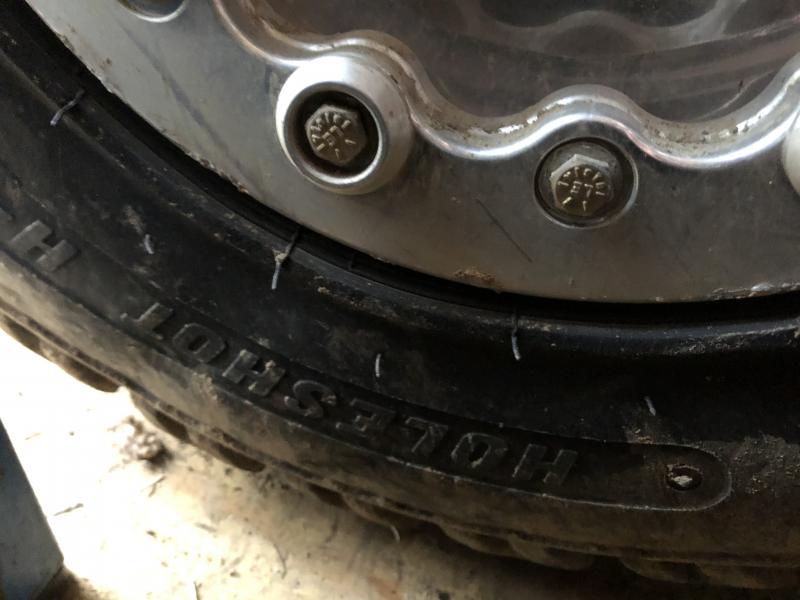

ITP holeshots
1.5 inches laidback at top

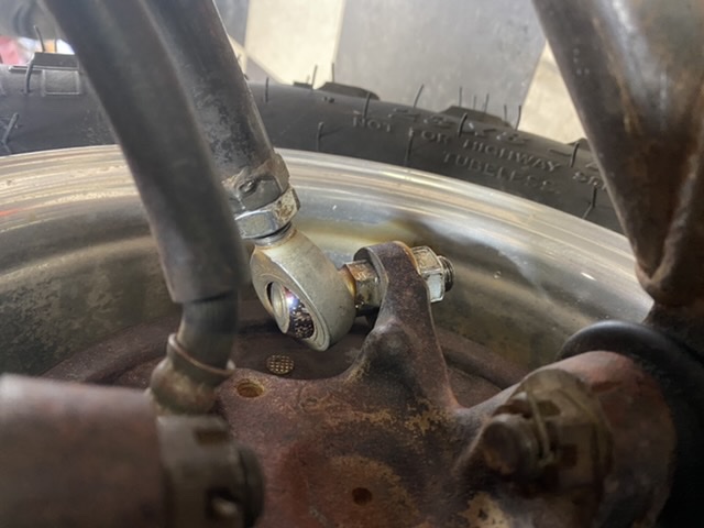

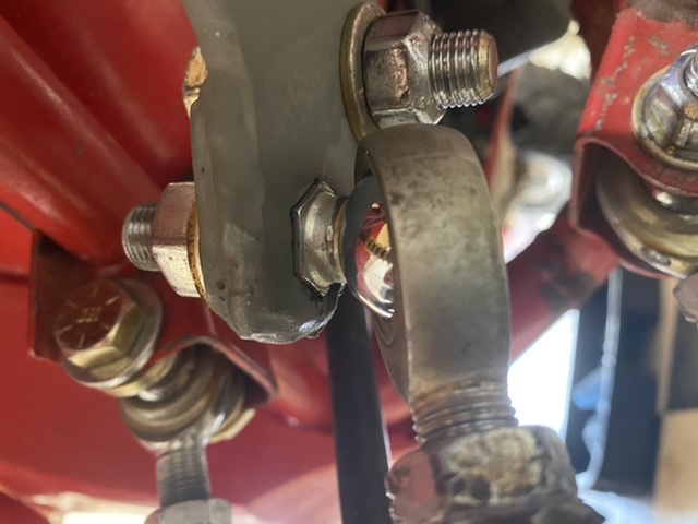

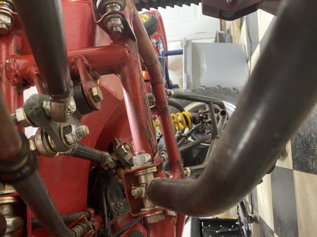

Today I fixed the bump steer as caused by moving the caster from about 14* down to about 8*. Changing the caster made the steering's outer tie-rod Heim joint rise up by about 1/5" at the hub, which caused an angle of tie rod change, which led to about 1.5" of BAD NEWS bump steer.
It wasn't hard to fix, took bit of time to figure out what I needed to do and then actually do the needful, but yet again needed WELDING (Making this LT kit not really a DIY thing for average Joe).
This kit's steering uses 4x steering linkages. The column is connected to 2x8" linkages which are then connected to rotating pivots just within the frame. Then custom tie-rods goes from this rotating pivot out to the hub. All linkages are adjustable for certain angles and toe, but I could not get the linkages to correct the bump steer issue from changing caster without some modification.
In order to correct the bump steer as caused by lifting the outer tie-rod joint heim, I had to lift the inner tie-rod by the same amount. This meant modifying the pivot's outer connection which connects to the Inner tie-rod heim.
I drilled/filed out a 17mm' hexagonal hole which allowed the heim joint to slide THROUGH the mount. I then welded 1/4" mild to the top side of the mount and drilled through that with a 1/2" hole. So now the inner tie-rod heim sits against the new 1/4" Mild part of the pivot which affectively raised the inner tie-rod 1/4". Best part? The bump steer is FIXED as best I can tell with my eyeballs.
DONE with the front of this FrankenThing2 for now.

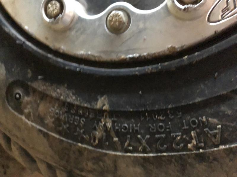

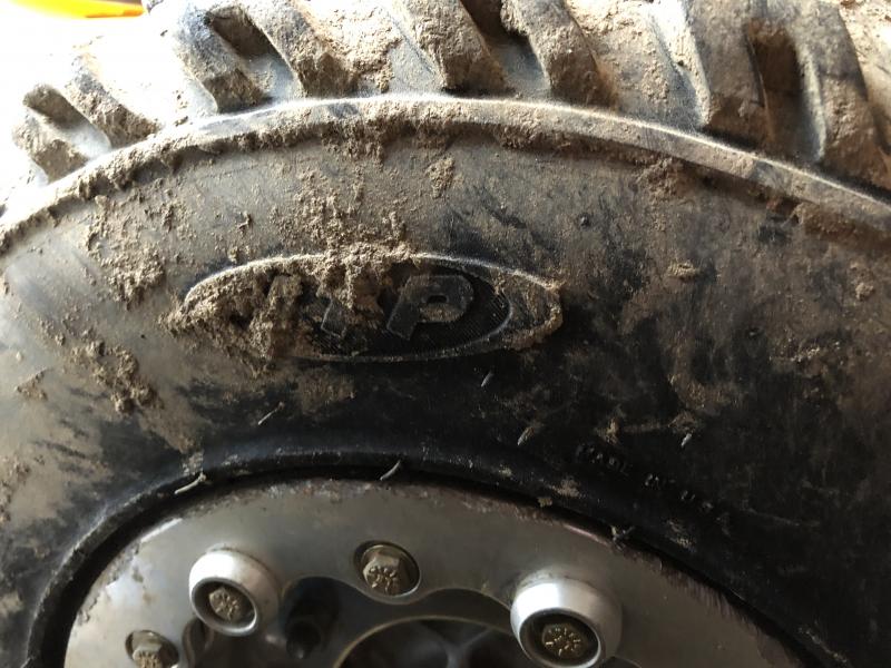

what are those spacers on your bead locks? I assume they are there so when you hit a rock it doesn't tear up the bolts so much?
You are correct sir.. out in October or rocktober forest as locals call it, the rings every other bolt helps save the heads.

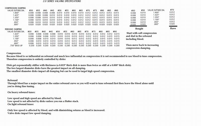

I called KarTech. They asked for some pictures - Txt'ed them. I heard a few guys laughing about the bleed holes lol. So I ordered some new factory pistons to start. As for bleed holes, well, I'm going to just keep to the one factory 0.070" hole for now, but I can always drill a few to speed things up if 30# shims are still not fast enough.
Valve shims in this things are both 70#, for compression and rebound. KarTech recommended I pick up 2 stacks of 30#, and 2 stacks of 50#, and start with the factory pistons with 50# shims. With the combination ordered I should be able to hit any position - 30,35,40,45,50,55,60,65,70#.

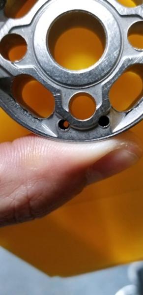

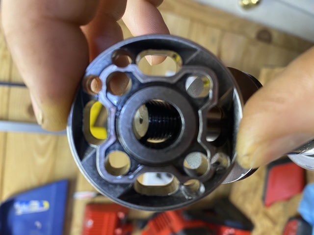

Here is the drilled out bypass holes in the fox 2.0 steel piston. 4x 3/16 holes around the edges.
The last picture is what is supposed to be like, with just one 0.070” hole.

you can tap those bypass holes and put some set screws in them, this way you can see what you might need to be at with the new pistons, be sure to lock tight or peen so they don't come out.

Do you have zero, one, two, or custom bypass holes in the valve piston?

I believe there are 2 bypass holes, all stock, I'm chicken to start drilling and then find I went too far
