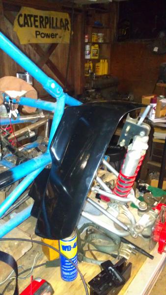

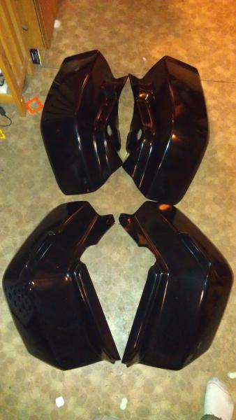

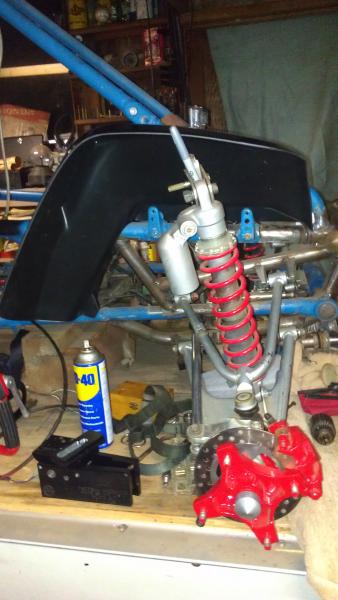

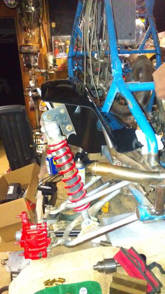

ive been wanting a set of fenders for this project. but unfortunatly the dark side has the market cornered on replacements. i was very hesitant to purchase these but i went ahead anyway. poor coustomer service and way overcharged for the shipping. but the fenders look great. i cant wait to get them mounted and hack big holes in them for the shocks. with a gloss black powdercoated frame to match and lots of shiny parts. i think itll look pirty damn good. these are just kinda proped up to get the idea.

Fenders look nice.
My brother and I crash one of the machines almost every time we took them out. Fenders were always busted. Had a complete set welded at a local plastic shop after a crash. Cost $500. Now we don't run them anymore as they got busted again first ride after that, FFFFFFFFFFFFFFFF.
Man you're sure putting a lot of effort into that machine.
Pic of finished product will be cool.
It might just be a trailer queen after all this.
PostPosted: Fri Jan 29, 2016 4:37 pm
Posts: 642
Well this machine has had busted up fenders since I got it in about 97. And every other 350 I've gotten has had busted up fenders also. My pilot was the first one I got with good fenders. But this was my first 350 and I've put a lot of time and money into this project so I might as well make it as nice as possible.

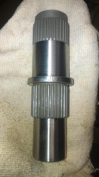

Finally got my shaft sent out for heat treatment. Now that its hard Im grinding the bearing surfaces to size. This is my first time using a tool post grinder. So we'll see how it comes out. So far so good

No longer am I a tool post grinder virgin! I had left them oversized about .020. Which proved to be too much to grind. Had to switch back to a carbide cutter and brought it within .004 then it did just fine. The finish could be a bit better but will work just fine for this application.

I ordered a stone facing bit. I'll build a tool and try that. I'm sure that has a lot to do with the finish. I just eyed it and got it close.

And there it is. Finally done and ready for installation!

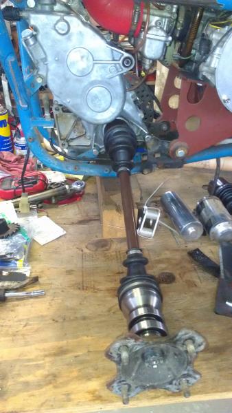

This gearbox still needs to be gone through. But I wanted to test fit the new shaft. Everything went together perfectly. The new rotor lines up properly with the caliper. No clearance issues with the cv cups.

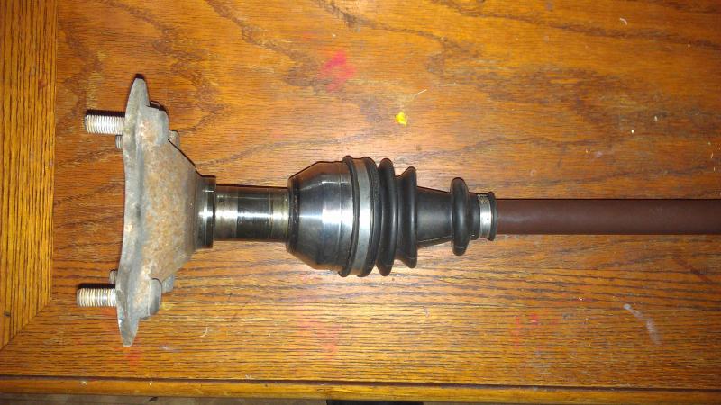

These axles are longer then the stock axles. I believe the axle that D$ and methodical have been messing with. Will also fit this new output shaft. These use a 22 spline inner. So there may be several axle choices that can be used with this.

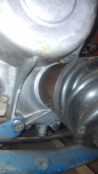

Looks to have good clearance
