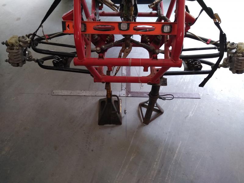

Sound close enough. By setting the front lower arms flat you can see any change from what you have static setting there. What your looking for is the change side to side. Your at 1/8 long on ? Side.
Here's a pic to share

If I read right. 8 degrees caster and zero camber.
Tend to agree with you. Since your running pilot hubs may not be much help other then if memory serves they are set zero on caster. I'll have to check.
I use trx 05 so I'm set at 4 degree and 1/4 camber. I think I would reduce caster and go 1/4 to 1/2 negative camber. Only reduce caster to a point not to wander in woops. I say take as much out you can with upsetting it this the rough stuff. With you set up the rakes different to which impacts the caster camber setting. Basically front sitting up higher changing lower arm pivot angles. Check it compared to you other pilot maybe be an ah ha moment.
This is one reason I opted for the kpi of the 05 trx. Other have had success with 06.
Hope this helps if not be sure to give thumbs down.
