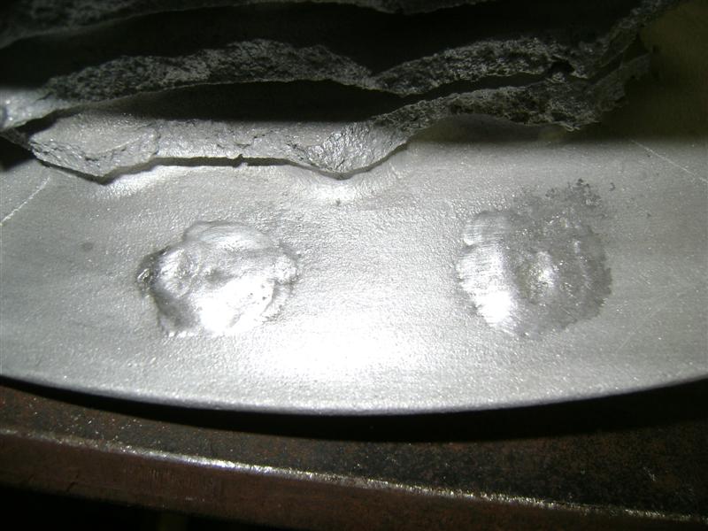

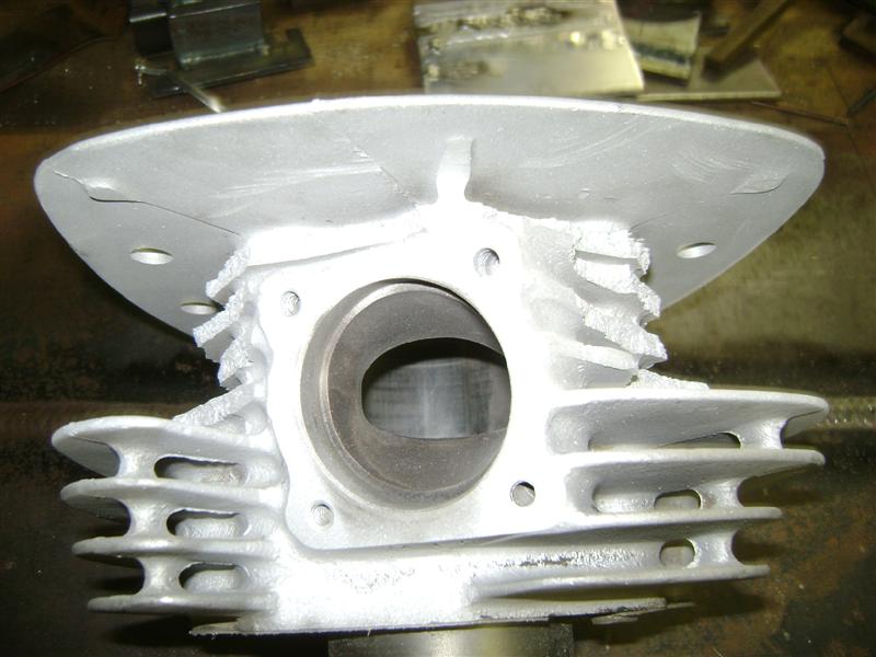

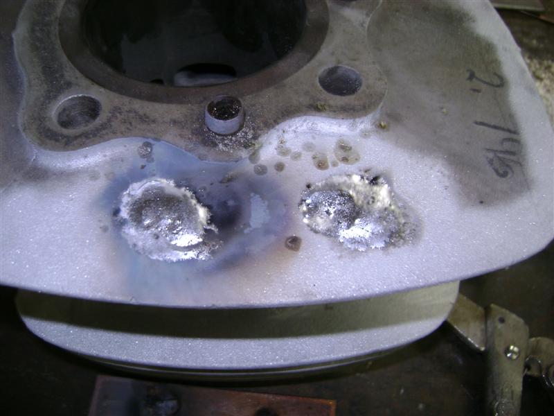

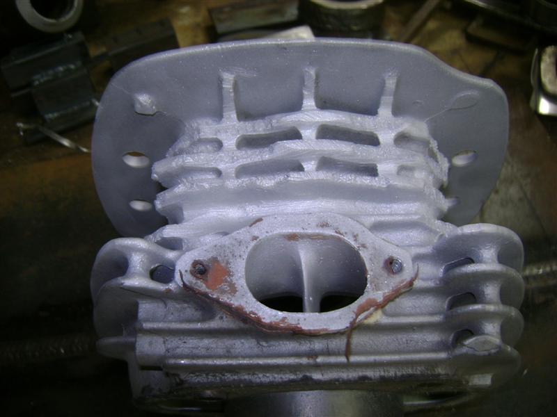

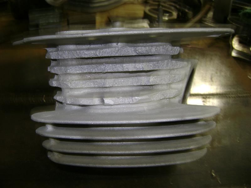

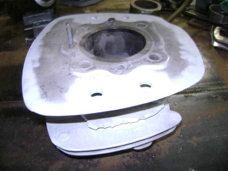

Removed fins on the 250 cylinder and sand blasted the weld affected areas.
Welded up the holes on the top where the rubber dampeners were.

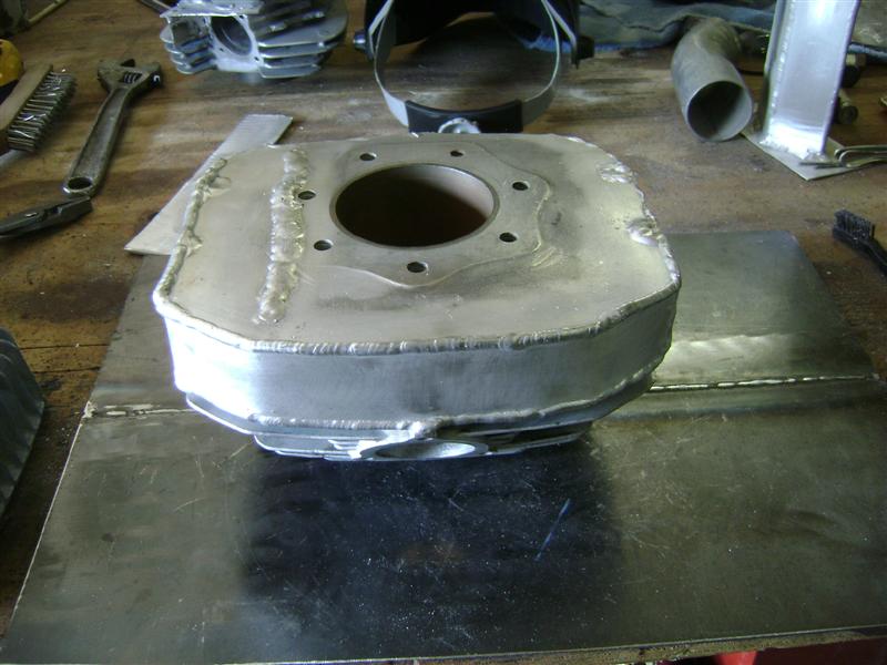

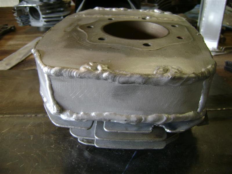

PostPosted: Wed Aug 15, 2012 5:55 pm

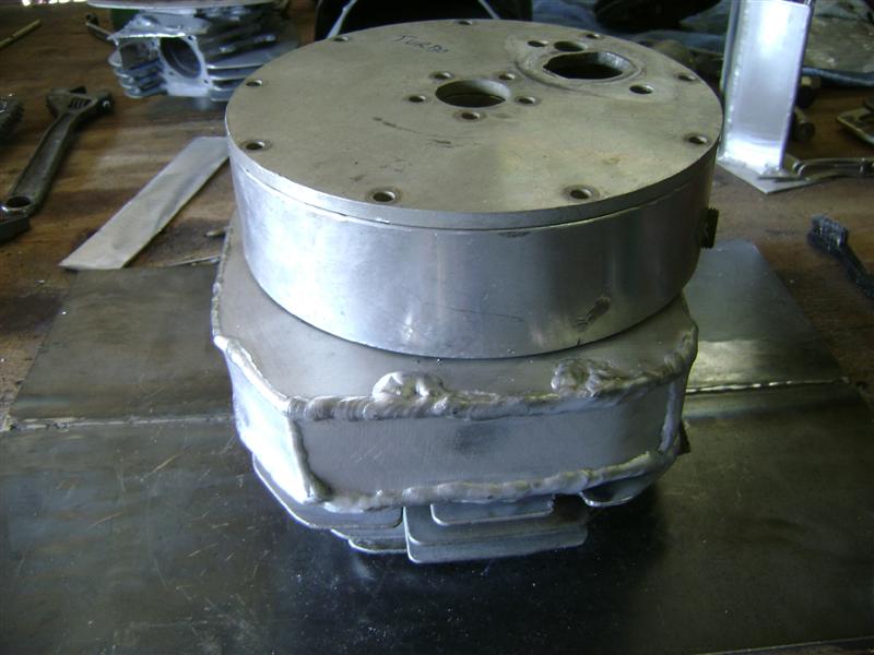

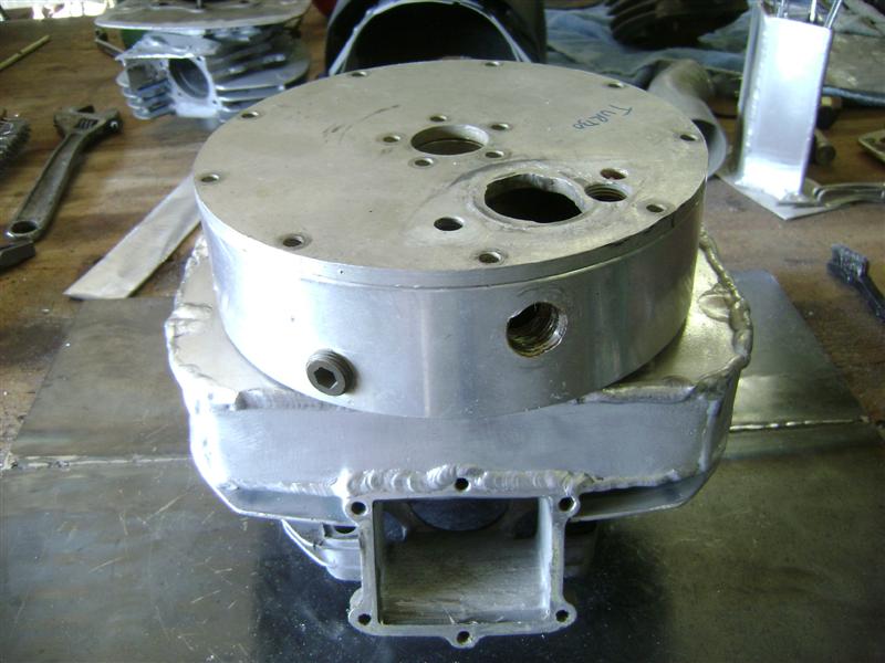

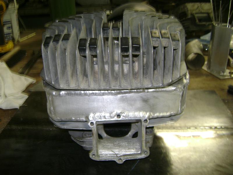

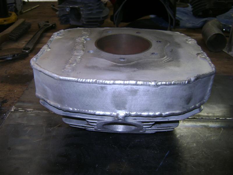

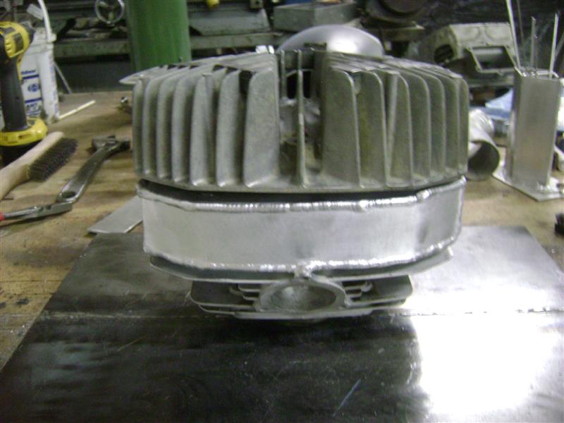

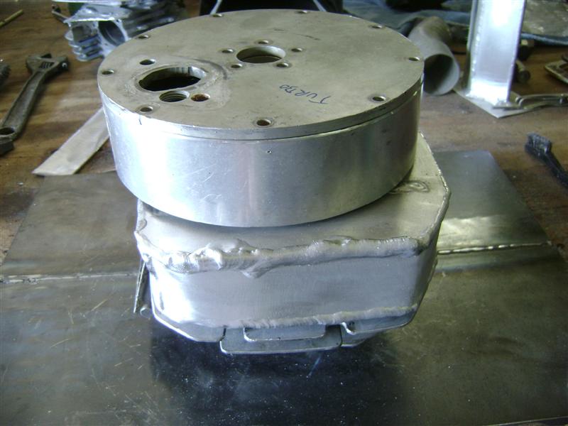

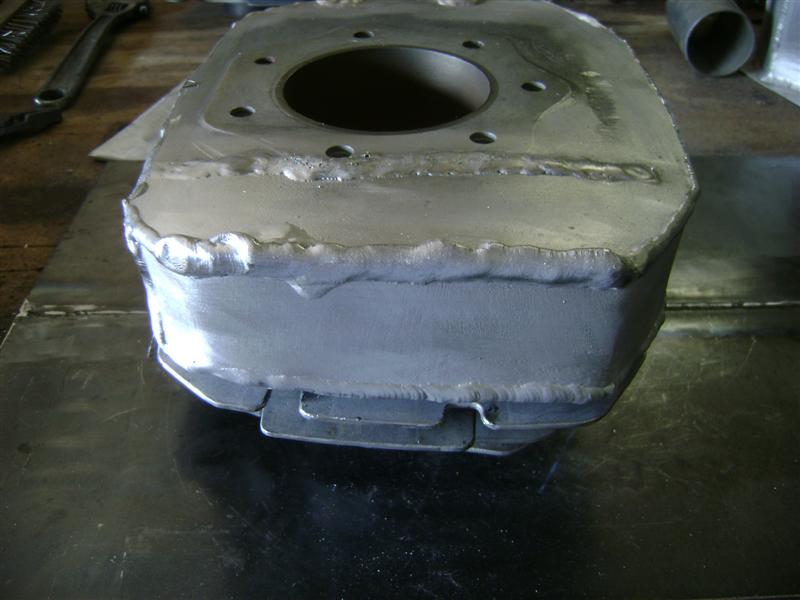

I cut fit and tacked up all the parts needed to make the water jacket then had the son weld it up for me.

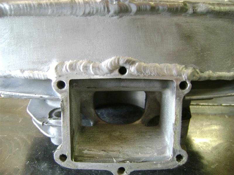

PostPosted: Wed Aug 15, 2012 5:58 pm
Without the head, still need to machine that crack I welded up.

Need to do a little machine work here for the gasket surface

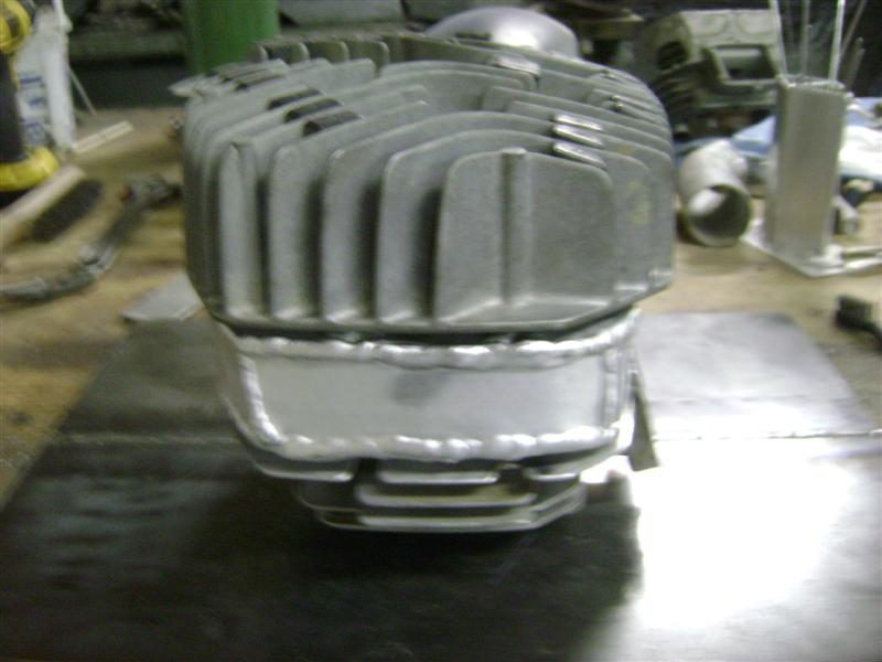

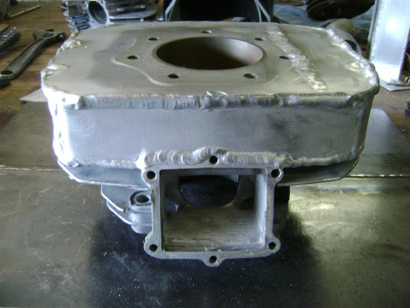

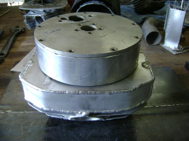

PostPosted: Wed Aug 15, 2012 6:00 pm
If you were using the round style head it would look like this installed, pretty much like you would think a stock cylinder without some of the cooling fins showing lol

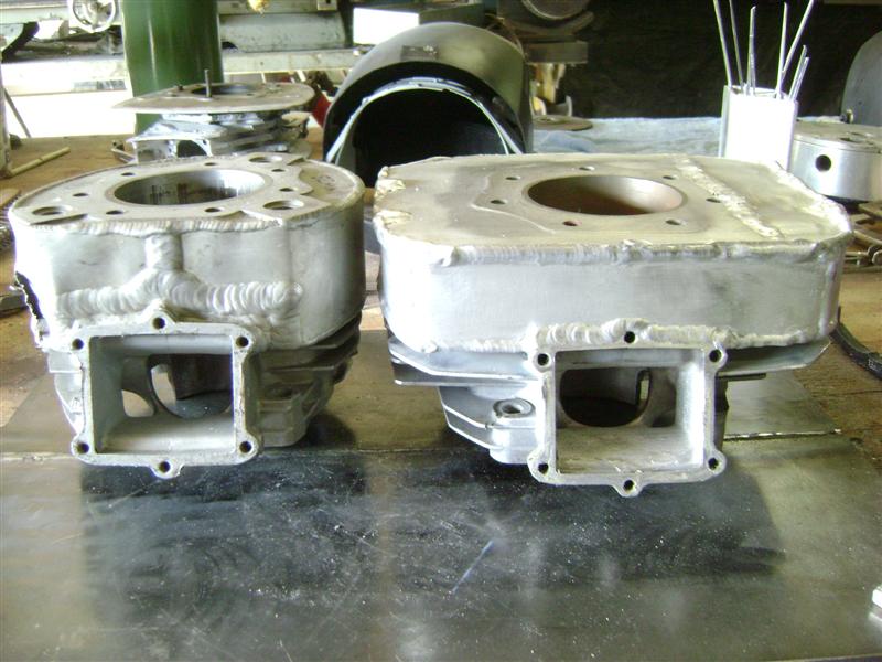

PostPosted: Wed Aug 15, 2012 6:02 pm
Next to TurboTexas LC cylinder

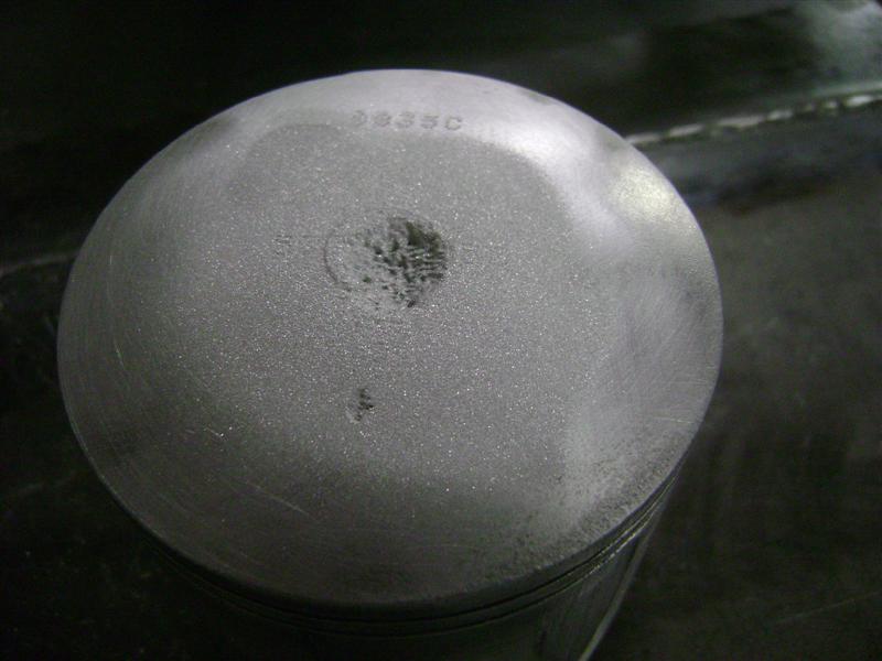

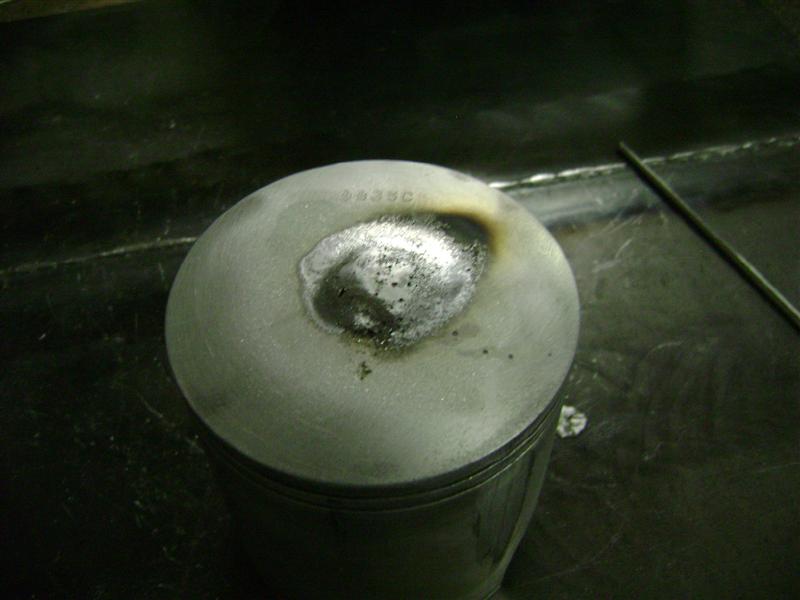

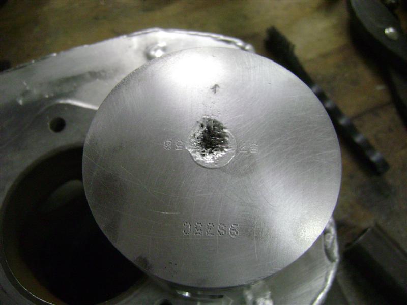

Since I am setup to weld aluminum why not refurbish some of them damaged pistons like this one out of Odykids Pilot Engine that was run quite a while in this current condition but the piston is still usable.
Clean off the carbon
Sand blast the carbon out of the crater.
Weld it up all that is left is to machine the dome back down flush.
Just kidding the piston is a paper weight just wanted to see how it would weld, took all of 185 amps for a long while to get it hot enough to take filler rod.

What do you thing would happen if you tried a piston like that? Would the filler melt out? I'm trying to understand why it wouldn't work. Or is just not worth risking? Might be something to experiment with in something that's cheap "er" to rebuild.
PostPosted: Thu Aug 16, 2012 12:04 am
I would venture to guess that welding on the top of the piston will change the molecular structure of the piston itself and that the welding rod material is not the same makeup as the piston itself. This would probably make the piston too soft on the top of the piston and it might shatter or melt. It might make the piston too brittle.
But I'm not a metallurgist so this is an educated guess. Or maybe just a WAG (wild ass guess)!

May guess would be that the water flow would be more restricted and not cool as quick. Cutting the fins off allows more flow to get the heat away from the head.

You can do it that way the way I done it takes longer but with the fins out of the way you don't have to worry about circulation and don't need a water pump to force the water around, still more surface area is left since I cant remove 100% of the fins than inside a regular liquid cooled cylinder :-)
PostPosted: Fri Nov 16, 2012 11:38 am
Another issue you would run into would be the path of the water.
Water is going to take the least path of resistance. If you were to leave the fins in place you will wind up having pockets inside the cylinder jacket that will flow water quickly and other areas where the water will flow slowly or not at all. Hot and cold spots will form and uneven cylinder cooling would be the end result.
