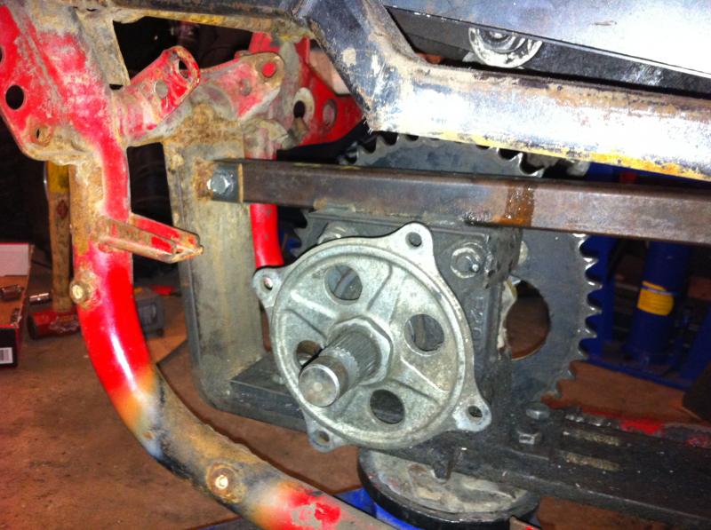

Are they an left or right chain on the ninja?
PostPosted: Fri Jan 25, 2013 8:40 am
Joined: Mon Jul 09, 2012 1:57 am
Posts: 47
Location: Corona,CA
The ninja is left chain but the plan is to run a jackshaft, I don't want a huge sprocket on the rear axle do to space. I got a sprocket that's about as big as the disc brake but to get the gearing I want I need the jackshaft, that's why sprockets on the right on the axle.
Ok
I was going to sujest flipping the brake and every thing around to where the sprocket is on the left
Fyi shorter chains will wear out faster than a long one
Longer=cooler for chains

PostPosted: Mon Jan 28, 2013 7:36 am
May I suggest changing your sprocket? In the pic looks to be just past it's use by date.
