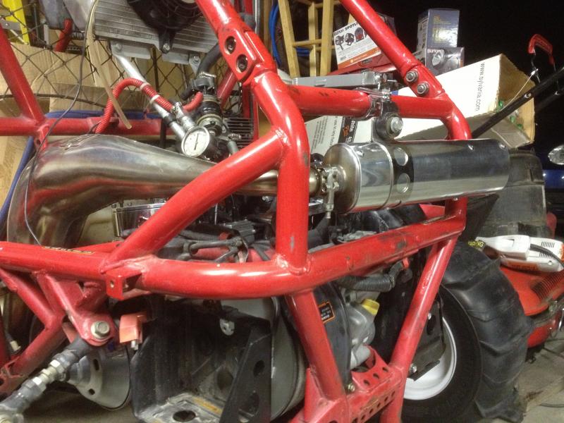

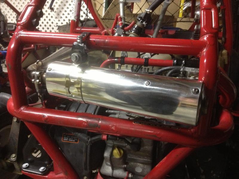

Well, we got the exhaust all mounted and we did a little polishing, for all you fans that just loved the "bling"look (you know who you are) haha. And if it does break down(which I doubt it will) at least it will look bad ass getting towed back to camp.. Tomarrow I got to pick up some hose and fittings and we can hook up the radiator. Get it heat cycled, then start breaking her in..

PostPosted: Fri Mar 29, 2013 11:45 am
that's the point if you put 1/2 as much effort-focus into the mechanical side, thinking then doing you will never break down, that's where the bling homo comes in over the years we have seen guys focus on the bling, chrome, polished plastics and everything else then break down, that's where stoneman came up with the "sure looks pretty setting their" and when he says it you look the machine over and can see the owner wasted all his time and money on bling so their is sets all pretty and broke haha. My favorite is all the morons that buy the bling aluminum rims then discover they bend easier, blow the tire off the beads easier, have the wrong offset so handle worse than stock but they look good long the trail bent or with a blown bead, wish I had all the time back I lost waiting on these morons trying to fix a tire on them bling after market rims, at least we kept ourselves busy laughing at the stupidity of wasting money to make it less reliable.
SO did you spend as much time prepping your piston so it will last longer and reduce chances of cracking and the port bevels putting the proper bevel and radius so they are not apt to scrape off the oil? For the price of a cylinder gasket and a circlip (less than 15 bux total) you can do these internal blings you just cant see them once done.
Did you remove the manufacture flaws inside the pipe and silencer so it will properly flow once installed, did you even bother to look or were you focused on the chrome and bling LMAO not to worry the group will wait for you to catch up.
Do you even have a clue what I am talking about I can provide links and pics?
Your machine do what you want just trying to help my suggestions make your machine run better, last longer, run faster....
Another example how many people bought these installed then never bleed the brakes when they installed them? be honest even if its just with yourselves how many even thought to bleed the brakes whilst installing, how many were under the spell of bling....
